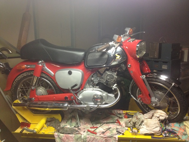

Hey Benly Folks,
Been a bit quite here on the forum.....haven't known what to do with my spare time... :rolleyes:
Everyone else must be hard at work, madly restoring their own piece of machinery ;)
Here's what I've been up to (don't mind the mess...I'm used to it!).
Started up for the first time on the weekend....just the chain guard to go and then onto the road we go.... :D :D
For a bit of the history of this build...
http://s289.photobucket.com/user/vegeke ... enly%20C92
Kev. :)
PS....I haven't got the Sam Green Racing sign-writing done yet! ;)

That looks really nice and I like the red!
VegeKev
Post by VegeKev »
Thanks C66....
The red is an experiment using industrial enamel (I've only used acrylic in the past).
When looking around I tried to find a red that matched the photos of the original bikes and decided on this one.
If anyones interested its International Harvester red, and the silver is the same as used on Massey Ferguson wheels....so this build should have a real country feel to it ;)
Kev. :)

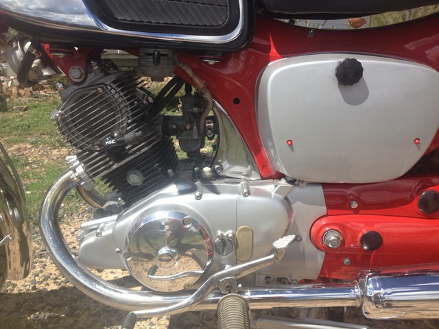

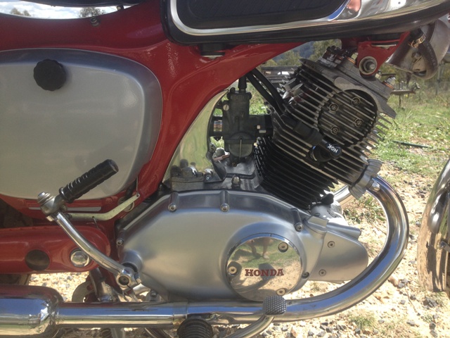

VegeKev
Post by VegeKev »
I wish it was a CB92 engine :rolleyes: , but no... But it's as close as I could make it ;) ....
It has genuine CB92 high comp pistons (thanks Sam :) ), a CA95 cam and transmission. Also a CA95 carb re-jetted to CB92 specs.
Really happy with how it turned out, but not happy with the new seat...too bulbous! Thinking of getting a copy of the CB92 racing seat.....
Hey Larz....I like the drag bars too, though the CB has a higher bottom portion of the handle bar mount which would help with fuel tank clearance....it's very close!
Kev :)

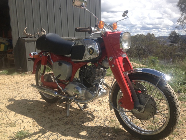

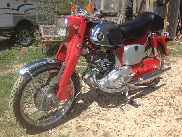

Finally got her out of the shed and got some better photos.....then went for a ride :D
:) :) :) :) :) :cool:

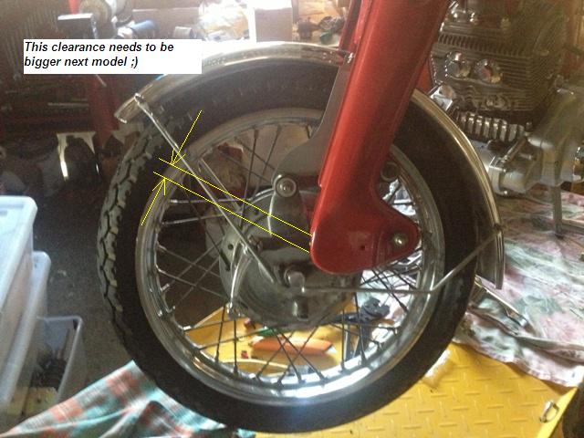

Interested to see how you have done the front mudguard. I have most of a spare C95 . Not enough to build an original bike but I fancy doing something a little different with it. I like the idea of flat bars and a chrome mudguard. How did your ride go. I've got a bmw r1200s but still love riding the c95.
VegeKev
Post by VegeKev »
Hey Nige,
Have a look here, better photos and more descriptive...
http://www.fourwheelforum.com/showpost. ... stcount=26
The guard appears to have worked nicely. Spokes was wondering if the wheel would hit when bump running....so far so good, even when navigating cattle grids! (as I live on a dirt road in cattle country ;) ) The clearance between the top of the new mount near the axle and the bottom of the fork is really the only place where it looks too close.....see attached.
Ride went really well. Everything worked as it should and nothing fell off!.....bit of work to do with the jetting as I think it was leaning off above half throttle, probably due to me being at 1000m asl :rolleyes:
Kev. :)
