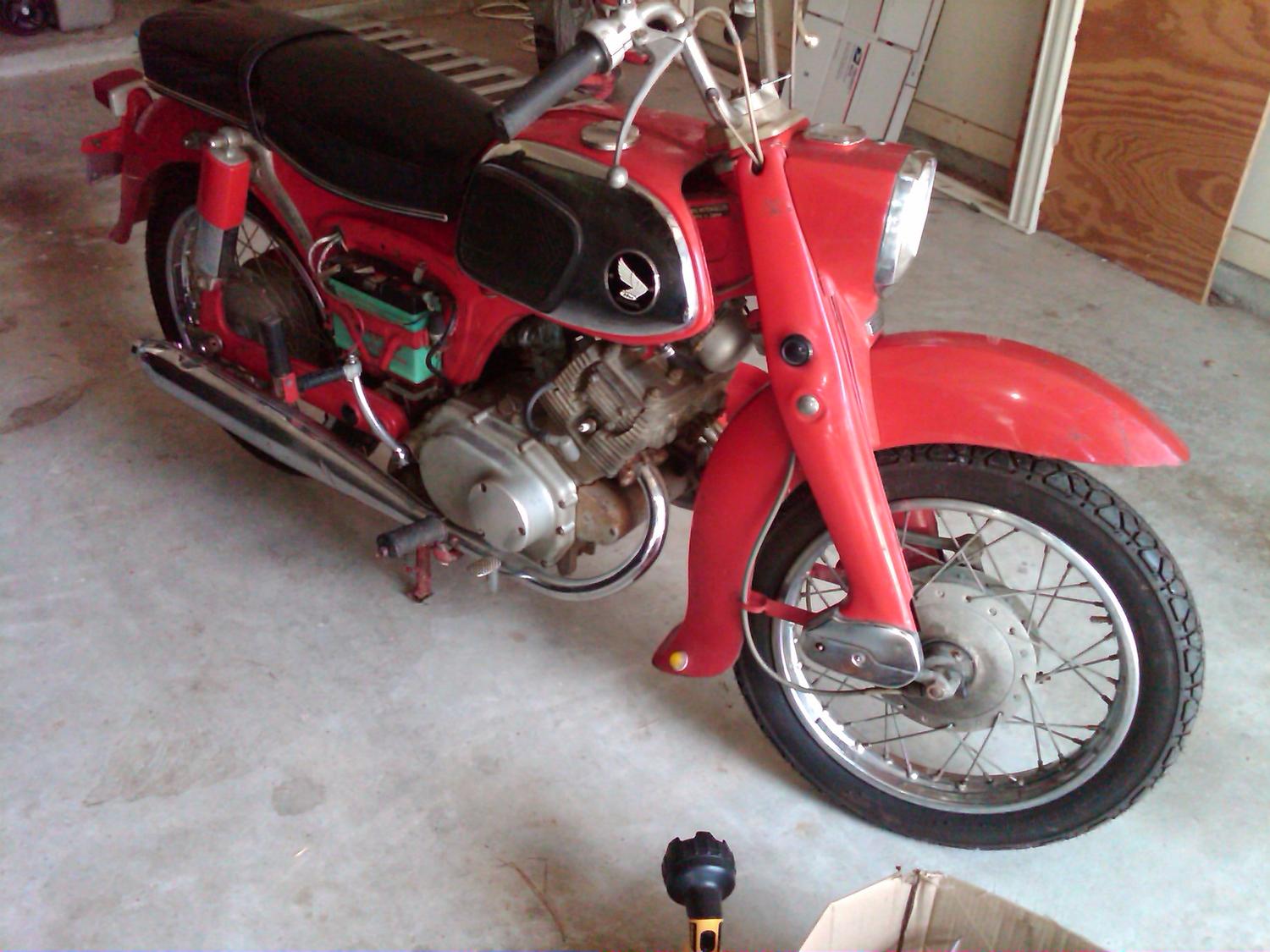

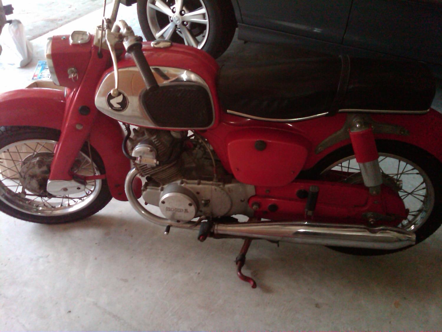

So I got it tonight! I don't know the year, but let's go with 1969 CA160! The guy had the original owners manual and a Clymer's manual too. He had a bunch of spare parts, plugs, and a coil All for $650.
Anyhow, I have a 15 month old son, so time this weekend to tinker will be limited-not to mention it's 100 degrees every day.
My question to everyone: how should I go about seeing if it will start? I need to buy a battery (spare was/is dead/old), but will it die if I don't have this project wrapped up in six months? I need to clean out the tank and clean out the carbs then throw some oil in the SP holes, but then what?
I'm new to this whole "bringing it back from the dead" scene. How awesome though. My camera is broken, but I'll upload pictures soon.
Thoughts?
Thoughts?

Everything seems to be in place, but I have two questions as of now.
1) What size spark plug wrench should I use? I have two, but neither work. I think it's 18mm, but I have no idea. I'll search the CA95 forum for this in the meantime.
2) Gas tank: there are three fuel "outlets". Petcock, and two on either side at the front. The previous owner used the front two, teed them together before an inline fuel filter, then ran it to the carb. The petcock had no hose running from it. I assume the original configuration ran from the petcock to the carb, but how were the two in the front originally configured?
Thanks in advance. I apologize for the elementary nature of my question, but I hope this to be a learning experience.
The spark plug is 18mm.
The two front "outlets" are to be connected to each other. Only the petcock outlet is to be connected to the carb. I buy my fuel line and clamps from my local RC Hobby store, nice fuel resistant tubing. If you want to install an in-line filter, use one made for the Briggs & Straton engine from your local big box or hardware store.
