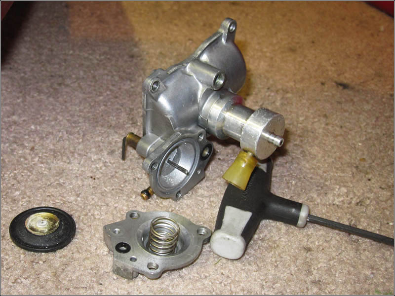

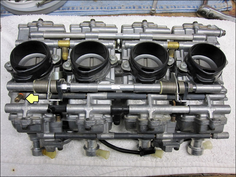

I'm going to be a carb pro by the time this bike is running in top shape again. I never thought it would be this much work to recondition these Keihin CR carbs. And I have another issue that I thought was kind of odd. This brass nipple is leaking fuel from it when I pull the throttle quickly to activate the accelerator pumps. It was really leaking down on the engine so I put a long clear fuel hose on it to route the fuel to the side of the bike while I worked on it.

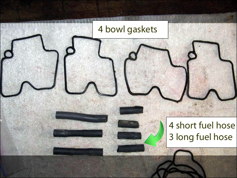

Here are some more pictures for reference. There aren't hardly ANY good pics of these Keihin CR carbs on the internets so here you all go! I have many more pictures coming up of the intense cleaning that these went through. Lots of work.

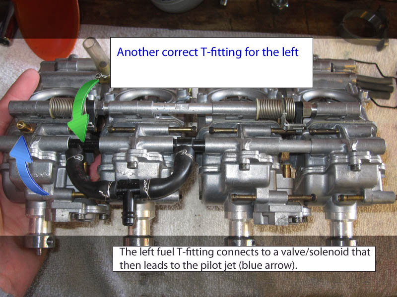

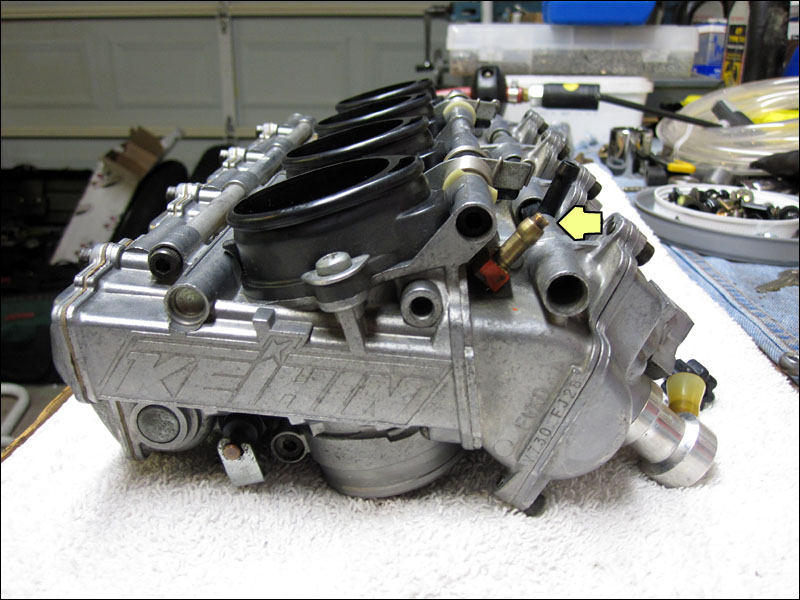

Not exactly sure about how that little guy on the left works so I just threw on a clear hose for now so I don't light up on fire from fuel lingering around the engine.

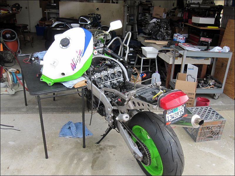

Too lazy to make an IV bottle for fuel so I just set the tank to the left on a folding table to start it up.

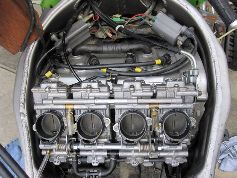

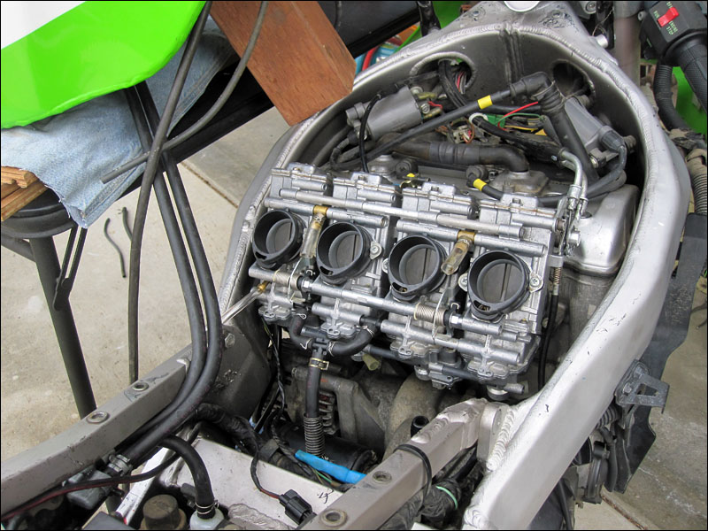

Ok I got the bike running and it runs much better with the airbox on by the way. It just doesn't have much throttle response at all and the rpms go up and down when you use the choke but nothing is very consistent at all. These carbs need to be tuned by someone with some experience so unless some magic book falls into my hands about how to tune these things I'm going to be looking for someone to take it to in order to make it run nice and smooth.
Start with vacuum leaks. Spray carb cleaner all around and under the carbs. RPM rise means leaks. Do you have the tubes under the carbs plugged? Are the plugs tight?
Next, have you sync'd the carbs after the cleaning?
Worst case, take the bike up to Jojo at Superbike in San Jose and have his set it right. Long trip, but worth it. He does know them well. Then you can come by my shop and see the stupid number of ZX7s that I have now.
I'll be addressing all these issues during the next round of ZX7R work. I'll get some pictures and such. The airbox is the biggest pain on these bikes... you know why already but I'll get pictures to illustrate. Any way that the newer airboxes will fit on the older ZX-7R so that you can top load the air filter into it instead of having to take the whole thing out and splitting it in half? There is no way I could get a proper seal on the carb inlets with the airbox assembled - those two screws on the bottom side of the box/carb rubber boot area are a big problem. If I assemble the whole thing and heat up the carb inlet rubber the chances of it getting a complete seal around the top and bottom of each carb is not good. I heated it up next to my heater and if I put a lot of grease on it then it might slip on but the rubber is old and super hard even at room temp.

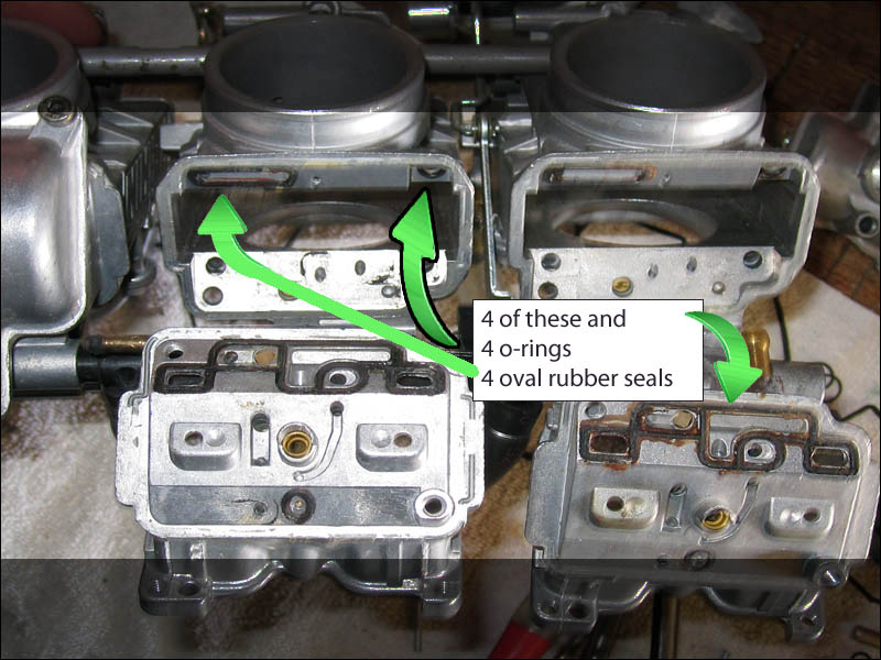

Well I got a little list of rubber seals that these carbs need. I'm waiting on a quote for some of the complicated looking seals. I might just have to use The Right Stuff sealer on these and put them back together very carefully.

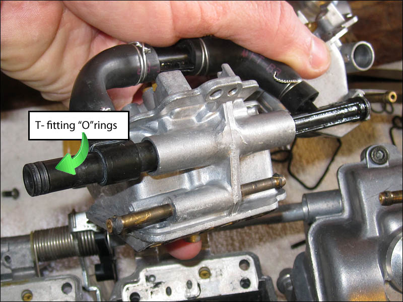

Someone else had tried to repair these carbs by using a t-fitting that wasn't meant for these carbs. It might have worked for the short term but it occasionally lets fuel slip by (which = fire inevitably).
Here is another tricky part. They don't sell these tubes anymore, discontinued. I'll probably just use some fuel line for power equipment in place of the factory tubes. Small machine fuel line should work fine while staying nice and tight.
The parts that I have to contact a specialty supplier for are the 2 accelerator pump diaphragms and o-rings. If I can just at least get the diaphrams I would be happy. If worse comes to worse I can try and recondition them by softening them up a little bit with some grease. They look slightly deformed for the time being and I would hate to have to try and re-use them.

Smithers wrote:I'm going to be a carb pro by the time this bike is running in top shape again. I never thought it would be this much work to recondition these Keihin CR carbs. And I have another issue that I thought was kind of odd. This brass nipple is leaking fuel from it when I pull the throttle quickly to activate the accelerator pumps. It was really leaking down on the engine so I put a long clear fuel hose on it to route the fuel to the side of the bike while I worked on it.
I finally got an answer on that nipple. It is for the fuel enrichment circuit. Muzzy recommends to plug it and remove the TPS on the top of the carbs when adding jet kits. That is what I am doing to mine. I called Sudco and they did not even know what it was since it is only on stock carbs.
