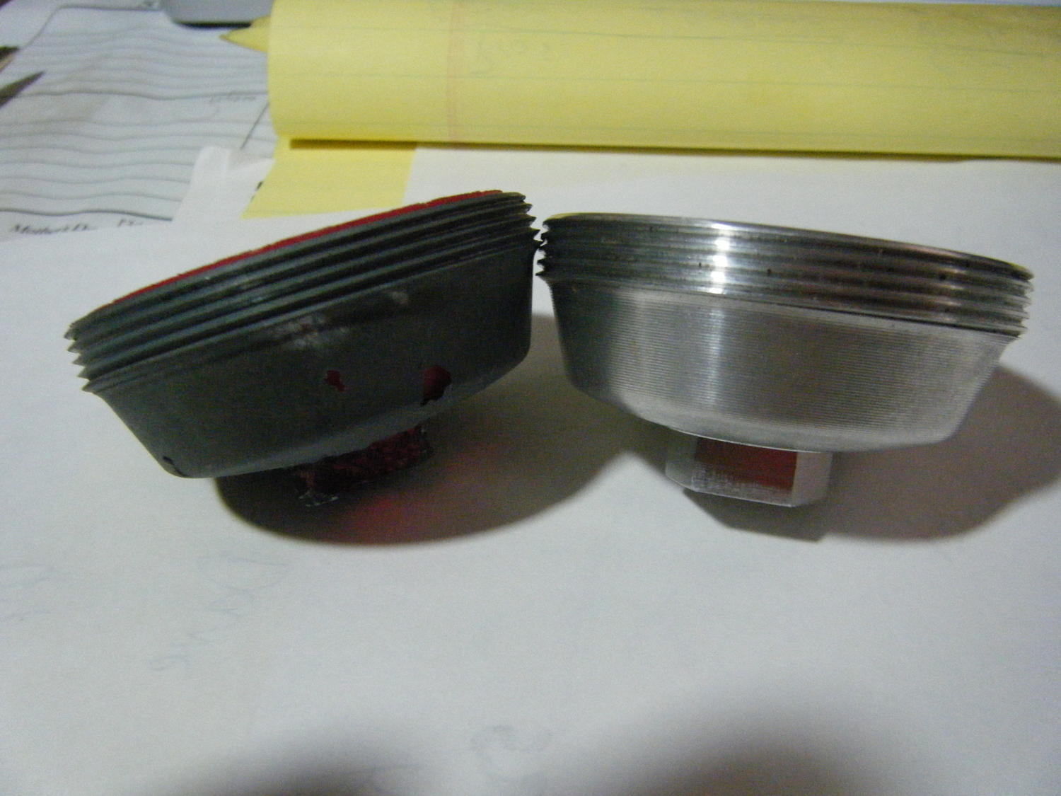

I was getting my 1966 CA160 ready for Father's Day weekend and since this is a new to me bike I hadn't put fuel in the tank yet. There has been some discussion regarding JB Weld and the sediment bowl or other parts.The bowl on this petcock had been repaired in such a manner.On this bowl there was a hole in the 'bolt' area. The bowl I used on the installation was a nearly perfect bowl until I glass beaded it to clean it. It now looks more like a strainer (you'll see in the final pic).
What to do until somebody starts cranking these puppies out of billet?

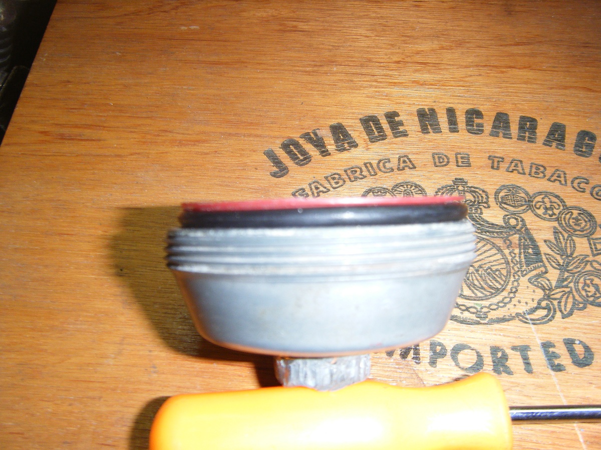

My tool box never ceases to amaze me when it pukes up some little pearl I can use, like it did today. I managed to find a simple packing plug used for different sized hoses. Most of you may be familiar with CAPLUGS. I also had an Oring assortment and found one to fit as in the picture. Now the idea here is not that the oring will actually seal anything as it is being used but rather acts as a support or backing ring for the lip of the red caplug. It is the lip of the plug that will seal against the wide flat oring used as the bowl seal.
I did work the o ring down between the bowl and the plug with a small screwdriver and inserted the plug into the bowl. The depth of the caplug makes it stand just a little proud of the bowl edge and I felt this would help to push up against the bowl gasket. (Of course use all new gaskets when you can- I did rebuild the rest of the petcock with stuff I had.)
I chose to use a bit of RTV on the gasket between the petcock and tank just to fill small irregularities. Installed the petcock to the tank and let cure for about 30 minutes.
I installed the bowl to the petcock after mounting the petcock. As you can see in the pictures the bowl IS shot (a different bowl than in JB weld pics). You can also see the cup through the holes and this is after sitting with gasoline on it for a couple of hours.
Might gas eat the plastic cup? We're gonna see. But for now it holds up.

Day two: Two mile ride and still no leaks.
Five days still working...
O wow that's interesting. I think it's the type of plastic that is important. There are a lot of different blends of plastic so if that little red bowl is holding up so far then you're probably good to go until the end of time. :) Nice cigar box.
Next thing if that didn't hold would be to coat the inside of the bowl with JB Weld and coat the outside of the bowl with wax paper or something to keep it from oozing out and getting over everything.
Down range a few weeks and still holding....
OK, we are nearly to October and the little fix still holds gas but...
