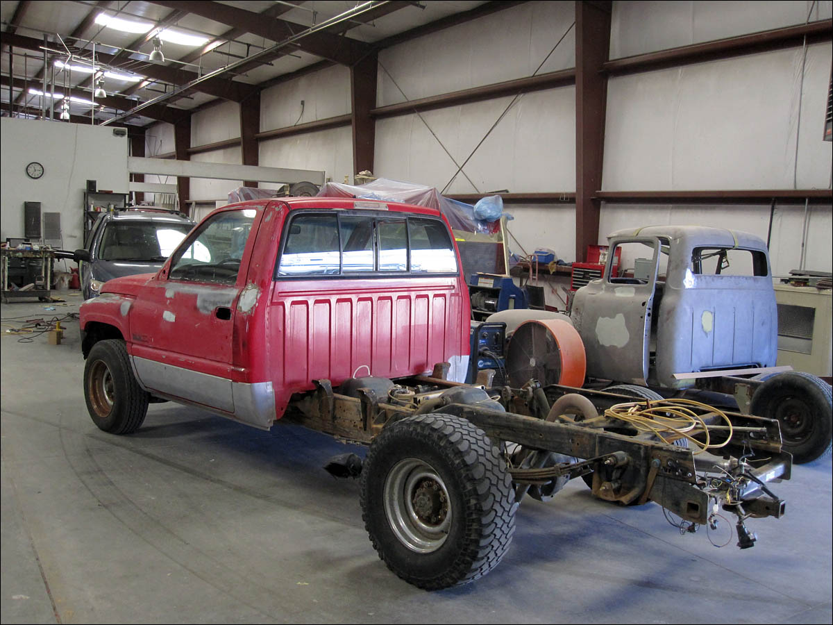

Heh that's the same color I'm painting my new (old) Dodge diesel truck! Well mines more of a blood metallic color but we'll see how they spray.
