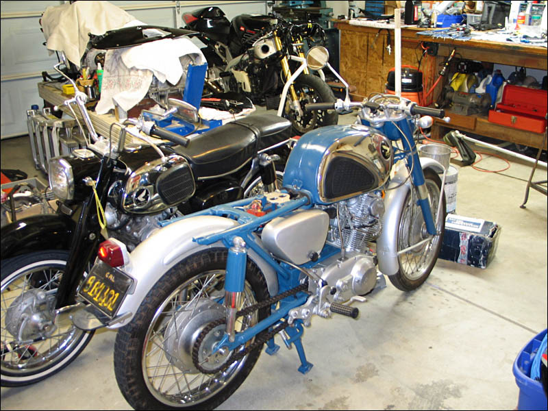

Here is how it sits right now. I've been so damn busy on other projects I haven't had time to play with it lately.
