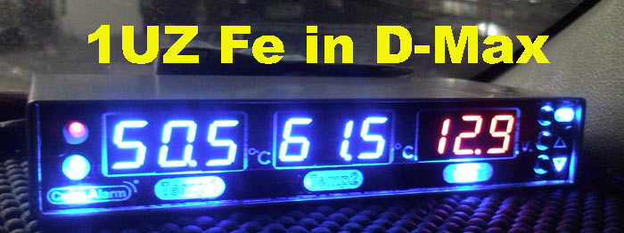

-- Final image. "The measurement of heat" Temple of heat directly from the radiator.
And measure the heat from direct.
-- Measure and charge back the power of Matrix Partners.

Heat really isn't an issue. Just hook it up and run it. As long as you hook up some decent size radiator you won't have a problem. I don't even run the fan on mine. I will use a switch when I go off-road and in the sand.
Just use your Toyota radiator and you will not have a problem.

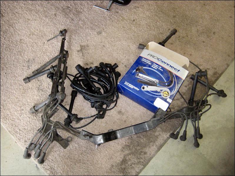

And use the spark plugs and spark plug wires that came with the engine.
I returned the new spark plug wires to the store. I didn't use them. They were too short. The stock Lexus wires are just fine.

>> Spark plug cable and set to use the Lexus for ??
- Set price and about how much
- I want to replace all 10 lines / interference advice.
-- Spark plug cable, the picture attached, or not available / price / set much.
Thank you very much.
