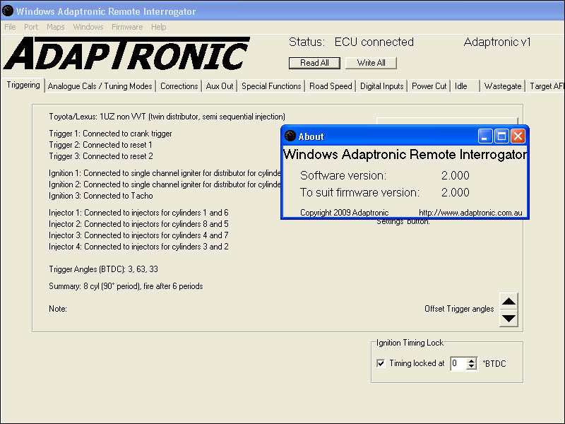

You will want to confirm the firmware on your e420c ECU is version 2 or v2.000. This is crucial as they don't release new software and new firmware for no good reason. Just select the "Help" menu and "About" to check both your software and firmware.

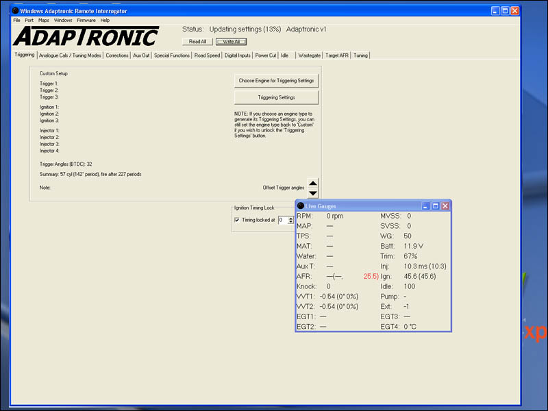

This just might be what your screen may look like when you start up your WARI Adaptronic Software for the first time. Already it looks confusing to you of course! There are already a couple things wrong here in this picture. Well there's nothing WRONG but just some things that need attention as your e420c is far from being operational.
Did you read your installation manual all the way through?
If you did then you should know from your newly acquired knowledge that looking at this screen there are some issues to resolve.
So what's wrong with the above screenshot? #1 I am missing some values that should be registereing in the "Live Gauges" window. You should be able to see some temperatures and some additional numbers. I am not seeing this data simply because only the power plug is connected to the e420c! I hadn't plugged in any other plugs yet at this point.
The next thing missing are values being displayed on the left column of trigger, ignition and injector info. This is one thing that took me a little while to figure out. When you power on the ECU there is NO data in the computer at all - no surprise here. But I then loaded a standard configuration map for the 1UZ engine. This uploads some fuel and ignition settings but that is about all... the rest is up to the user. You know what that means... get out the installation manual and read some more! It's doesn't really do a good job at explaining just what you NEED to do in order to get your engine running. I couldn't figure out exactly which setting needed attention in order to get my engine to run. I loaded some 1UZ data and then set the TPS sensor. I then tried to turn over the engine and of course nothing happened. I know I might be in a hurry but come on! Something needs to happen. Well it did.... I had a fuel leak in the pulsation dampener no the fuel rail that I had to take care of. Yeah, I don't need fuel leaking out creating a fire hazard thank you very much. :P

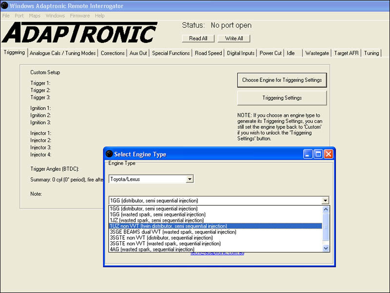

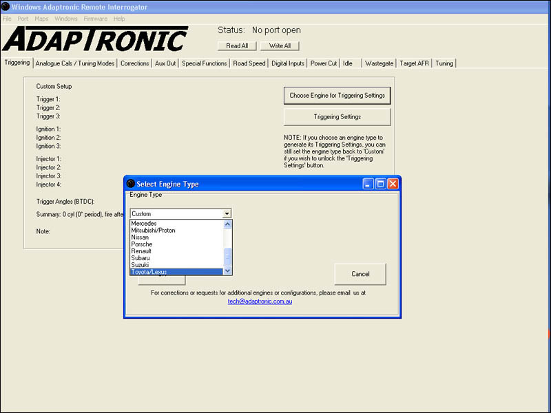

So what to do now? I just went through all of the tabs looking for the one that controlled the settings for the ignition. The "Triggers" tab is what I wanted. Well it's pretty simple once you start paying attention to what options are available here. You can't change them on the left so move over to the right side and go ahead and click on "Choose Engine for Triggering Settings". This is where you select the manufacture of your engine and also the engine type.

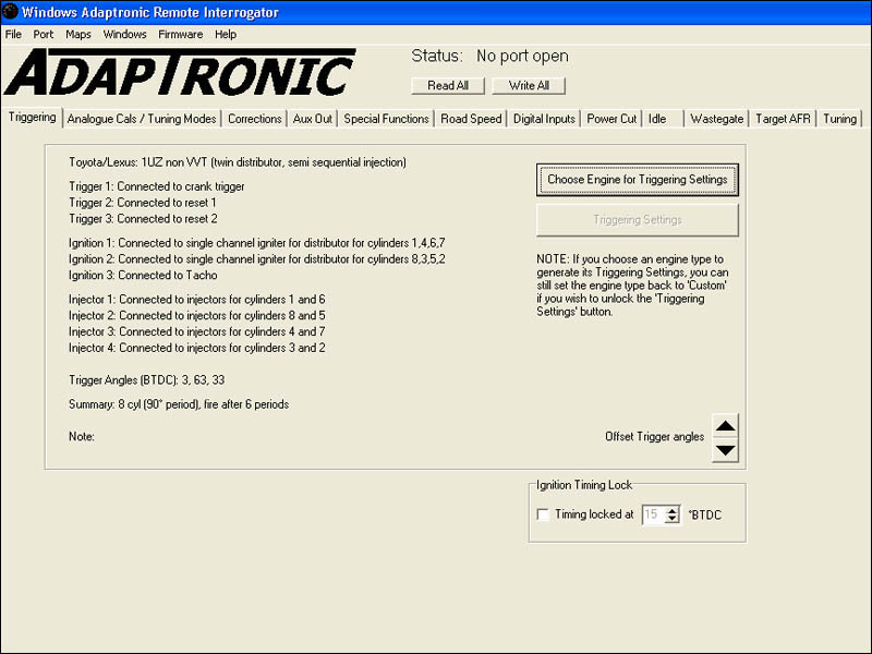

This will then load all sorts of values in this screen and you will feel like you have accomplished a great feat. We're almost ready for liftoff.

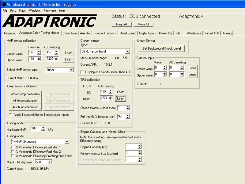

Now to move on to setting the TPS sensor for minimum and maximum throttle positions. This is explained in the installation guide and it's absolutely necessary as it tells your computer which number values the TPS gives for both the closed throttle postion and the wide open throttle position.
Ok here was are checking out all sorts of sensor values. The easiest one to take care of right now is the TPS calibration. As long as you have the wires connected correctly this vital step will only take a few seconds. You basically hit the button "learn" at the 0% throttle line and it will set the value at which the TPS gives for the throttle being at closed (0% throttle). Then you manually grab the throttle butterfly with your hand and open it all the way and set the 100% TPS value but hitting the lower "learn" button. That's it!
