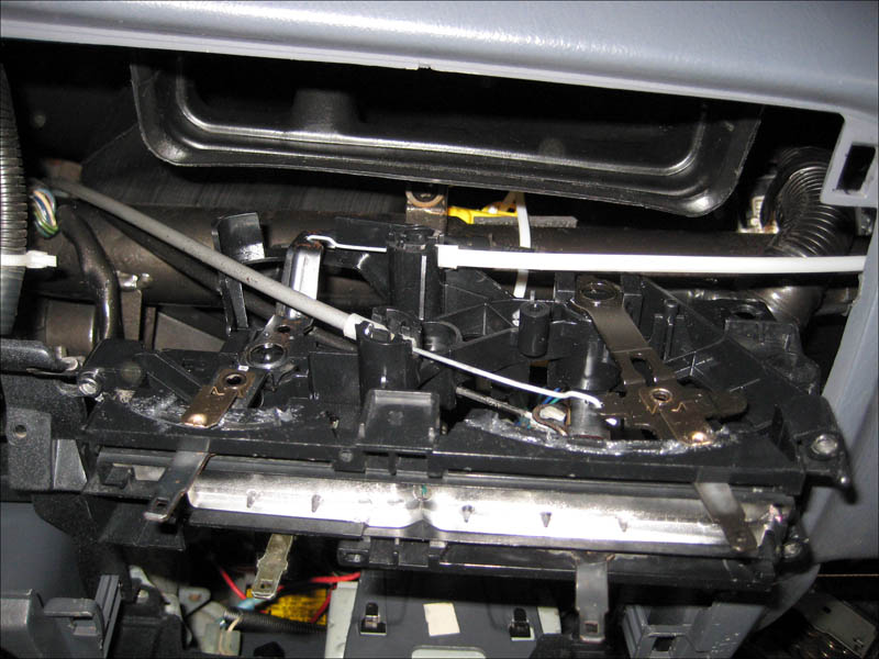

Anyhow here is a look at the Tacoma HVAC controller with the cables reconnected.

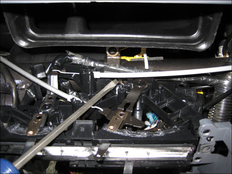

Here is a look under the unit in case anyone needs to see. Just next to the yellow dot you can see the steel tab that the controller must be mounted under. Just installing the HVAC controller with the back end down will do the trick but it's a pain if you forget about it.

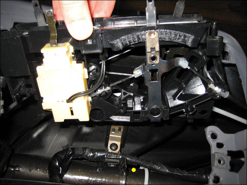

Here we have the controller installed and I'm pointing at the steel tab with a screwdriver. The AC button wiring connector is a pain to reinstall into the controller but to remove and reinstall it you need to release the plastic button on the connector and remove it from underneath. Re-installation requires you to push it up into the controller from the bottom in the reverse fashion of course.
To anyone preparing to remove this unit make sure you remove the fan speed selector switch (the big white things underneath the controller in the pictures in previous post) BEFORE you try and remove the cable that it obstructs. And when re-installing make sure you put the cable back and mount it in place before you attach the fan speed selector switch.

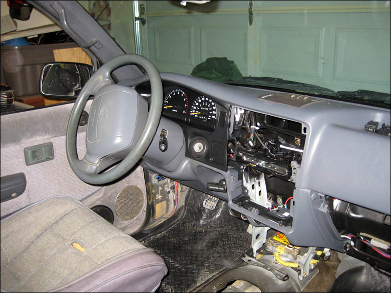

So waiting for some parts for the welder left me with some time to button up the interior. It's nice to have it all together and over with now. No more stray parts inside. I'm on my way to having a totally rejuvenated truck inside and out.

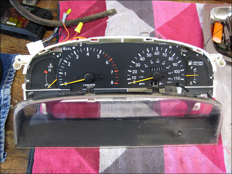

I'm most happy with how the instrument cluster came out. It was really really dirty before and the plastic casing was scratched from cleaning it. Now it's nearly new after taking it completely apart and polishing it clear again.

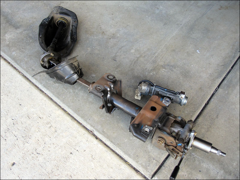

And also while I was making a new body lift for the truck I wanted to extend the steering shaft instead of using an extension. I'll get way better piece of mind while going over the woop sections with a welded steering shaft! I always fear the steering wheel coming off in my hands when under the worst conditions!!
Check out this thread page showing the removal, maintenance, extending and painting of the steering shaft.
