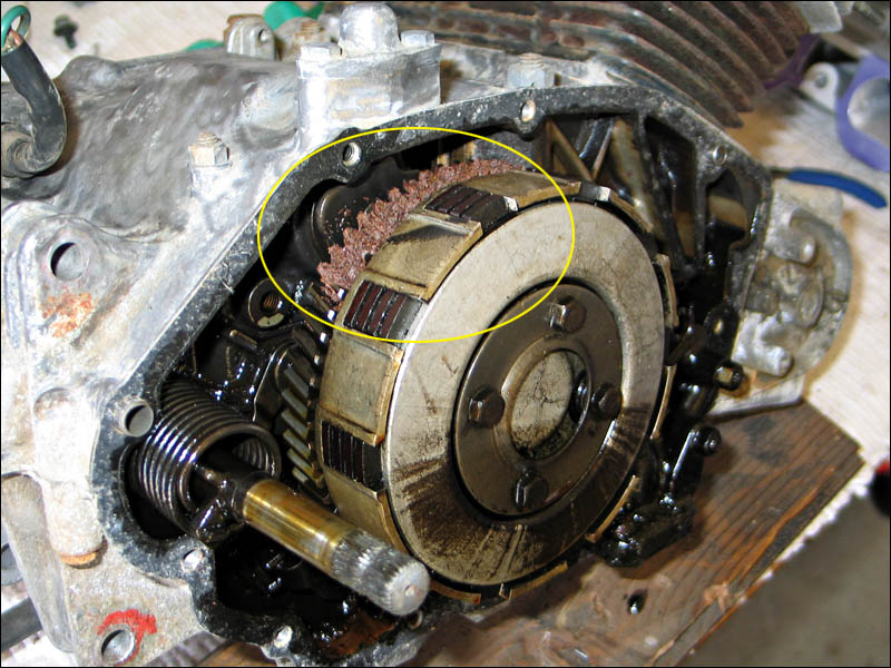

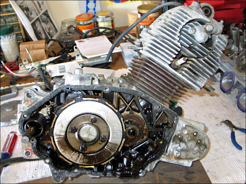

Each side of the engine once the side covers were removed:

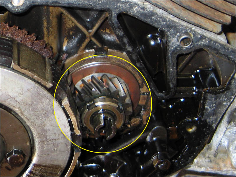

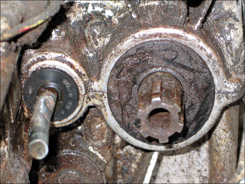

You can already spot some trouble with the shaft that actuates the clutch through the engine from the left to right side. It's located right in front of the sprocket shaft and it's not looking too straight (I pulled it out a little to inspect it).
Here you can see the oil level as it sat for decades, outside, with oil in it. Since it sat outside the oil was a good thing to have in it but what a mess. If the bike had at least a thick bedsheet over it the whole frame and engine would have been in much better condition. <_<
This is the rust that results as the oil slowly falls away from the surface of the top of the gear over the years. This would not happen if the engine was covered or indoors. Amazingly this all cleans right off with a wire brush and leaves very minimal surface distortion behind.

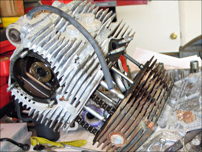

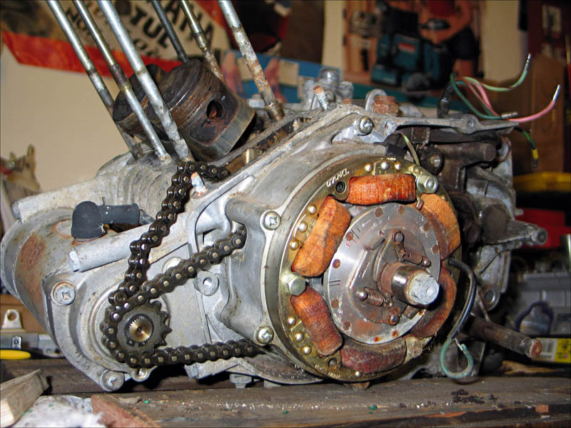

Now the cylinder is freed up once you remove the top acorn and regular nuts from the top of the rods. That's the easy part. Now you need to remove the master link from the timing chain... not so easy if the cylinder is frozen up!!! If this is the case (as it is mine) then you have some work to do since you have to actually move the crank (frozen pistons and all) in order to get the chain moved to the point at which you can get to the master link in the chain. I was lucky enough that the master link was close enough. You can see it at the very bottom barely... :D
So if you take off the timing sprocket cover and don't see a masterlink on your chain then take the bolts out of the sprocket and wiggle the chain off in order to pull the head up just like this.

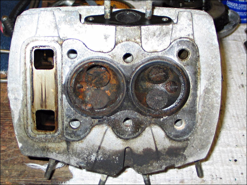

This is what happens when any of the valves are open when you leave an engine sitting for years and years... The air is allowed to enter the combustion chamber which promotes rust. It's pretty obvious here that there is much more rust in the side that has the open intake valve. Thank goodness that the exhaust valves weren't open! Yet air still comes in and out of the intake side nonetheless. So the next time you store your bike for over two decades make sure and plug the exhaust and intake up with rubber balls. :P
Now the cylinder head rust isn't that big of a deal to me. I'll be taking the valves out and lapping the seats anyways. Besides the valve seats getting a little gritty from rust (totally fixable) the rust is basically just cosmetic. But the cylinders getting rusty is a HUGE problem. Keep onnnn readin...

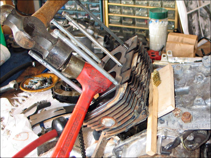

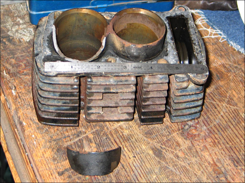

Now that the piston is somewhat loose time to try and pull off the iron cylinder. This was impossible by hand in my case as the cylinder walls were a tad rusty. You want to pull the cylinder up and push the pistons down and out. I found a perfect solution... not one big hammer but TWO! I used the brass one as the object to place in the cylinder in order to provide a nice big target to strike with the big steel hammer. This worked great. To get the piston completely free and out you need to elevate the cylinder a bit because the intended stroke of the piston does not push it down to the bottom of the cylinder. So if you just leave the cylinder attached and start slamming the piston it will be at the bottom of its stroke and you're just beating pointlessly on the crank.
So find some wooden blocks of some sort to place under the cylinder to keep it up off of the engine cases. Use larger ones once you start making progress. And just to save yourself some time get some wood and have a saw ready to cut the appropriately sized blocks. I was in a hurry so stopping to take pictures was painful enough. The blocks need to be shorter but not too long to get a good fit.
I had to really hit mine hard, really hard just to move it and it took a lonnng time. I highly recommend filling both cylinders with some sort of "break-free / parts lubricator" solution and leaving it overnight. I had plenty in mine but if I let it sit for a day or two it would have worked better I'm sure. If you can spray some WD-40 or something underneath the pistons with the straw. There might be some exposed cylinder wall under the piston if you can wiggle the extension tube under the cylinder in order to get some spray around it.
I wanted the Honda ca95 cylinder apart that day and I wasn't planning on needing this cylinder as this is the spare motor. If this happened to my only cylinder I would probably be able to fuse the piece back into it's original position and hone it back to operating status. This would be doable since it would be held together by the engine case and it's not close enough to the combustion chamber where the massive forces are present. This would be LAST case scenerio since this piece is so rusty I wouldn't want to spend the time to hone it out to the point at which it's acceptable then I would have to figure out which overbore size piston and rings to use... then I would have to find them! These cylinders are out there for sale so I would just buy another one.

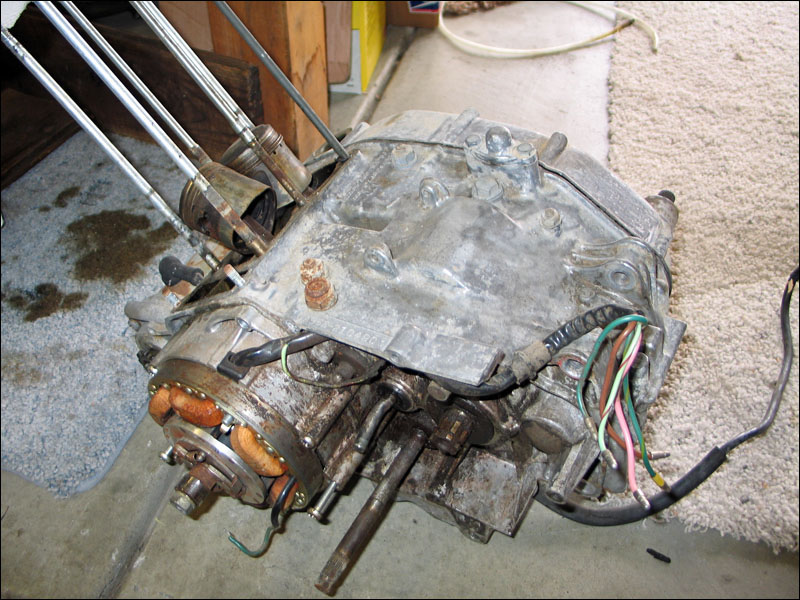

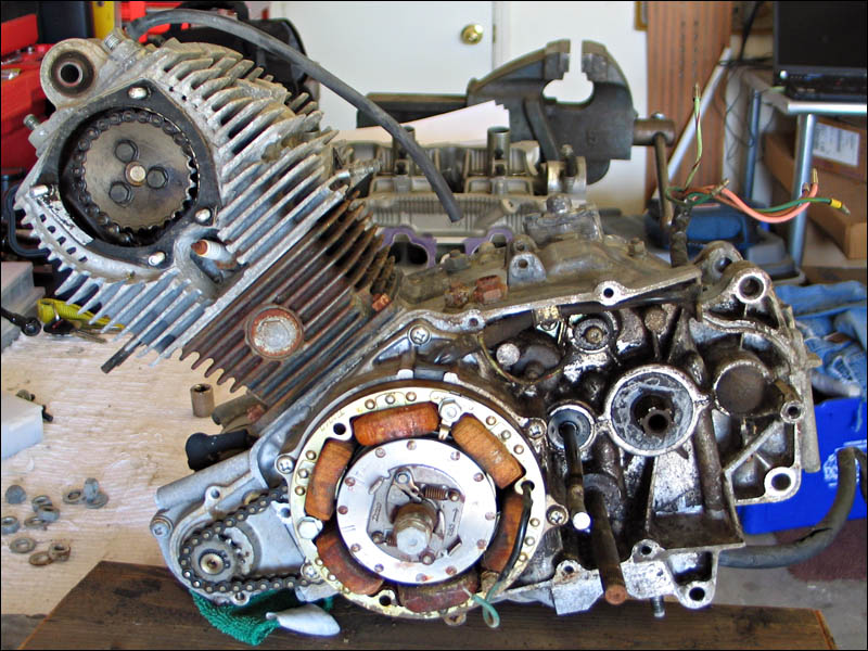

Here is the timing side of the engine. Don't try and crank on this side in order to turn it over. Everything is too delicate to chance damaging and nothing was designed to hold up to such great forces on this side. You will snap the head of that bolt right off and make some real problems for yourself! You can see that these pistons were solid rusty and the rings were super packed as a result... remember the amount of rust from the clutch gear? It expands to fill the gaps between the rings. The little Honda 150 pistons look as if they were seized but that wasn't the case. That's just how nasty the cylinders scored the piston as I had to force them out.

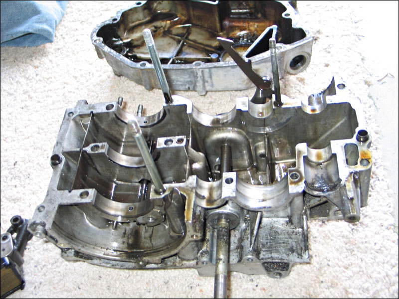

So now it's September and I today I needed to split the transmission cases. The good engine (that came with the blue frame) had a crack on the bottom engine case where the foot pegs mount. This was due to a crash of course and a previous owner had tried to cover the whole crack with a big glob of epoxy. He definitely tried hard to fix it this was since the epoxy was pushed in pretty good. The problem with this was that the crack usually never stops in aluminum so it cracked even more because of the stressful location. So the oil leak wasn't stopped.
I took it to a engine block welding pro who removed some material with a special chisel and showed me how far back around the crack actually continued. The only way to salvage the case would be for him to force the crack and remove the area that was damaged. Then he would weld in a new piece of material, drill and tap the thread that needed to be added and then just do a lot of finish work. Basically I would be using my spare engine for the bottom case. All the hassle for that piece just wasn't worth his time if I have a spare... and thank goodness I do!!
So here is the engine since I was last taking it apart... my spare Benly motor.
Since i had just had carefully taken apart the main engine I really had the process memorized. I took of the few remaining items and had the cases apart in 3 minutes from this point. B)

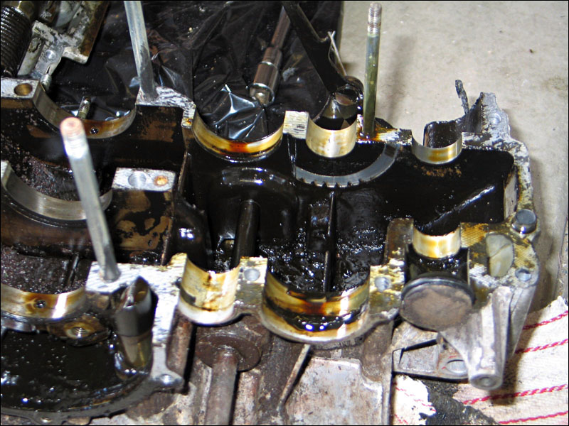

Now the nasty part of all of this was cleaning it! The insides of the spare engine were completely caked in oil residue like it was neglected. I have a hunch that the spare engine was used far more than the main engine and they changed the oil very few times in it's life. It was a good thing that all I needed was the bottom case and the new shifter post/rod that was attached to it.
It's nasty but it cleaned up just fine! I have this floor stripper that is water soluable that I buy in 5gallon buckets in concentrate. I dilute it 3 parts to 7 with water and it cleans oil and dirt at the same time, very well.
So this is about as far as the spare engine goes. I'll loosely assemble the parts and just put it aside. If anyone wants to buy spare parts from it you can email me at dexxter050 at yahoo.com
There isn't much left but it's almost impossible to find random parts like shift forks or springs and stuff from anywhere else.
Here is the lower case that had a crack in the bottom. It's clean but I couldn't use it. So I had to spend an hour cleaning the nasty black spare one that you see above. It wasn't fun.
