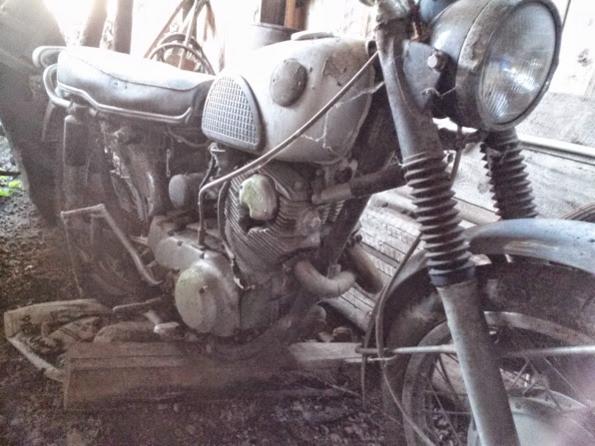

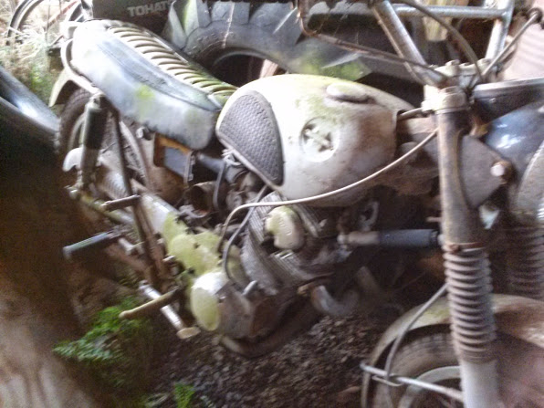

Sorry for so much off topic stuff but in getting to know some of you a little I've learned many of us have a wide variety of interests, so, if this is too far off topic let me know.
A friend of mine is offering me the Scrambler with the tank badge if I get the Scrambler without the tank badge running for him. Since I have no common sense and I never keep track of how much time I spend on a project this seems like a no brainer to me. Scramblers are not my favorite bike but I did ride one quite a bit back around 1972, straight pipes and loud.

The "payment" scrambler is worth $400. The scrambler to repair will take 120 hours and $600
worth of parts(tubes, tires, bearings, cables, chemicals, paint etc.) and I assume it needs engine work.
Then you will be reporting your progress to this person for the duration of the project. After the project is complete, you will be the contact person for everything that goes wrong. God forbid you forget something and someone gets hurt.(which is why I sell my projects and do not take on this type of deal)

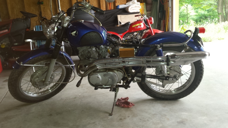

I had a similar experience recently, where a neighbor decided that he wanted to ride his '66 CL77 Scrambler after it sat unused for 12 years. It had dual points, which was interesting to adjust. The valve rockers had the biggest gaps I've ever encountered - I could put my small finger in the gap. I presume somebody loosened the adjusters and forgot to set them.
Anyway, it runs great now. I didn't care much for the ride, though - it rides tall, almost like an adventure bike today. The scrambler has the 180 degree crank, and sounds interesting compared to the 360 degree crank in the CA77 Dream 305. Almost like a Harley, with uneven pulses.
Tomorrow I'm replacing the clutch on this bike. In the pic below, the seat was off for maintenance work.

If all you have to do is get it to run jump on it...File the points, bypass the wiring and wire the coils directly, clean the plugs, look at all four carbs for the best of them, fire the bike up. You could make a go no go decision in about 30 minutes of inspection.

I need to nail down what jimmys expectations are, but, he said "Maybe I ought to give you that one for getting this one running for me." I took that to mean, no paint no polish, just getting it running with all systems functioning. I was figuring on freeing up brakes, cables etc, . A real big deal of course is the condition of the inside of the tank, which I haven't checked yet.

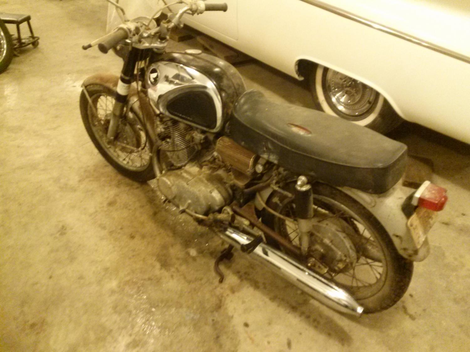

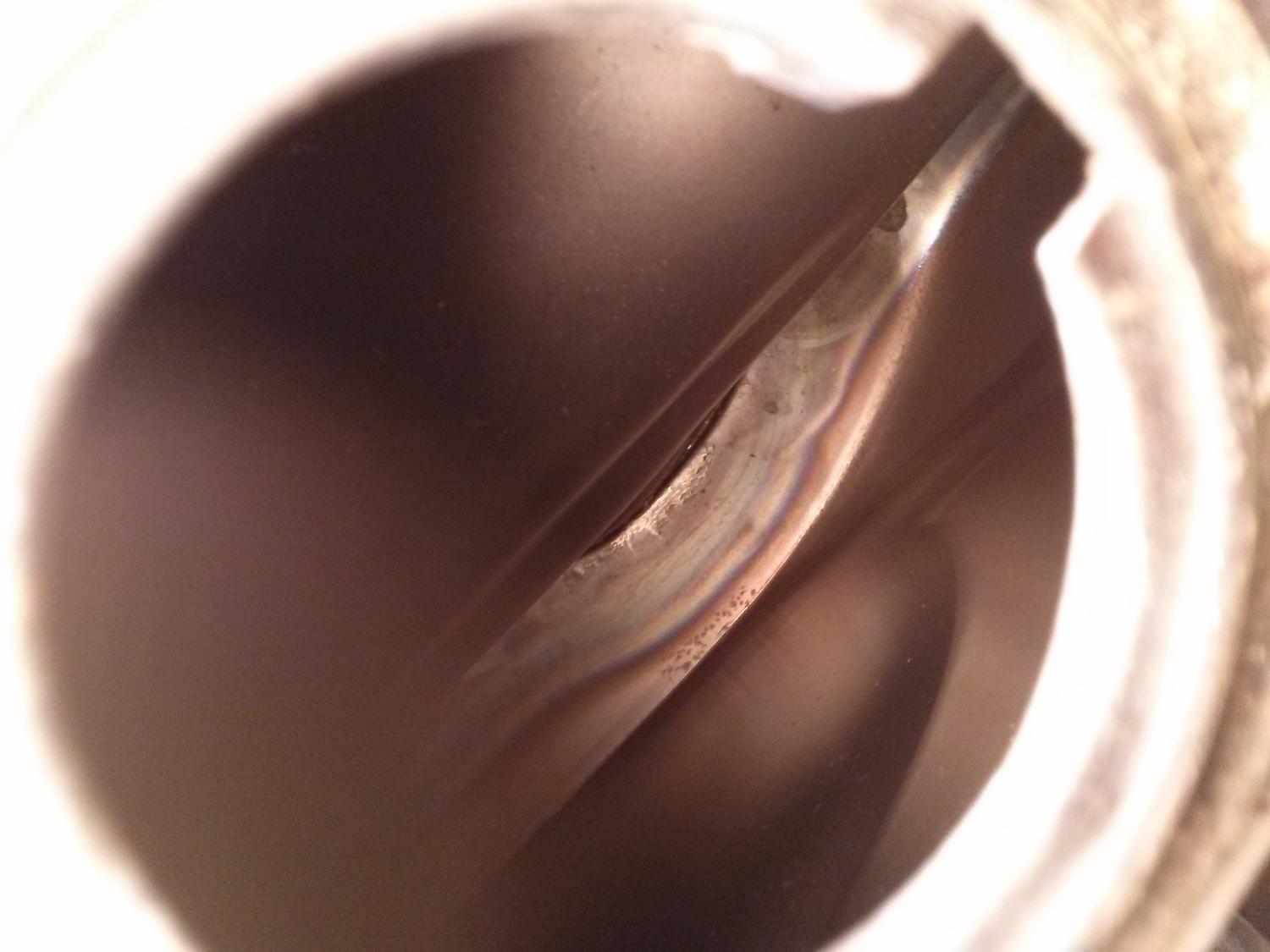

I went out to my shed to get some primer last night. I grabbed my flashlight. First thing I noticed was the shadow of a bike parked in the entry way. I thought Jimmy had dropped off one of the Scramblers. Funny how long it takes the brain to make sense out of something unexpected. I stood there staring. Low pipes? Chrome Tank? Wait a minute. I'm not looking at a Scrambler, this is a Hawk. I thought my son and I had got Jimmy's complete tour last week but apparently not. There had been no Hawk sighting. The only thing I can figure is he wants to trade this CB77 for me fixing up his Scrambler and using the second Scrambler for parts. At least that's what I hope he wants. I am going to try to get hold of him this afternoon. The inside of the tank is clean, there is decent looking oil in the motor and it isn't seized. The first pic is barn fresh. The second pic is after a little simple green and elbow grease applied to the tank chrome and left muffler. Fingers Crossed.

Wow, really cool Hawk - why doesn't anybody drop vintage Super Hawks in my driveway? It's just not fair! Nice bike - when will you learn the rest of the story?

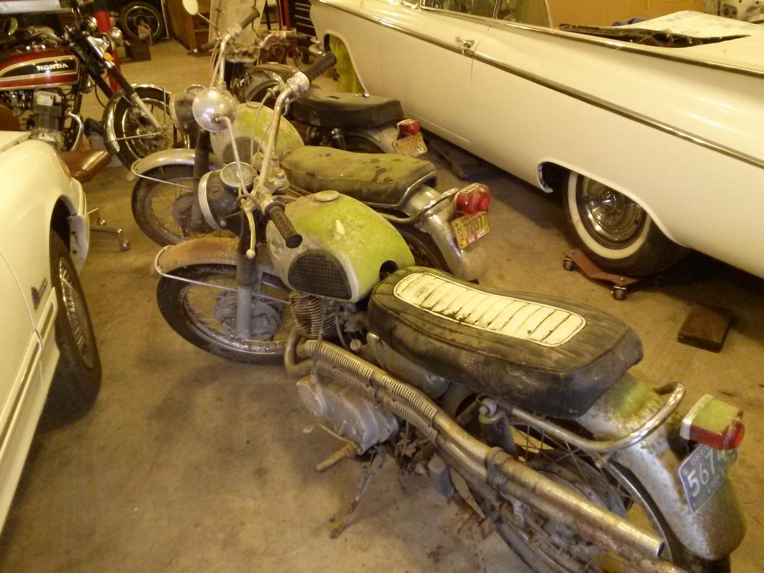

He is happy to give me the Hawk in trade for refurbing his Scrambler I will clean and polish it, but not paint it. I will get all of the mechanical and electrical systems working correctly. The second Scrambler is to use any parts off of if needed. Here is a pic of the three bikes together and a pic of the inside of the Super Hawk tank.

Very nice...pipes don't look too bad either.Due to the high bars I'd say likely a 66 or later. Awesome and a keeper....double check the cast Al foot peg brackets for cracks.. these are difficult pieces to get.

It's very interesting to me to compare the Scrambler and the Super Hawk side by side. The Scrambler seems to be a bigger bike. It has a higher seating position and the foot pegs are set several inches further forward than the Hawks. And of course, the Scrambler has the down tube. It makes me wonder just how fragile Honda felt the Hawks frame is. I am every excited about working on the Hawk, it only shows 4,000 miles. But, I can't even touch it until the Scrambler is done.
Actually the Superhawk used the engine as a stressed frame member and in theory should be stiffer than the single downtube. Any of those bikes are saveable and you should have some nice gems when all is said and done.
