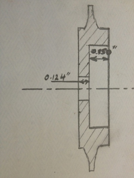

Just as a double check that I'm not going in the wrong direction, would someone be able to check these measurements against another camshaft gear for me....
Also, does anyone know what the idea of the spacer washer is? why would you need it?....seems that they could have machined the gear a bit shallower and you wouldn't need it.... :confused:
Thanks,
Kev :)
Sam Green
Post by Sam Green »
It stops the cam moving from end to end, the outer cover buts up to it.
