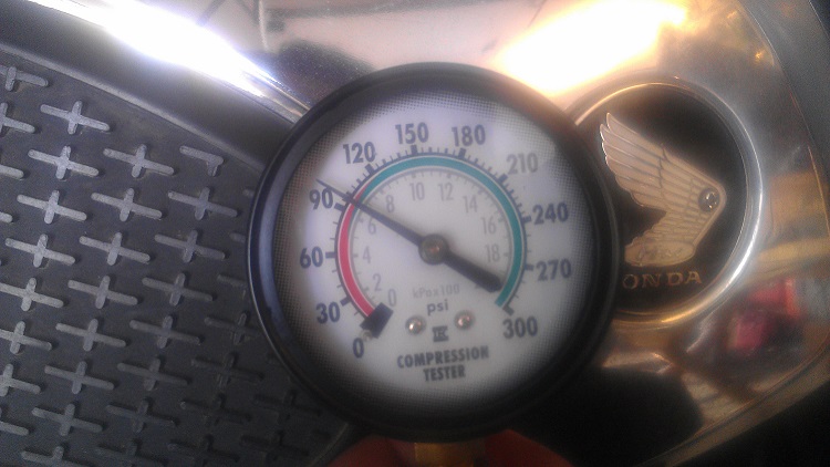

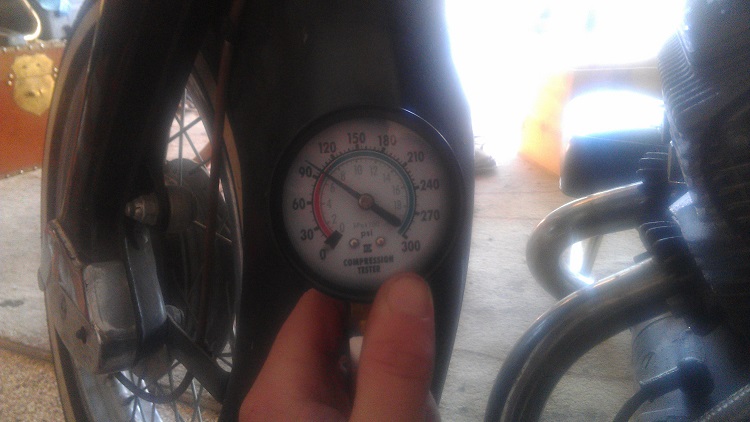

I went out and bought a compression test kit this morning. I came right back home and began with the right cylinder. I turned off the gas and drained the float bowl. Then I took the plug out and connected the pressure gauge. I turned her over and the right cylinder read 90 PSI. Turned her over some more and the gauge red about 90 PSI tops.
I squirted some oil in there, turned her over, and read 130 PSI. Cranked some more and it stayed at 130 PSI.
Did the same on the other side. Screwed in the gauge, turned her over, and read 90 PSI. Squirted some oil in and the gauge jumped and kept rising the more I cranked, unlike the right cylinder, to about 240 PSI.
Kinda weird right? Something's fishy. My re bore job must have been terrible.

The oil addition to the cylinders confirmed that the low compression is due to cylinder issue. I can't speak for the 240lb reading.
When you ran the bike to blow the oil out, were both cylinders firing? The next starting after the oil/compression test, take a ride on the bike and confirm that the non firing cylinder exhaust pipe is hot. The bike should run strong for a short while.
The bore of the cylinder may be fine and the rings, or one ring may be installed upside down. An additional ring installation technique is to space the ring gaps at 9 o'clock 1 o'clock and 5 o'clock. Ring gap alignment is also a cause for low compression.

Crank or kick until the reading no longer increases.
The numbers appear to be a bit better than 90 PSI in the pics, ironically higher in the cylinder that you say isn't firing. Although these readings are low, if the right cylinder is firing ok while having the lowest compression of the two cylinders, something else may be affecting the left cylinder.
Interesting ... gotta think on this a bit.
