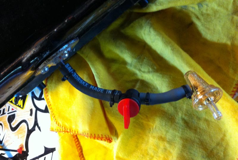

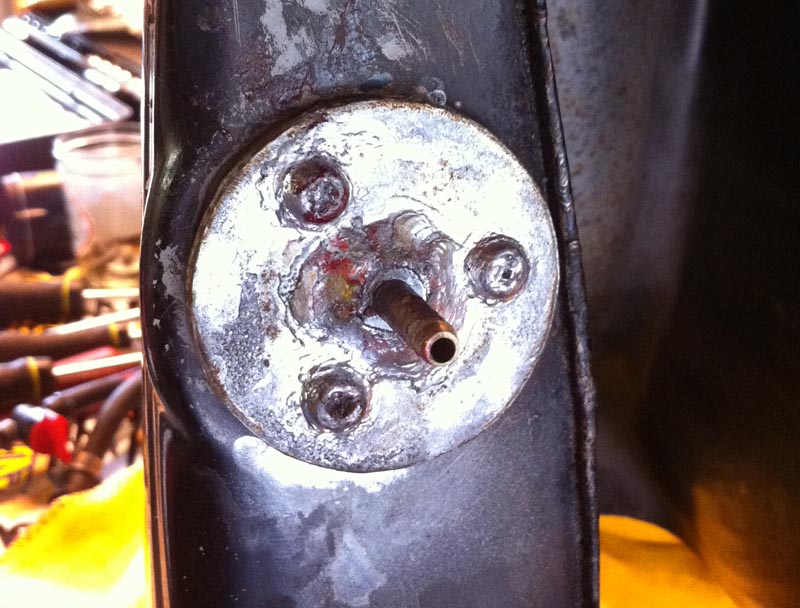

Hey all,
I bought a rebuild kit for my petcock because I wanted to use the stock petcock but when I inspected the previous owners mod closer I realized the screws had been sealed over. Is this JB Weld? Now I'm wondering if I should just leave it since it works but it's not pretty. :/
Unread 06-12-2012, 07:13 AM
I don't think it would be worth the time and effort to fix that tank seeing how it's all gummed up like that. Looks like you would have to grind all of that away. You could try vise grips on those screws to break them free but that custom plate looks like it might be sealed on the tank surface with the same JB Weld looking stuff. That's too bad.

Originally Posted by Martskin View Post
Hey all,
I had a similar scenario with my previous tank that had a workable aftermarket petcock but managed to locate another tank with an original petcock that I refurbished with a RetoBike kit and it works flawlessly now...they do come up on eBay now and again...I now have that tank (with the aftermarket petcock) in case anyone is interested in it, but probably not worth the shipping cost unless you're in Canada...I'd be happy to check on shipping costs in any event in case someone is in need...it's the least I can do for all the help I've received from the generous members on the forum..
Unread 06-12-2012, 08:22 AM
Martskin Martskin is offline
Join Date: May 2012
Posts: 29
Thanks guys. It works the way it is so I suppose I should leave well enough alone. Although my mind keeps going back to it. I guess we'll just keep an eye out for a replacement tank without a petcock.
