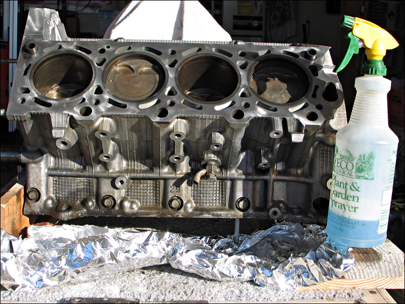

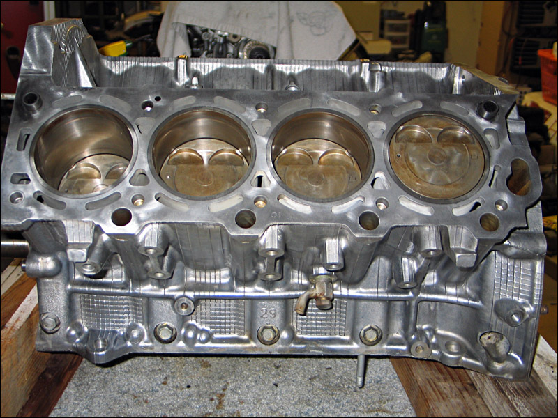

Alrighty I have some new pictures from some work today! Check these out. Here is my before and after of the cylinders. They were hideous when I took off the heads. Things were in great shape but just had a lot of residue on the pistons. The gasket left behind some material that I really had to work at with some razor blades.
And here is a closeup of how clean I got the block. I'm not going to lie, it's hard to get it this clean and it took a couple hours. It was really bad from the start. At least now it's going to stay clean as dirt and sand won't stick to it near as easily as before. Excuse the rusty bolts as they will be dealt with. I always put bolts back in their holes when disassembling so I don't forget where they went.

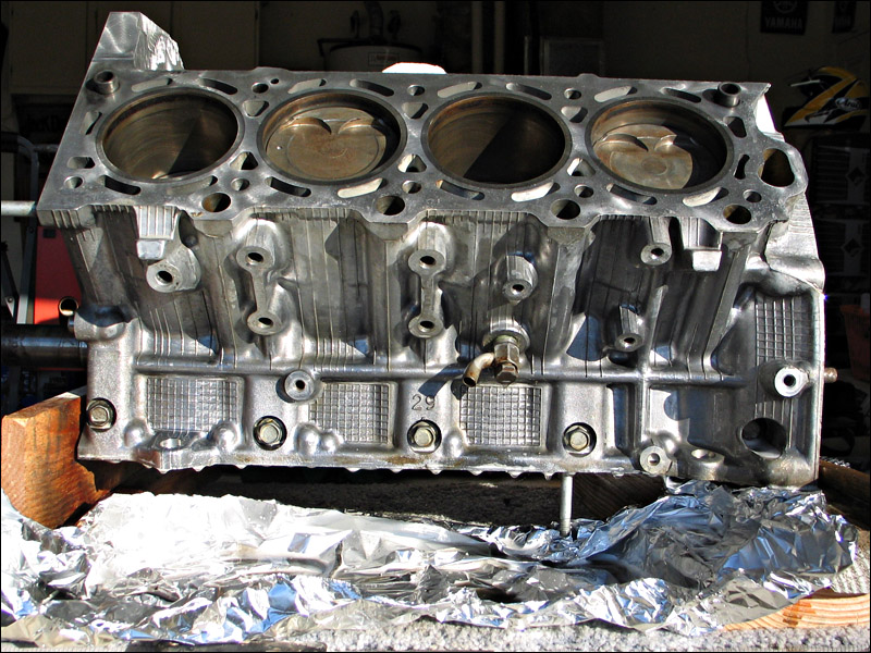

Here is a shot of the dirty engine just as I have sprayed it with the cleaner to let it soak for 5 minutes or so. Notice the foil in place to catch the crud.
And viola, here is the side of the engine after about 5 minutes of scrubbing with the small plastic brush. The brown spots are just difficult spots of buildup that easily come off with a little wire brush motion. I prefer my cordless Dremel for those little areas. The Dremel with a wire cup style brush shines those spots right out in seconds.

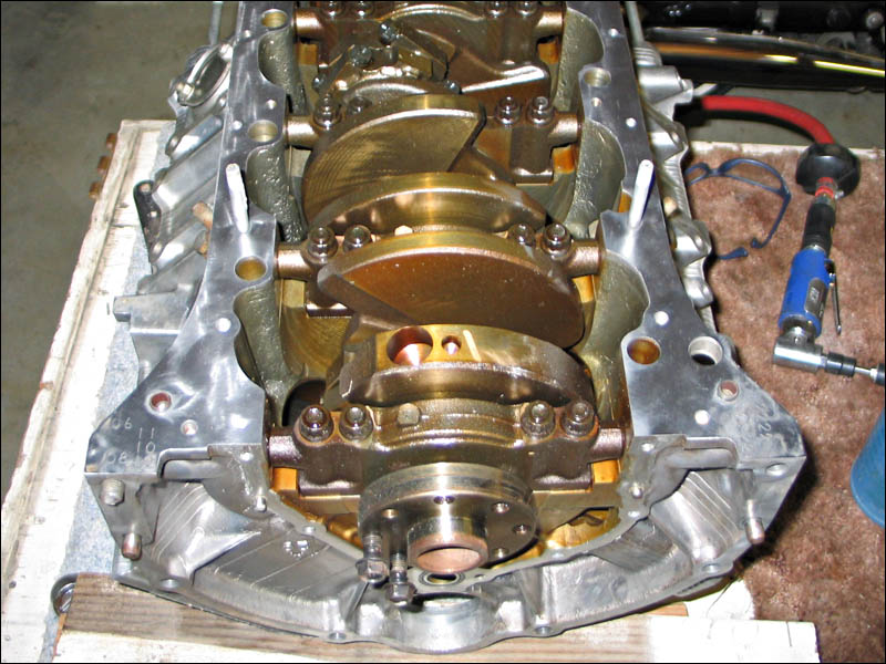

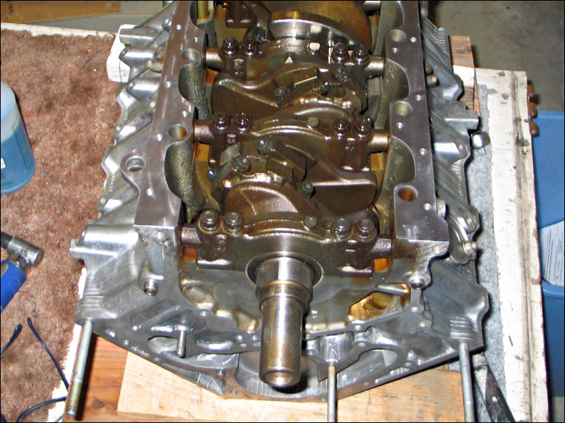

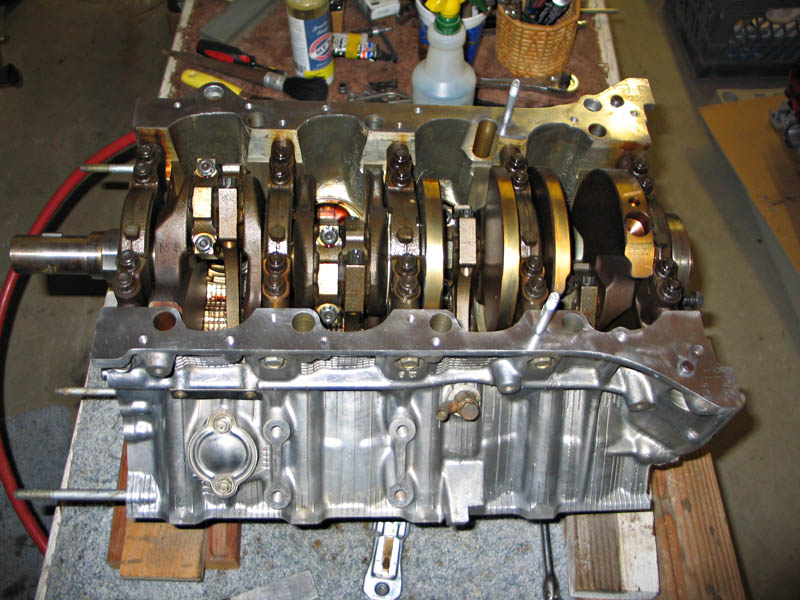

Here is the bottom of the engine as I needed to flip it over to surface the oil pan mating surface. I spent some quality time with the right angle grinder with a 3M brand 2" scotch type disc making it machine smooth and clean. Squeeze some Toyota gasket compound on one side and they will never some apart. That stuff is even more gooey and sticky than Permatex RTV Black!

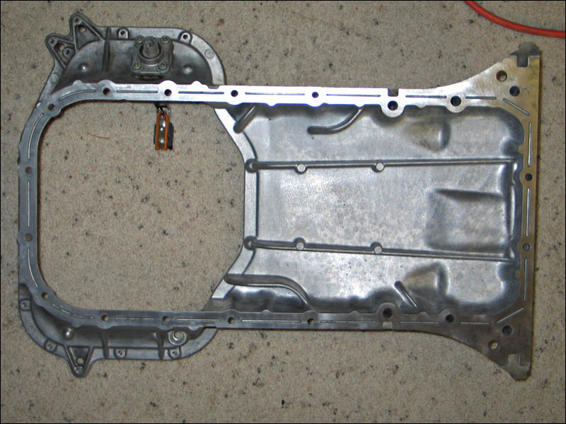

Here is the first alloy oil pan that catches the oil from the blocks perimeter and directs it down toward the second oil pan. Obviously this is a 1UZ-FE front sump, first oil pan.

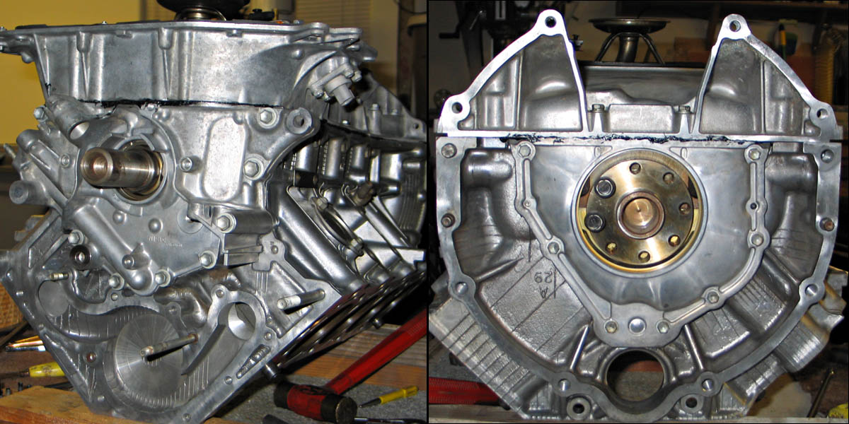

Cleaning the engine ends before you put the crank end covers on is a great idea. It's very time consuming to clean these area with the assemblies bolted on. But while they are off it's a very quick process. I parts brush with your degreaser will wash away the nasty stuff and the right angle grinder with the 3M pad will take care of the gasket surface.
Timing plate goes on this side. Oh and don't forget to pop out the front and rear crank seals from the inside out of the covers before you place them back on with sealer! They come out with one tap this way. When you try and remove them from the outside (after assembly) they will take you a while longer, depending on your automotive tech skills =]
Cover plate goes on this end.
It's always a time saver to scrape away the old gasket sealer away with a sharp scraper. Then follow up with the grinding pad and it will be super shiny just like from the factory.

Pics of the front and rear crank covers along with the first oil pan installed. Note the nice oozing gasket sealer all over the place. I have removed the old seals and I should have the new ones in Thursday. They simply tap in flush and that will be that.
