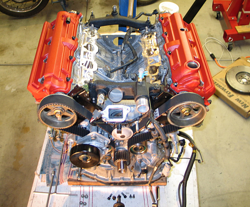

I've been waiting all week to see what the covers will look like on the engine. I got them back today and had a little time to rest one on top of the engine just for kicks. :lol: It looks better than I thought it would. I alllmost had them done black but I'm glad I went red.
I can't wait to get back to work on this baby. I bought some bits to help shine up the block surfaces nice and clean so I'll need to put in some quality time tomorrow making it worthy of the red covers. No pain, no gain.

Hey check it out! Got the cams perfect and valve covers on! That was my main goal today. Timing belt put in just right, got things cleaned and odd and ends painted up nice. Next I need to rebuild the starter because it goes right in the valley on top of the engine and I never want to have to replace it. Then I need a set of injector O-rings and some injector caps as they have all cracked from old age.
It's coming together nice and I had my homeboy Ed help make sure everything is going together correctly.
So now where am I at? Well I need to remove some carbon deposits from the intake manifolds and also the injectors need some attention. I've read about some builds in which the person neglects to change out the old seals and rubber grommets. This is not ideal. The rubber sealing these injectors from top to bottom are what, 15 years old?? YEAH this would be a very wise idea to change out all the rubber. I have the grommets and o-rings on the way from back east somewhere. They should be here tomorrow. I'll have a shot of them being replaced as well as the starter contact replacement maybe. These are just details that need to be addressed in order to guarantee reliability which is top priority.
