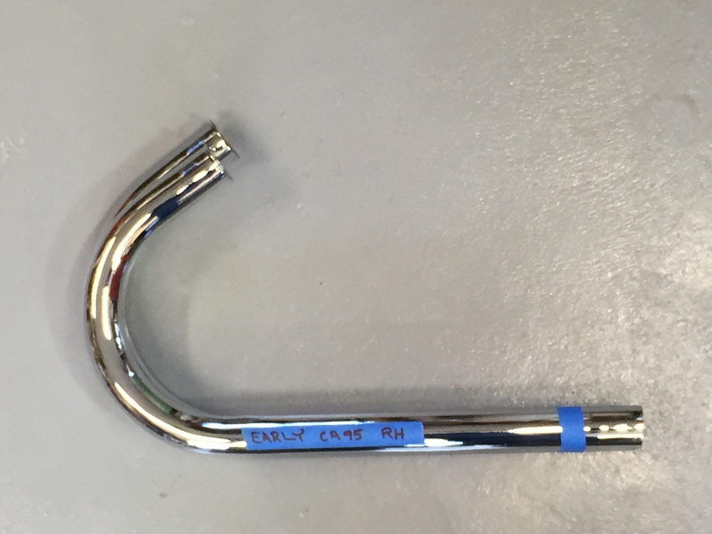

Frustrated with fitting header pipes to your early CA95? Even though the early Benly header pipes look the same, they are quite different, and they do have different part numbers. And maybe it's just my luck, but every used or NOS header for those models that I've bought over the years have always been for the right side until I bought a "pair" from Thailand which were of good quality, but upon arrival I discovered they were both for the left side! Finally I've got a pair I can use. Shown are NOS left and right pipes stacked on top of each other. Notice how the bottom (left) pipe is both longer and has a slightly larger radius at the top.

Yep, left and right sides are different on all ca95s. My late headers have more difference the yours. Beware with Thailand headers most people have reported having to mount them, unmount, bend with a pipe, remount, and repeat until they fit.
