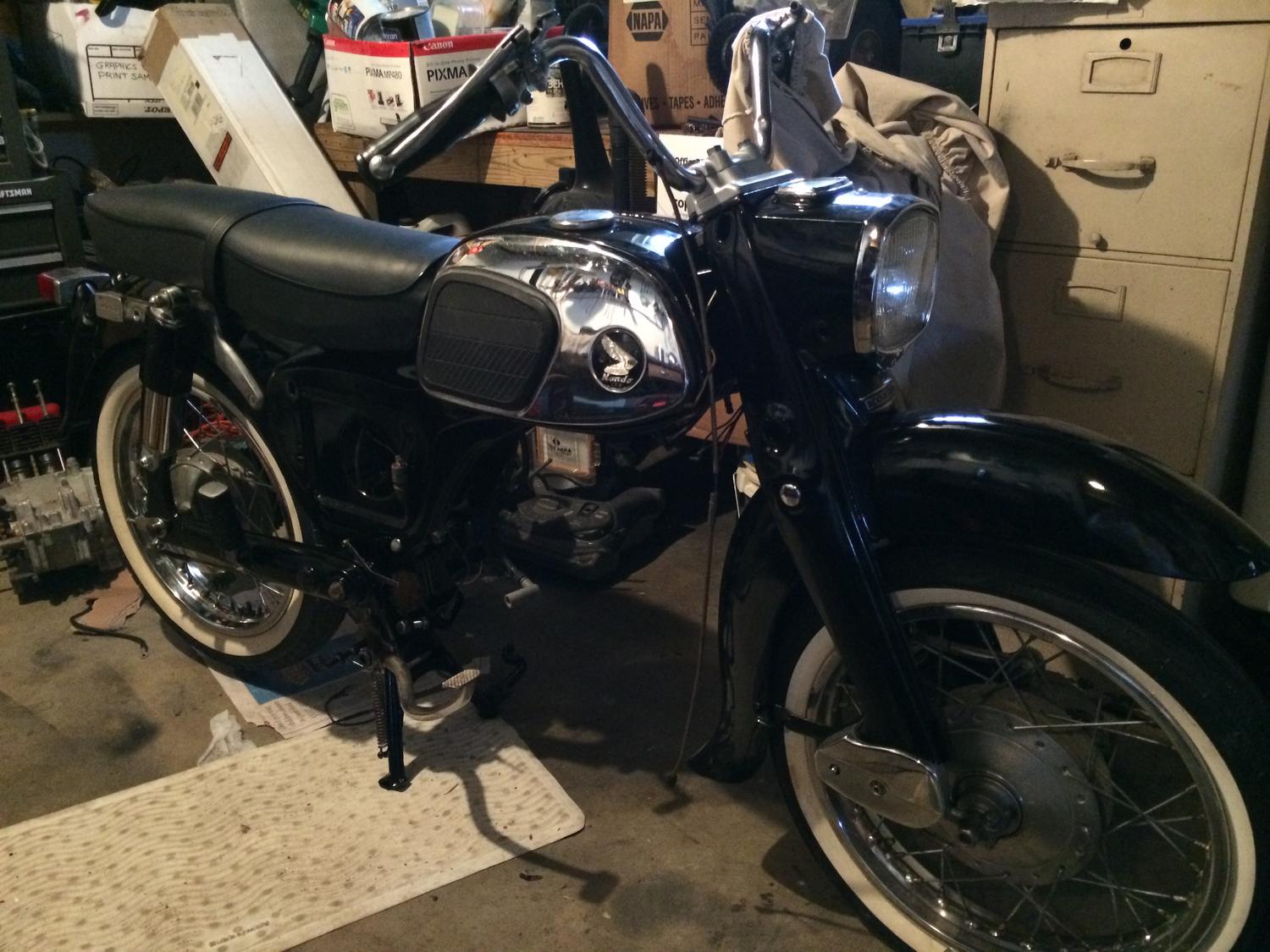

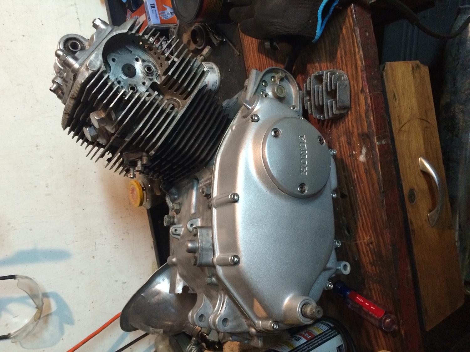

Do you think I could get away with just getting it bored out and putting larger rings on? I hate to spend any more money on it because I have to sell it anyway.
Anyway, I'm pretty happy with how it's turning out so far.
