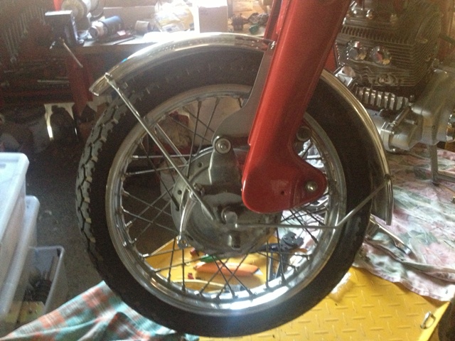

VegeKev VegeKev is offline
Join Date: Feb 2013
Hey Doc,
Nice lookin wheel there...the black hub and rim look sweet!
I've attached a pic of my front wheel and you can see the difference in the brake arm and position...
Cheers,
Kev.
