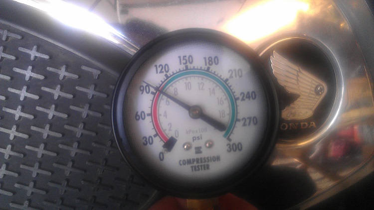

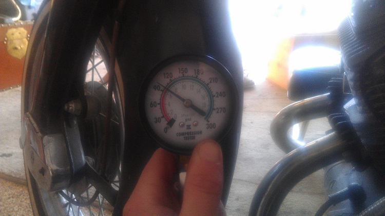

Does it matter how long I crank the motor for? Is there a general rule of thumb or do I just crank until the pressure stabilizes?
Anyway, I went out and did another test. This time I did not add any oil. Got about the same max PSI in both cylinders (90 PSI) with throttle open wide. No oil added.
Unread 11-24-2013, 10:43 AM
Crank or kick until the reading no longer increases.
The numbers appear to be a bit better than 90 PSI in the pics, ironically higher in the cylinder that you say isn't firing. Although these readings are low, if the right cylinder is firing ok while having the lowest compression of the two cylinders, something else may be affecting the left cylinder.
