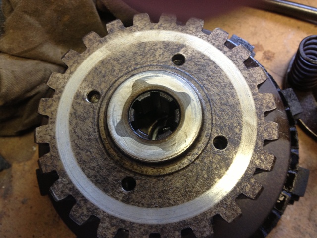

The question is: How many thrust washers did you remove from your CA95? You should have a washer between the engine bearing and the clutch basket like this:
There may be a "thrush washer" before the spring clip after the clutch basket is installed. The kicker is that the "thrush washer" I'm refering to really should be called a "shim" washer. Some engines have them...some dont. The engine in the pic is from my current build. It does not have a washer before the spring clip. I've opened up other CA95 engines that did.

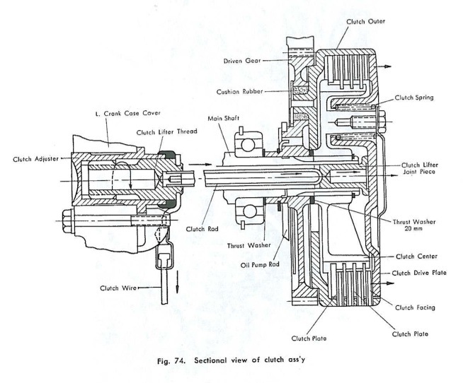

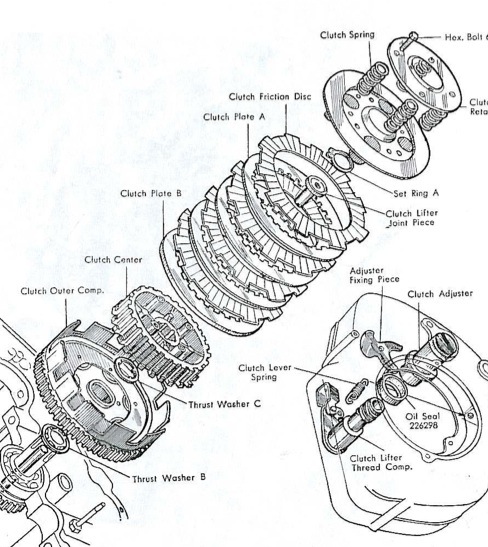

That's what I'd found. As an Aside, I've attached to two schematics I was looking at, in confusion, today.

RS, I have some really old motors and have never seen washer C or for that matter, the thick steel clutch plate. As Chip says, just washer B between the bearing and clutch basket.

Mine has that thick steel clutch plate.

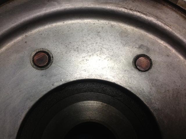

I've attached a picture of the back of the clutch-centre, showing where the rivets in the clutch-outer have been rubbing.
I've read the other thread where Sam has said it was early engines that didn't have this washer....is it possible that Honda decided to install the thrust washer 'C' to stop this possibility?
So my question is...should I use a thrust washer or leave it as is?

Kev, has a rivet come loose and is sticking more proud than the others, can you see if one particular rivet has been rubbing or have they all been rubbing?
I've just checked 3 outer baskets, all the rivets are proud of the back but all are dirty with oil and show no signs of rubbing. All three came from motors with no washer between basket and center drum and the same 4 thickness plates.
I wonder if the wrong clutch center has been fitted by the PO from the model that should have the washer.
Do a simple test. Put a straight edge across the high point on the back of the drum and measure down to where it has been rubbing, you should see 5.5 mm.

I measured up the hub on the clutch centre as approx 5.25mm....maybe 5.5mm if I looked at it long enough
There appears to be two rivets that have been rubbing. (see photo)
If I carefully take the top off these two offending rivets do you think I'd be good to go without the thrust washer?

I guess so but why were they rubbing in the first place?
