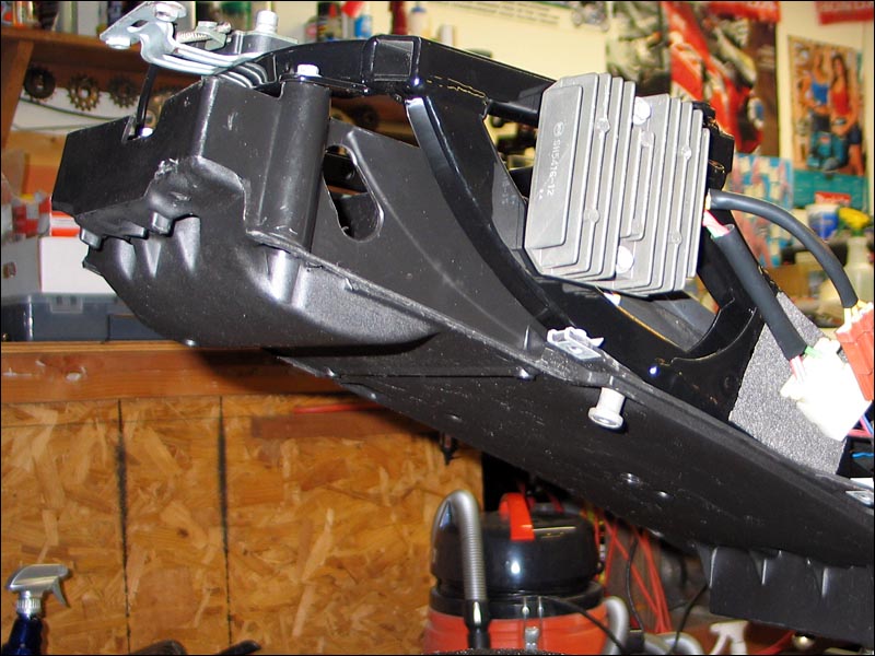

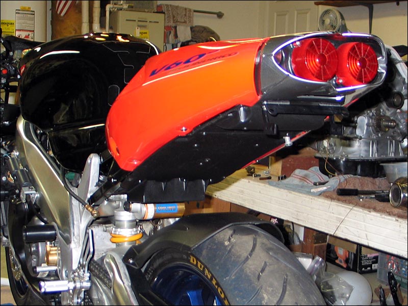

This is by far the easiest and best thing you can do to improve the looks of an Aprilia Mille. License plate brackets are easily made or bought for $40. Everyone knows what I'm talking about so let's dive in.
Before...

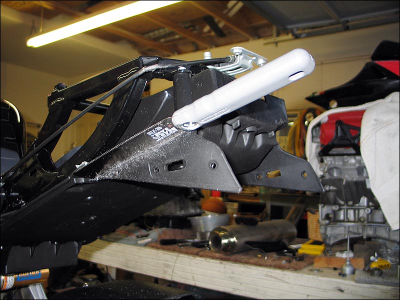

Time to chop off those ugly ears! Don't bother using a Dremel or high speed blade of some sort. That's way too aggressive and the blade will heat up and cause problems with the plastic. Just grab a simple Japanese saw from a hardware store like OSH or Lowe's. They are 10-20 bucks and you will wonder how you got along without one! They are seriously one of the best tools for custom work around the house and a MUST HAVE for working with plastic. They cut through plastic so easy it's amazing.

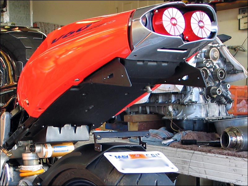

Here is the result: a perfectly cut line! The little Japanese saws cut so fast you can have your rear end trimmed up in less than 10 minutes from disassembly. Just for reference have a look at where I made the cut. I took maybe 10 minutes deciding just where to make the correct cut so have no fear. The pictures tell all.

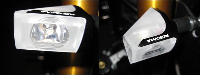

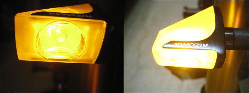

I haven't bothered to put some signals on yet. I'll post more when I decide on what brand to use. I'm thinking Rizoma brand. They are super bright and the angular design is very nice. It's either that brand of the ones that Graves racing makes. I've seen them on a few bikes and they are very bright as well... but just not at 360 degrees like the Rizoma ones.
Here is what they look like:
