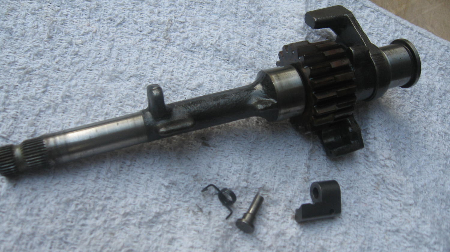

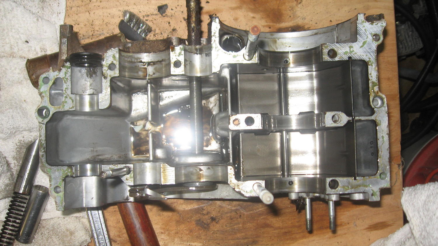

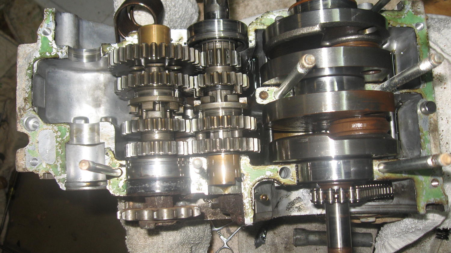

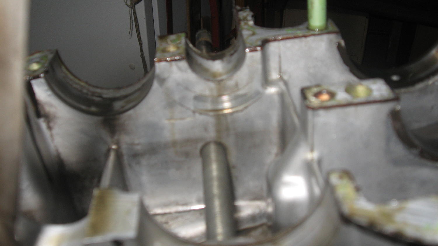

Finally got brave enough to split the engine cases to find out why the kick start just spun freely. Was relatively easy, but stank of old oil. Boy oh boy, am I glad I did. After the aforementioned- found pieces pictured loose in the case. Had I tried to continue with the disassembly, cleaning and lubing to get this '65 CA 95 on the road- the pieces could have got thrown in the gears and lunched the engine- not to mention locking up the rear wheel with consequences unknown! Holy moly!
Pictures show the top view of each half of case, the kick start bits, parts cleaned- ready to go and where a gear rubs the case. This seems to be the right time to replace the seals exposed, Ebay here I come.
Thoughts on either replacing the whole kick shaft or getting a new pin that holds the pawl?

Wow, looks like the kick starter ratchet came apart. That certainly explains what you were observing.
Unread 09-05-2012, 04:59 PM
Erik S Erik S is offline
Join Date: Jun 2012
Location: Jamestown, NC
Posts: 68
Big time came apart. I wondered why, when I got the bike the elec. starter was unhooked. Someone must have kicked it until it broke. There's a chip on the pawl. The petcock was repaired cheaply, the plugs were new, but show limited use. This had to be the early 90's. Someone tried to get it going, unsuccessfully.

Found a NOS kick ratchet on ebay- ebay +? Whatever, $18 bucks shipped. After getting a seal kit this resto can proceed. My bud at The Wheel Right Shop is checking on tires, tubes and rim strips installed. The next big project is the gas tank. Rusted inside, will again search the forum for advice.
