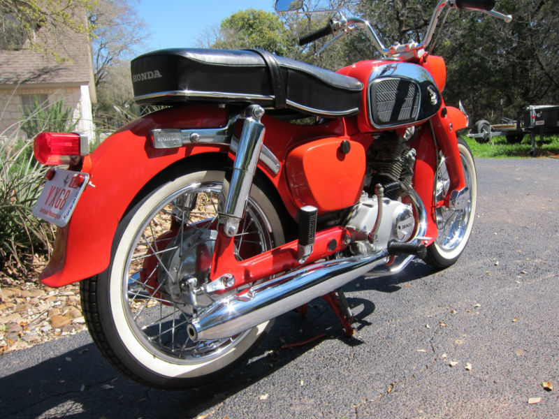

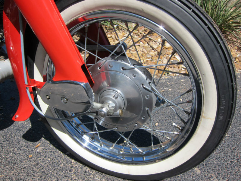

I checked the CA92/CA95 Driver's Manual .pdf and as Spokes stated... 3.0" x 16" is the proper size. I recently saved some pictures (24 in total) of an eBay auction for an awesome all-original 1963 CA95 with ~2k miles. I have attached pictures that serve as a nice visual reference of the correct original front/rear Ohtsu whitewall tires on that bike. For the blackwall crowd, http://onlyoldiesgarage.com offers the proper size and configuration (i.e., ribbed front, cross-hatch rear) Goodyear tires for our bike.

My '65's front tire looks to be an original for the bike Ohtsu with approximately a 5/8" whitewall unlike the gangster walls on the above '63. The narrower whitewalls also seem to be made out of unobtanium.
