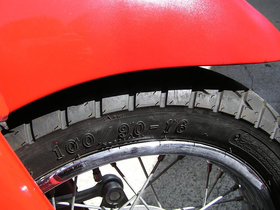

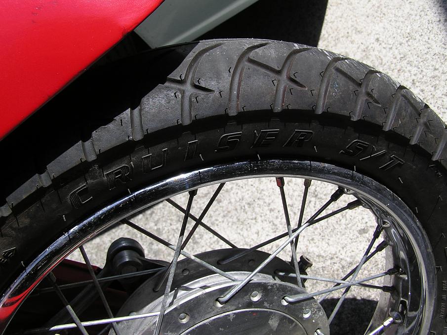

i have Kenda Cruiser S/T 100/90-16 on my bike now
and i bought a set of the Firestone WW Deluxe Champion tires 3.25-16 to put on the bike
but the Kendas are like brand new?

Thanks All. I have to look at the Kenda Cruiser S/T 100-90-16 for my CA160. I like that tread design.
Cool, so know I know that the 100/90-16 size fits. That opens up a few new doors.

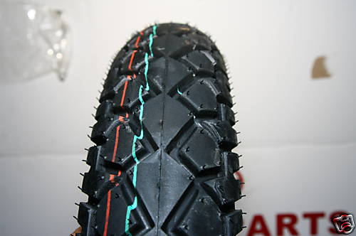

The Kendas are decent looking tread. There are some K761's on ebay right now for like $53 shipped. One seller has a single for $32 shipped, but it's either a crappy picture or the tire is really dried out.
I just ordered this one: http://cgi.ebay.com/ebaymotors/ws/eB...m=260599451847 for $16 shipped since my front has a split in the side with the tube bulging out. I figure for $16 I can't go wrong for a tire to do test runs on and decide later if I like it. The tread doesn't look too aggressive.

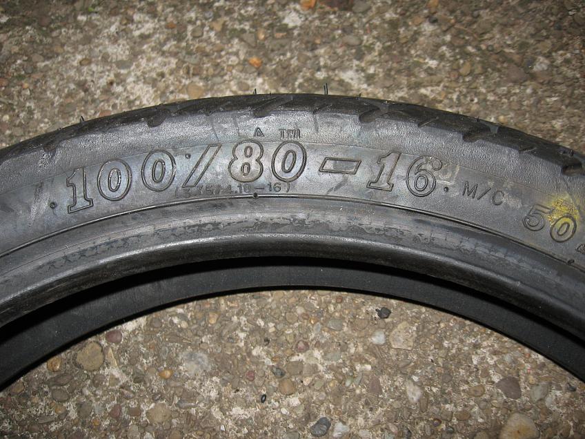

Well, unfortunately I didn't get what was pictured from my auction, but I may have made out a little better. Got what I have pictured - Cheng Shin 100/80-16, a lower profile tire by a little bit and better tread. Hey for $15 it's not worth sending back so I'm going to try it on my front and possibly buy another for the back. You want me to send it down your way to see if you like the size? I won't need it right away. Another user has 2 - $55 total shipped. No problem sending it your way for comparison if interested ....

Thanks
I am going to order the IRC NR21 Moped tire in a 3.00 x 16. That tire looks the closest yet. I will let all know when I get them in. Thanks for the offer!
