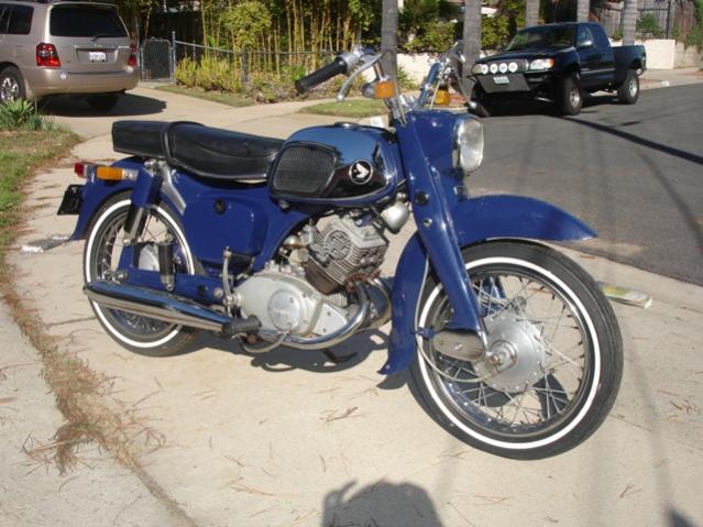

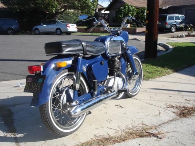

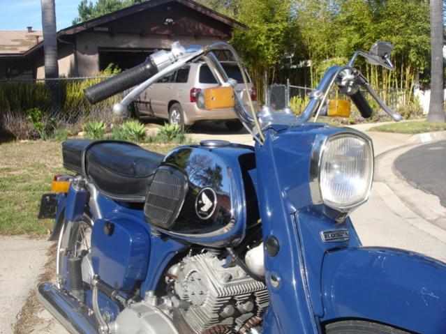

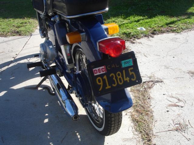

Oh, here's a few pics of the bike with the Buco bags removed. Gotta toss on some new tires and tubes too, they're original...ouch..
