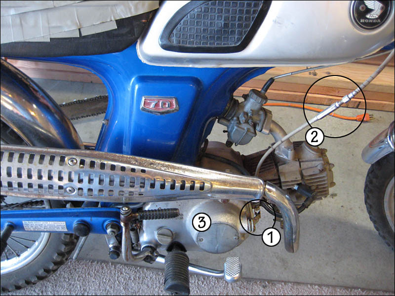

The little scrambler started right up the other day and now it's time to adjust things back to spec. Being that it hasn't been run in years the clutch just wasn't doing anything when it was pulled. It would pull the lever located on the right side of the crankcase but nothing was happening at all. It was kinda strange. My CA160 was doing the same thing and after I adjusted the clutch rod screw it worked just fine. It just seems that the clutch plates just need to be freed up a bit with the adjustments to get them working again. It doesn't help that the oil that was in the engine was too thick for the little engine. I drained the oil out cold and it was hardly coming out at all. This is very bad as it takes a long time to get the oil through the engine on cold starts. The oil needs to be somewhat thin to get through the lubrication system and in the bearings ASAP on startup. When the engine was started you could hear rattling noises for at least 20 seconds and those noises are raw steel surfaces hitting each other before the oil gets to them. Not good.
While I was adjusting the clutch I was draining the sludge out. The oil was clean but came out inconstantly still. This might be due to some condensation that might have accumulated in the engine and thus, another reason to change the oil after so long.
  • Lubricated pivots and check for full range of motion
  • Adjusted the cable taut attribute - to remove slack
  • Last resort remove two screws to adjust the clutch push

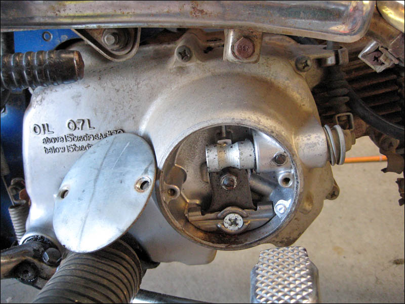

Here we get a little into the engine on the right side. Don't worry you won't see any oil as the clutch push has a seal with the wet clutch on the other side. Any Honda out there will probably be bone dry out there like mine was so just spray some WD40 or something in there to lubricate and help preserve the alloys from corrosion. The nut you see in the middle locks the adjuster screw in place so go ahead and free it a half turn loose. Then I adjusted the screw out (counter clockwise) about one whole rotation with a small screwdriver. This will push the clutch in quite a bit just to free the clutch plates when you pull the clutch lever from the handlebar. The clutch should surely work now so go back and adjust the screw inward (clockwise) back to where it was just so that there is no slack when you pull the clutch lever.
Check the cable adjustment (#2 in the picture in previous post) to make sure it's somewhere in the middle of the adjustment range. This way if you do need to adjust the clutch you can do it either way without taking off the cover again.
