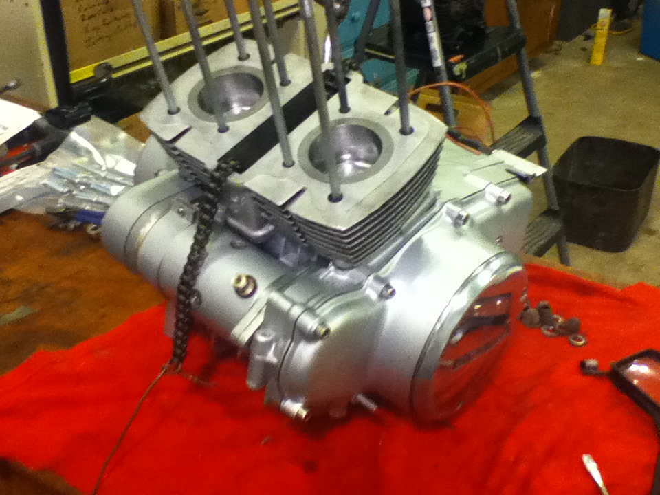

I followed your instructions and all went smoothly. Thank You.

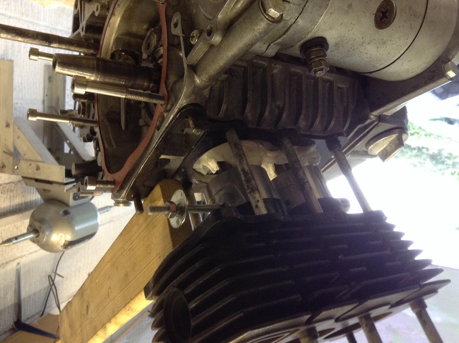

I have used zip ties as ring compressors but last time I put the pistons in the barrels (jugs if you must) from the bottom and pulled the gudgeon pins in using a length oft stud.
