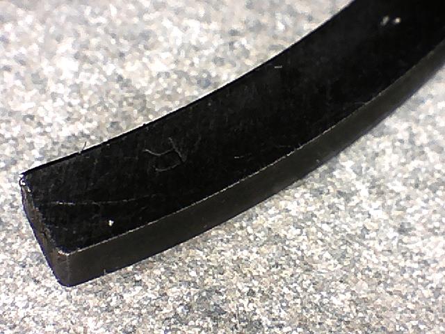

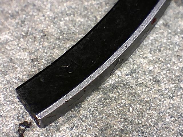

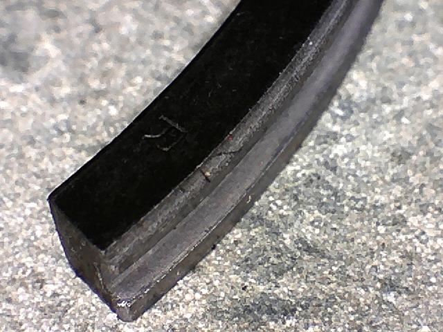

I grabbed the ol' digital microscope to take some pictures - maybe it'll help. The rings aren't as smooth as you'd expect, once they are under magnification.
Top Ring:
2nd Ring (chamfered):
Bottom Ring (oil control):

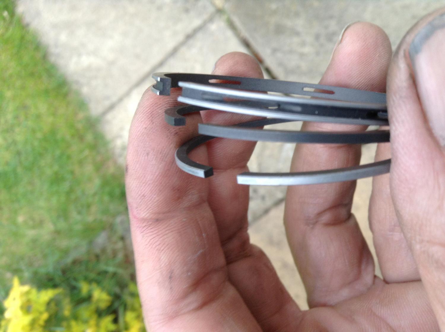

Thanks for the interest.
This is a spare set of rings, genuine honda the top and middle are the same but the oil control is a bit different. You will see that the shiny one is bevelled top and bottom and the middle rectangular and parkerised. The oil ring is shiny on the ring face where the set I used was parkerised. I followed the view that chrome rings always go in the top.
The bike is back together now after a botched rebore. The guy left it way too tight at 0.8 thou and it lost power over 30 or on hills. I got home and pulled the oil filter which had lovely shiny bits in it. I pulled the engine out cleaned up the scuffed pistons and got the guy to hone it out further. Running well now and I've got enough bits left over to make a reasonable spare engine.
