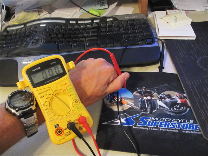

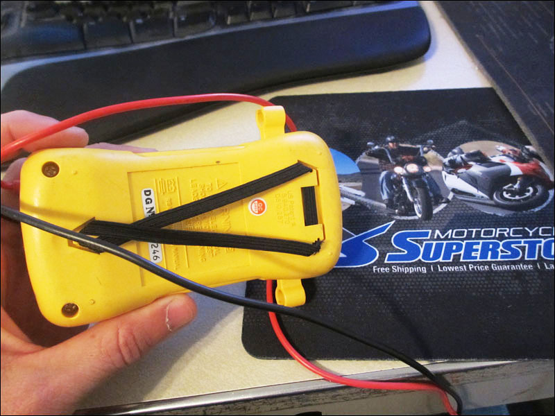

This reminds me that I need to order one of the new fancy auto-ranging multimeters soon. I have a multimeter on me at all times. I have one right on my side at my desk even. It's a cheap one I've had for years - I bought a couple of them as I have to keep one in my truck and on hand in the garage. You can go on Youtube and learn the basics and then some! Forget reading the manual it's all on Youtube. They all did the same thing since the beginning of time but now you have the auto-ranging ones. For most auto mechanic purposes you can use the lower settings all your life. You only need to bump it up in range for the higher voltage situations etc. The auto-ranging ones are great and I highly recommend spending the extra pennies on them. But it's a luxury none the less. Me and my racing and off road friends must carry one in our custom vehicles in case of any failed relays, switches or wiring while out in the middle of nowhere.
I actually learned something while looking at multimeters on Amazon just now. The elastic strap on the back of my unit is not for holding the cables for storage (which never worked) but it's for strapping the body of the multimeter on your wrist while you use the probs to measure your circuits. That made me laugh.
I want one of these to play with. They are $10 less than Radio Shack and probably does more. The numbers look huge too. 316 reviews that give it 4.5 out of 5 stars can't be wrong either! Equus 3320 multimeter
