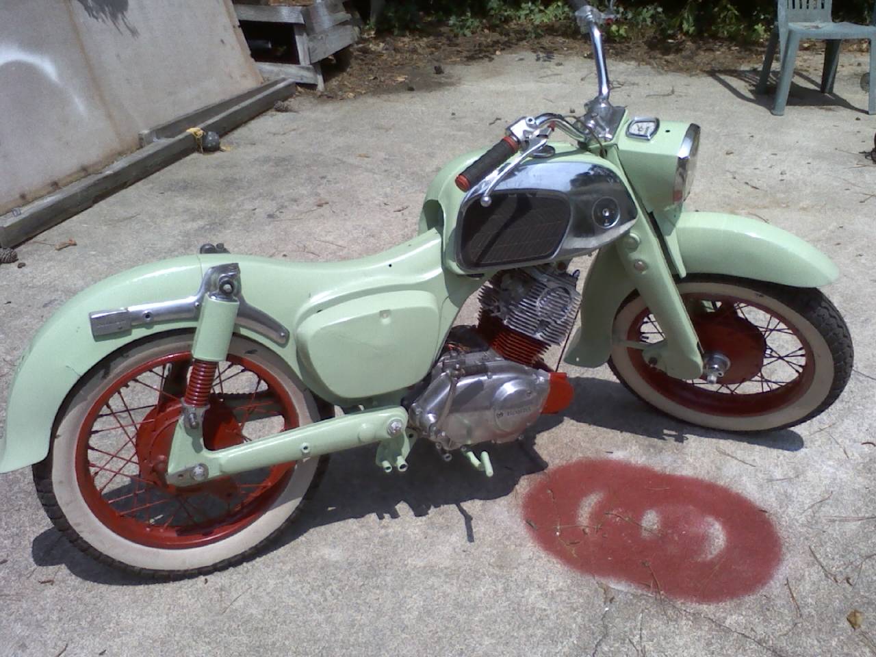

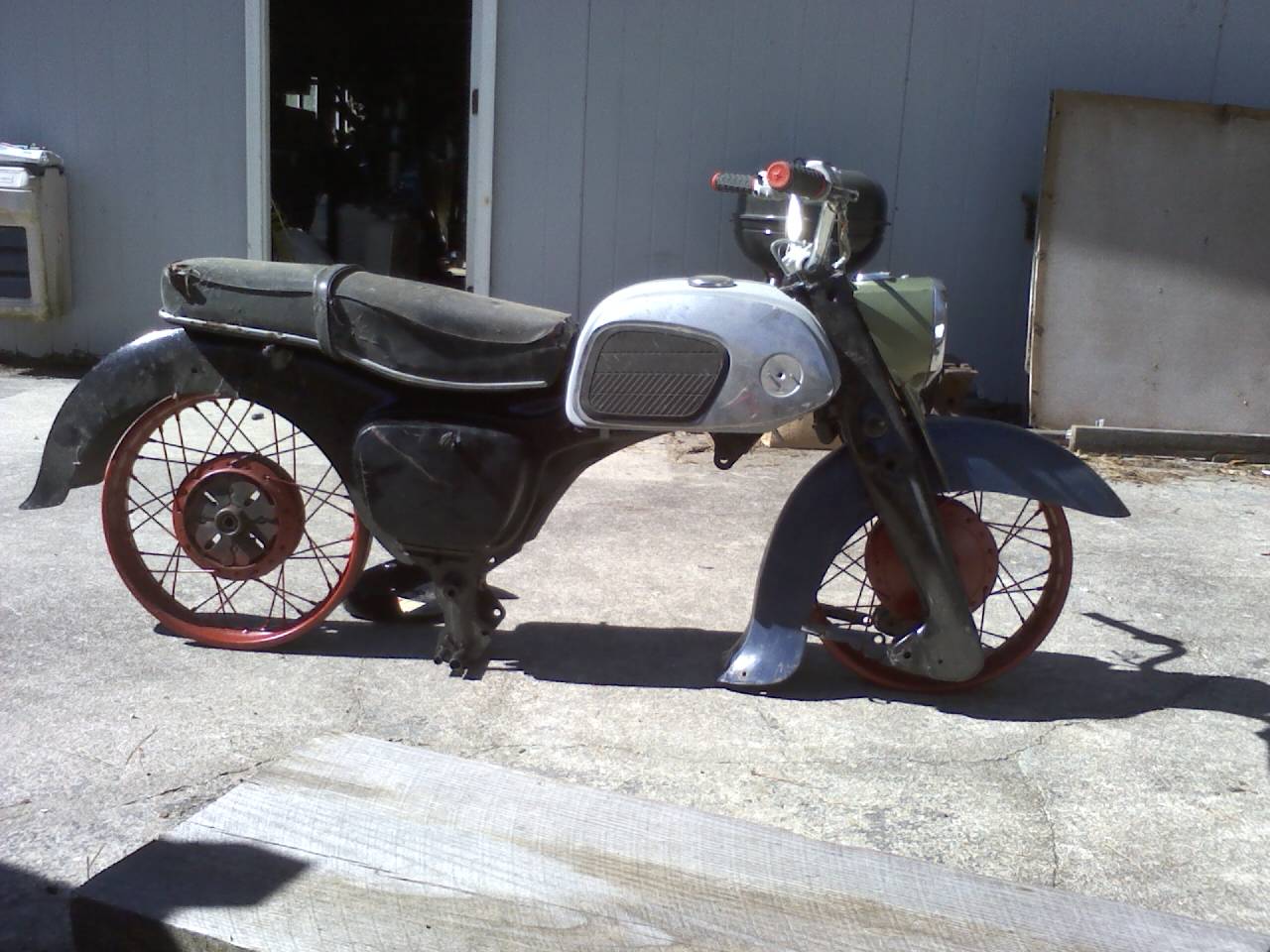

The first picture is roughly what I started with.
The second is where I am at on it now as of today May 31st.

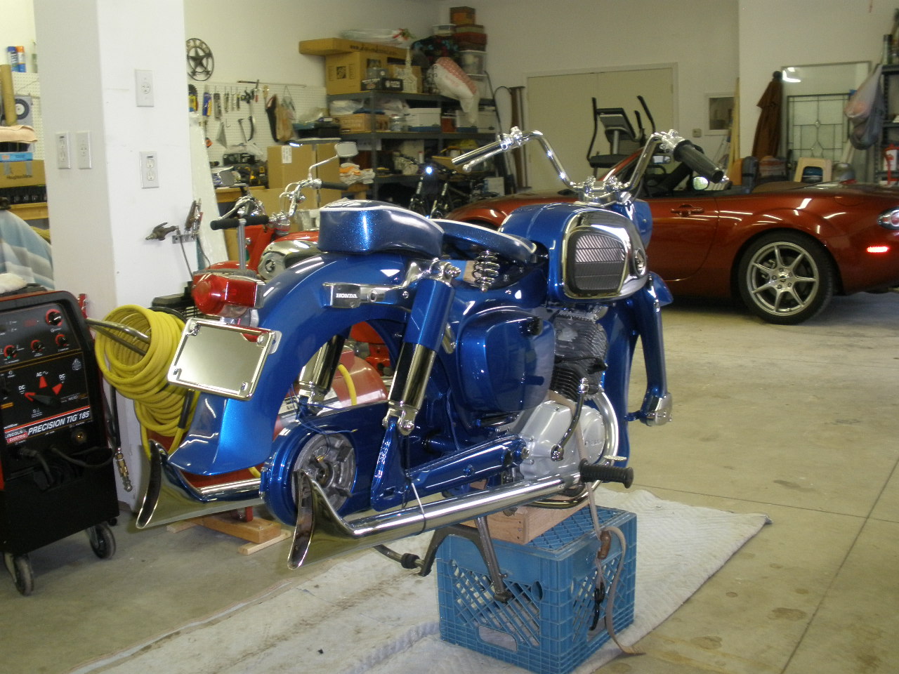

I will be building some straight pipes for my build from scratch CA95. Check my album for pics of the black CA95, it has my straight pipes.
Here's how.
Buy 1-1/2" Electric Conduit. Cut one end straight and the other end any way or lengh you want. I had the pipe bent in a 90 degree and sawed off the end to give that turned down look.
Buy a 1-1/4" to 1-1/2" muffler adapter. The 1-1/4" will adapt the 1-1/2 conduit pipe to the Honda exaust pipe. Buy a pipe hanger to mount the straight pipes to one of the mounts that fit the original muffler.
You can weld the adapter of put a set screw (out of sight) to hold it together.
Here's the kicker! You can polish the conduit to a chrome like finish....
If you dig a fishtail..just adapt the end to fit! The straight pipes sound real cool.
Ain't gonna see more power..But you will be heard!

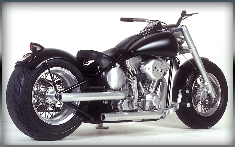

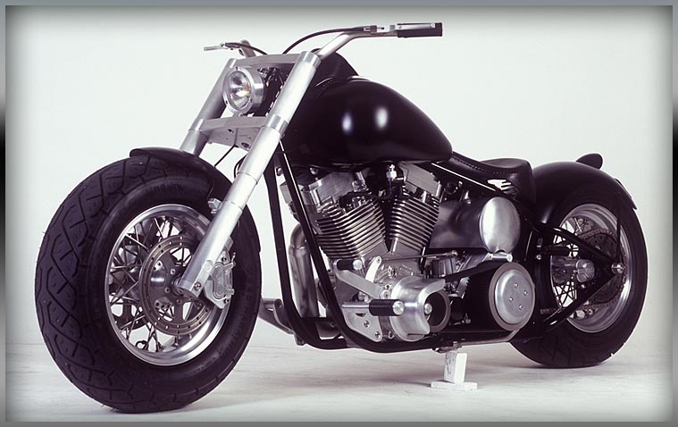

Spokes those look nice, Seeing the thinner pipe on there has me thinking of some fatter pipes, I might splurge on some fat fish/sharktails with glass packs, since I really like beefy looking bikes. Like the fat bastard pictured below.

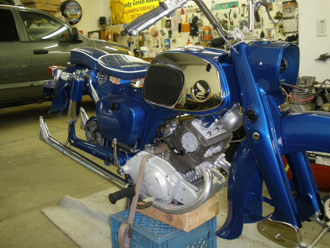

Here are several pic's of my blue bike with Santee Fishtails mocked up . The pipes are 1.75" dia. ,straight pipes ,no mufflers. I'll finish the mounts once I get my wheels back from Buchanan .

The fishes do look nice on it Waiting on parts is no fun, although it does give you more time to think about little tweaks.

Ah that color combo is awesome and good to see something quite different. Exhaust is a very important element of the bikes styling for sure. I was messing around with a set of the exhaust bends that have the flanges on them yesterday thinking of what I should do with them. Fun stuff.
Now polishing electrical conduit... interesting.
