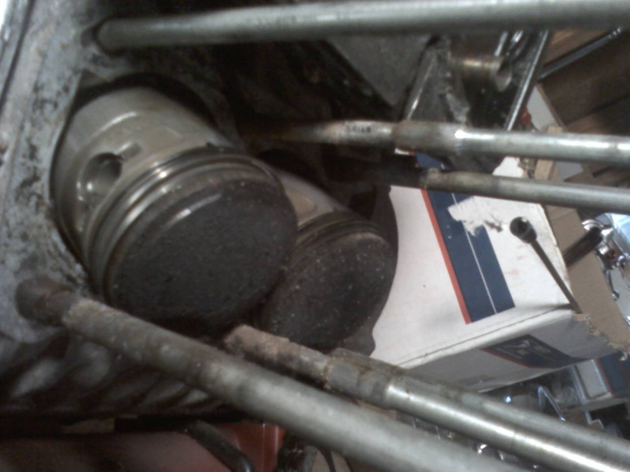

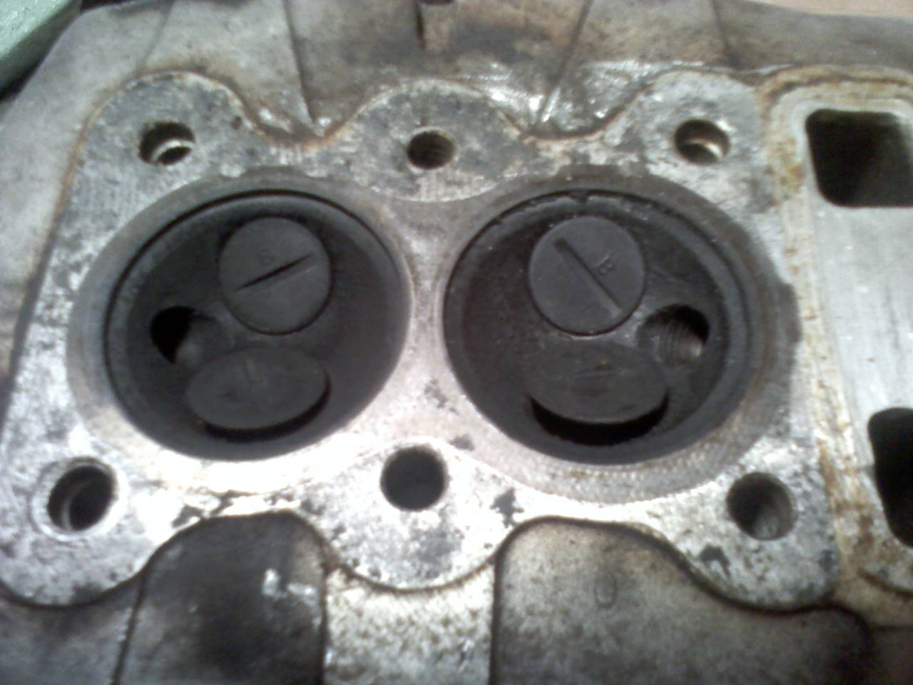

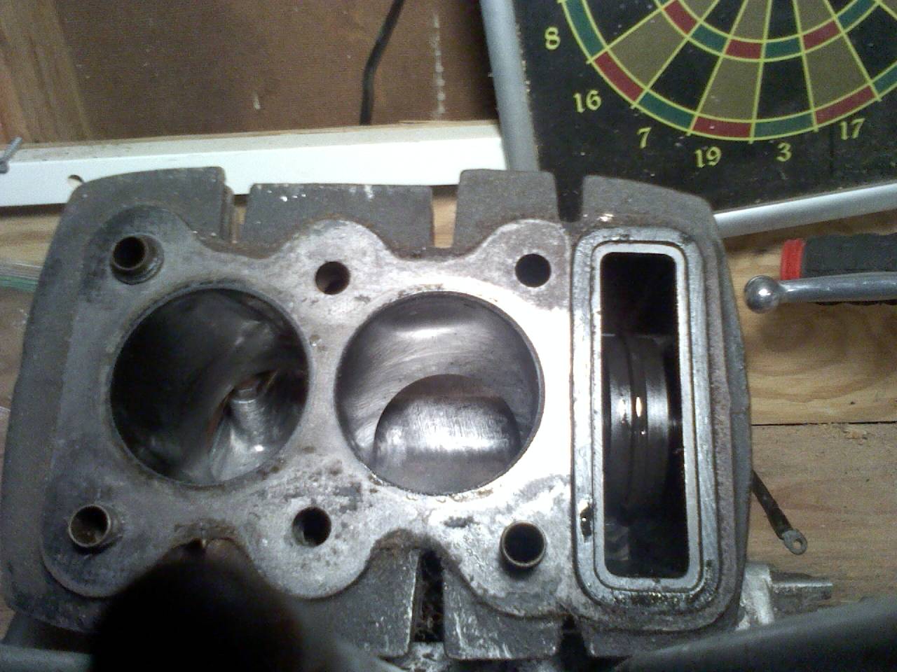

Ok ya got me I decided to crack the head, To see what was going on in there.

Right on. Your engine looks really really good actually. What's your plans for freshening this one up?

Default
For a 63' last ran in about 75' or 76' it does look really good, in fact when i saw what I was dealing with I could have sat down and cried it looked so nice minus the heavy carbon. I did figure out why one side wasn't sealed good and that side of the exhaust port was so black...some numb nut took off one the 6mm nuts down there on the base and put some barely fitting wobbly standard thread on there...thats why one corner looks wonky. I am gonna clean the carbon out, I may go up the street to this cycle shop and see if they do any valve work, I'd do it myself but I may have it bored out leaving room for another upsize or two in case its ever needed, shave a few thousandths off the head and port it...I might as well hot rod it since I cracked it. p.s. put your plugs in before you reassemble so you can get the spark gap facing the intake port, for a nice solid combustion, helps keep them fouling up easily from exhaust gas back pressure too...Oh, I almost forgot, I am going to cut out a section of flange that blocks part of the breather flow too...you know the thin metal piece between the gaskets? That hole falls right on that flange,
thats why i am cutting it out. BTW does anyone know why that thin metal piece is used between the gaskets? Is it supposed to be some sort of weird reed valve?
