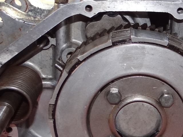

Here's another question I couldn't find an answer to; what is the threaded hole for in the picture below?
What am I missing?

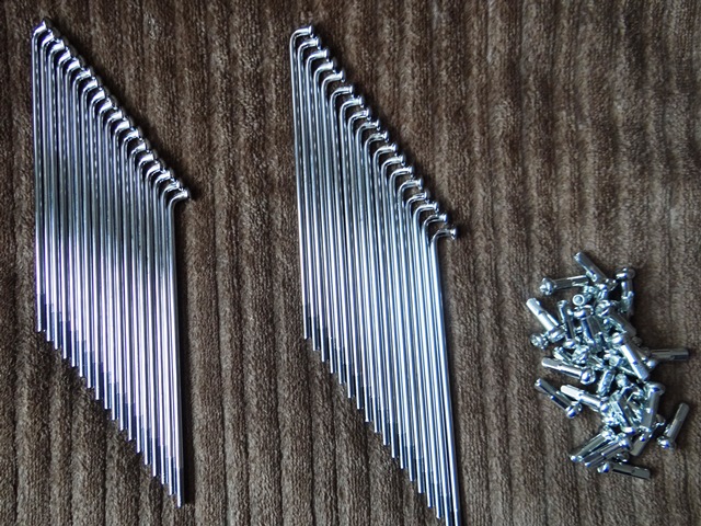

Doug, did you separate the spokes based on the angles of the bend? There are two different bends, and I wouldn't have known that without the video.
From what I can see from my photos, nothing goes in that hole, and mine doesn't appear to be threaded, but I can't completely verify. It's quite close to the clutch basket, so there's not much room for anything anyway.

Doh!!! No, I didnt look at the spokes to see if they had a bend. Back to the shop and intercept these before they try balancing them and putting tires on.
Wish id seen that youtube vid sooner :)
The difference in the bend between the inner and outer spokes is subtle, and for a few of them I had to look closely, but here are my spokes separated for reference.

I believe the threaded hole is for the earlier (?) type of shift drum stopper...
