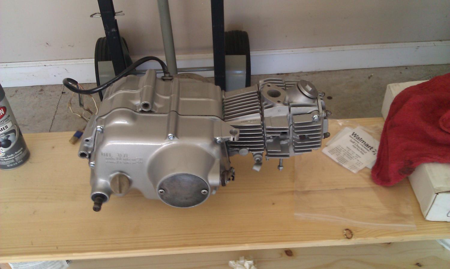

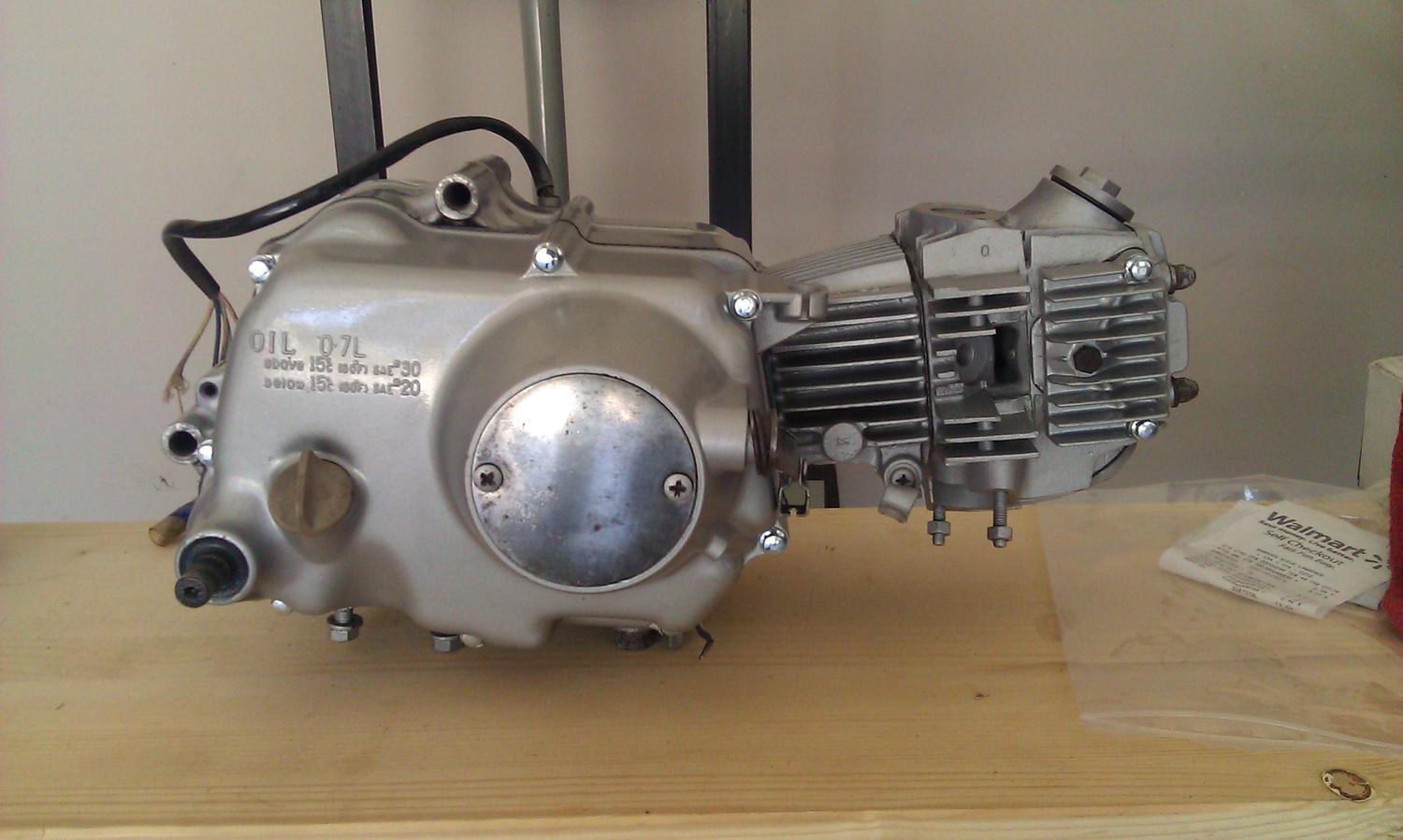

Finished engine
Well i'm almost finished with the engine. I tried reading the manual to put it all back together, but got a little confused so I just put it all together as best I could. I made sure the rings were offset, and the little oil rings were in. I have the cam chain alligned as the book says but I dont know how tight or how much slack you want on the chain. I also dont know 100% that I put that chain roller in correct. I dont think it matters because it looked the same either way.

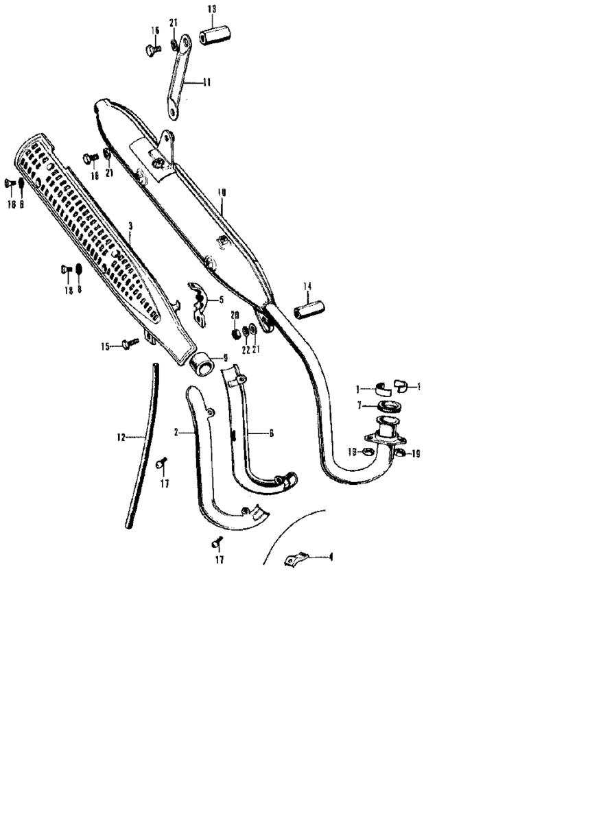

Well I finally got it mounted and it fired up on the first crank. I didnt run it long because the idle was really high and as soon as i tried to adjust it, it would die. I guess I will have to keep adjusting it until it run normal. There is one concern I have, there is burned oil leaking from the bottom of the exhaust right were it attaches to the bottom of the head. I put that metal gasket up in there but there is still a little play when it is snugged up. I also noticed on the image attached a part (#1) but it is not listed in the inventory. I dont know if the oil out of the bottom is something to worry about, or if it is normal because the seal is not tight.

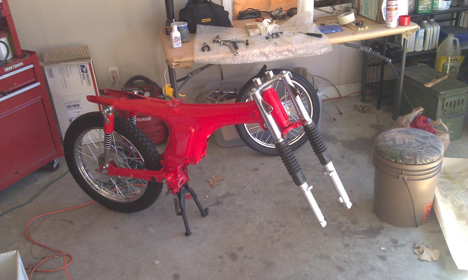

Well I took the engine off and stripped the bike down. sanded the tank down to bare metal and appled some bondo to some small dents that i could'nt pop out. I had car quest read the paint and I have it on file for restoration purposes, but I think I am going to change it up on the colors, the paint alone for the gas tank was $120.00 but that included clear coat..: ( not going to do it, so i think I am going to teach myself how to paint..
I'm back in town now. Looks really good. I've been hanging around a certain body shop a LOT in the last year and have learned the business up and down. I say just paint it yourself. There are SO many instructional websites and videos on Youtube now! You shouldn't have any problems. All the info on how to do it is online and easily available. I just painted the underside of a hood of a truck I have today and it's going on the truck tomorrow. It's amazing how fast the body shop guys do it because they do it day and day out. The fuel tank is a little tricky because of all the curves. I recommend making brackets for the tank mount holes and hanging it up like a turkey on a rotisserie. I've seen pros do this.

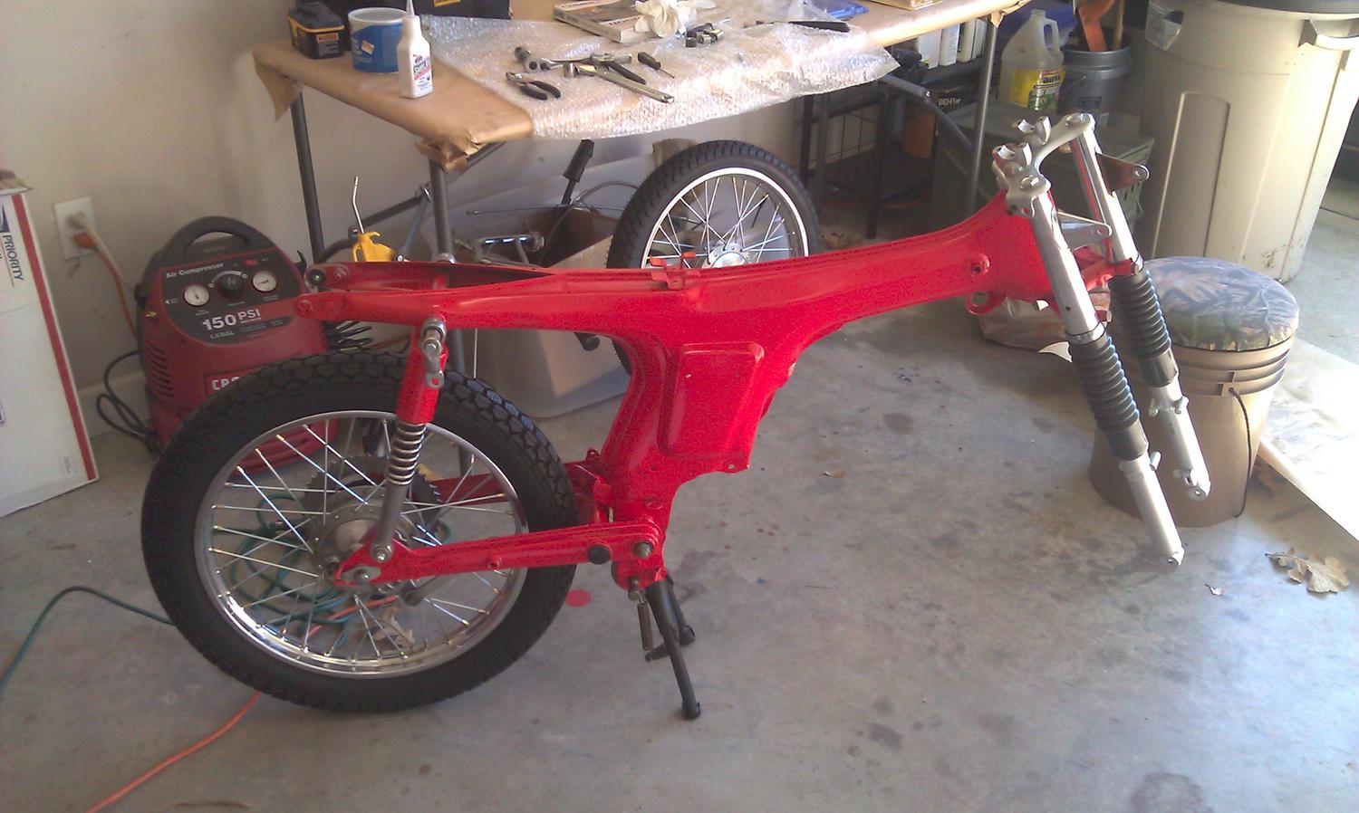

Ok, I was trying to figure out how i was going to do the tank. I stripped the frame down to metal because all of the chips in the paint, i just figured if im going to go through all this work, i may as well do it right. I found a nice bright red that im painting it, and silver for the tank. I will post some pictures as it comes along. So I was wondering, the front forks are pretty haggered and one of the springs is about shot. I found a rebuilt kit with springs and seals for 30 plus s/h but the rods are pitted up pretty bad, i also found new forks for about 85 delivered. I would think if the fork rod is pitted up really bad, then they probably wouldnt work that well.
I also bought the spokes on ebay for $29, and they are very nice, my weels look brand new, i also ordered a new front tire from Dennis kirk for $16 and inner tube. They have the best prices for tires that I have found, and fast delivery.
