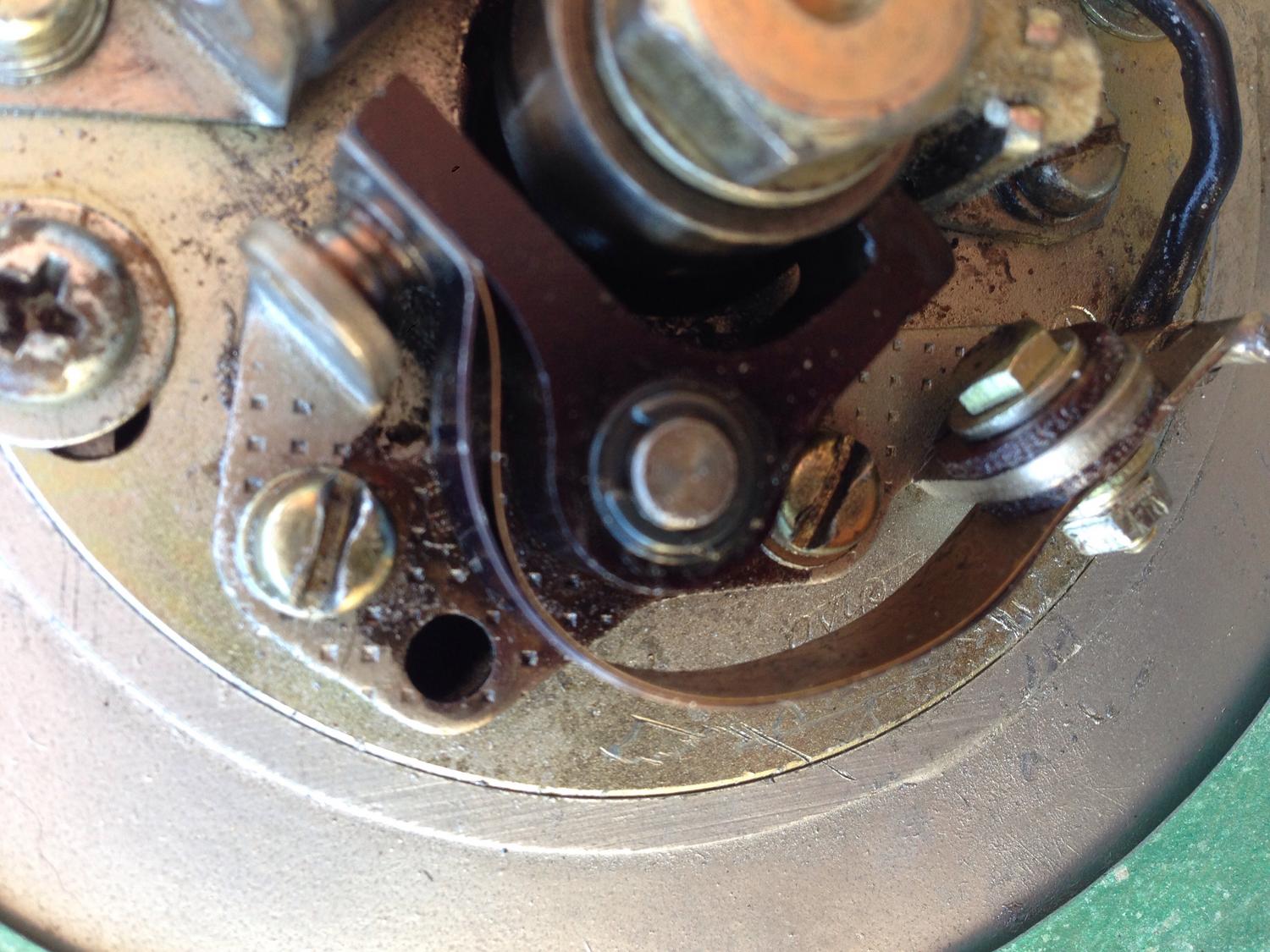

my points plate is missing the adjustment screw for the the points that the manual says to screw in and out to adjust. There are no threads in there. I just loosened the large screw and put a feeler in there for the right gap at the high point on the cam, then tightened it down. Is this ok? I don't think I need that screw, do I?
There is supposed to be a screw with a small cam in that hole. You would loosen the points and turn the (missing) screw to open or close the points.
I don't think you need the screw now, but if the points go out of adjustment quickly, I would replace the points plate. Good used point plates are available on eBay.

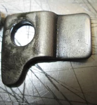

I also found this plate in my parts box. On ebay it says it's a starter gear hold down. I dont see it on the diagram. Where does it go?

The bracket mounts to the engine case outside of the starter gear, behind the flywheel.

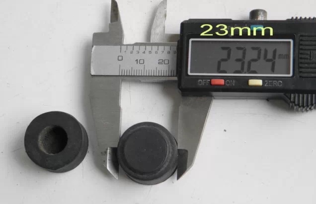

Chip, I bought w spare fuel tank off of ebay listed for a ca95. Primarily for the emblems in decent shape. It has the 150 emblems, the late style knee pad and side cover. But it's like a tank from your post a couple years ago. It only has the rear two mounting points and a spots for slide on bushings in the front frame channel. You said you thought it was from a CS92.
I found these bushings on eBay for a CA110/200. I'm going to measure some but it seems odd for a tank to have the correct side covers and badges, yet different mounting. Possibly C95s had this type of tank that mounted on these bushings in the center hole of the frame? Michael Clark mentioned to me that his mounted with "early" mounts. Any ideas about what years or models this was done?
Sam may know more about the tank mount configuration on the C95 & CA95. It seems to me there were different Benly models produced for different countries. To make matters more interesting is many guys returning to the USA from Viet Nam brought back Honda's as well.
