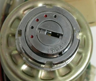

The key showed up for the ignition, it worked! Again... thanks for the tip on where to purchase NOS keys!

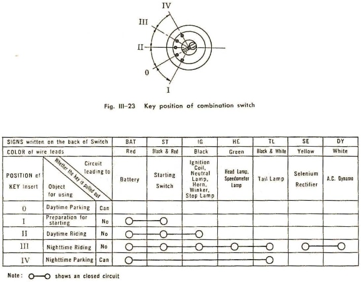

I'm guessing not all five of those indicator marks were painted red and will research what colors those dots were... also what the positions stand for.

These key switches are needlessly complex, serving as the headlight/tail light switch, too, among other things. Here's a picture of my switch, along with a shot of the manual that describes the settings. The colors of the switch dots aren't important, but rather the positions are. 2nd dot from the bottom is 'off', moving one dot up is the regular running position (with no lights), etc.

BTL... that ignition diagram is great... very helpful, thank you.
