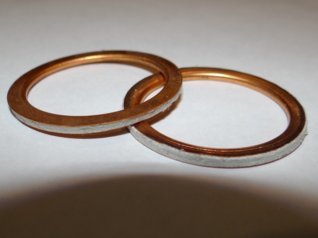

Sam , I was looking and the spare set of exhaust pipes I have for my BMW K 100 build are slightly larger at the flange where it enters the head than the CA 95 , but the gaskets are copper and may work . I've ordered a bunch of parts for the engine including the exhaust gaskets . They should be in next week , I'll try one in the spare motor I have . Never know they may fit .

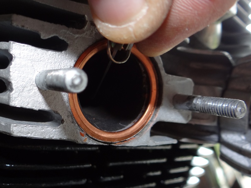

Grubsie, I bought a pair of those Ducati copper exhaust gaskets. My first chance to install them will be Saturday morning, but I'll let you know how they fit and seal.grubsie wrote:How about these? Not cheap but could work. 37MM OD.

I know this isn't the sort of gasket-crush forensics that Sam was looking for, but here's a shot of the Ducatti copper gasket in my Honda CA95 exhaust port, just prior to installation. I'm holding it in place with a pocket knife for the picture.
Seems to be an excellent fit. Using the hand-around-the-pipe test, I could feel no leaks. I can't attest to the crush dynamics of this copper gasket, but it sure seems to work.
