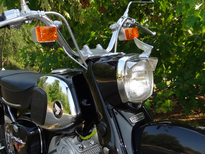

I was pleased to get the turn signals working. Funny, the front/rear signals were labelled specifically as '6V', but of course the Asian sellers filled the sockets with 12V bulbs. I went to a Carquest parts store about 20 miles from my house (that's considered 'nearby' up here) and the guy at the counter took me in back to help him sort through old boxes of bulbs. We found a box of seven 6V bulbs in just the right size, so I bought the whole box. I now have 3 spare bulbs, and the signals work great.

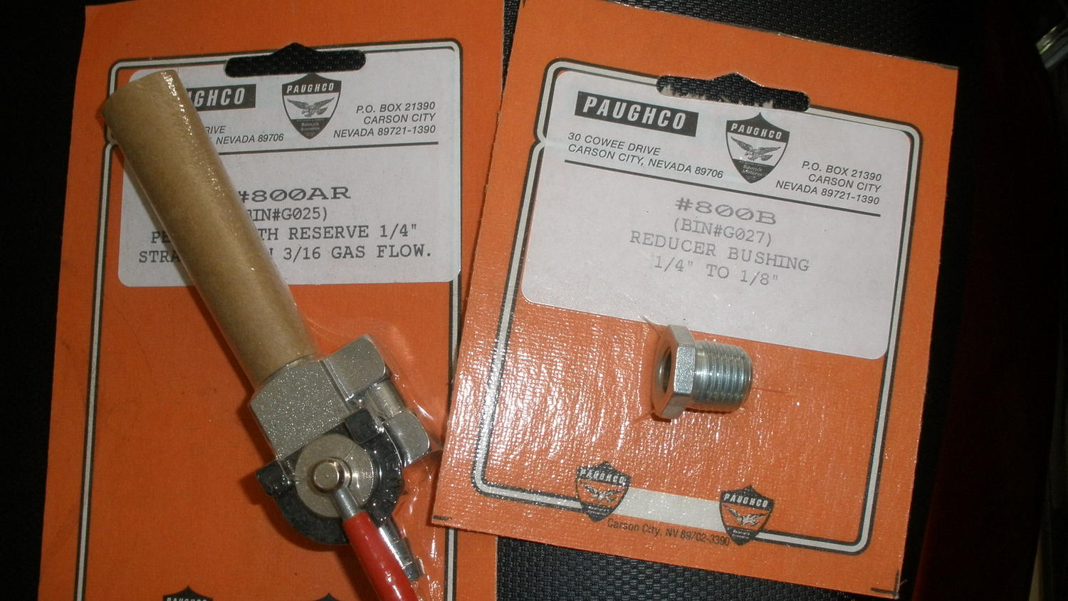

Jet black , your bike is looking great . Leaks ,that's always a fun thing to troubleshoot. I use tank adapters on 2 of my bikes and use a Paughco petcock- 1/4" npt pipe thread to the adapter and it has a 1/4" outlet to the carb . Normal 3/16" fuel hose fits the carb and will easily slip over the 1/4" petcock fitting .
Kartgreen, thanks for the info. This morning I ordered the adapter and the petcock pictured below, figuring I'd stick with a 90 degree right facing outlet. Next weekend I hope to put this little episode behind me and move on with the build.

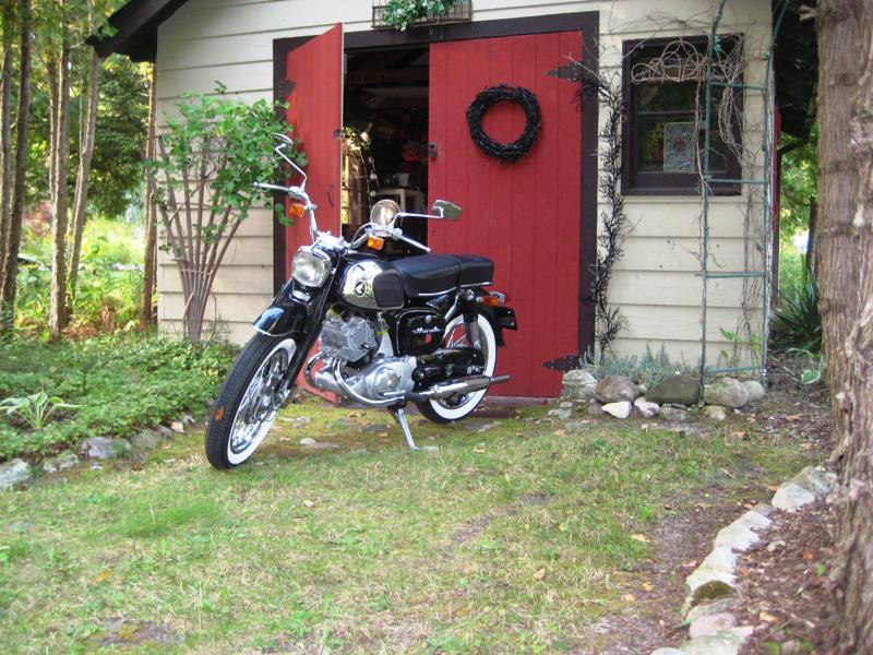

Ok, I'm all done. Well, there's always something else to adjust or tweak, but today I took my maiden voyage in my 1965 Benly.
Before I go any further, I absolutely must thank the gang on this forum for all the advice and tips. You've all contributed to the project through your advice and suggestions. Thanks so much.

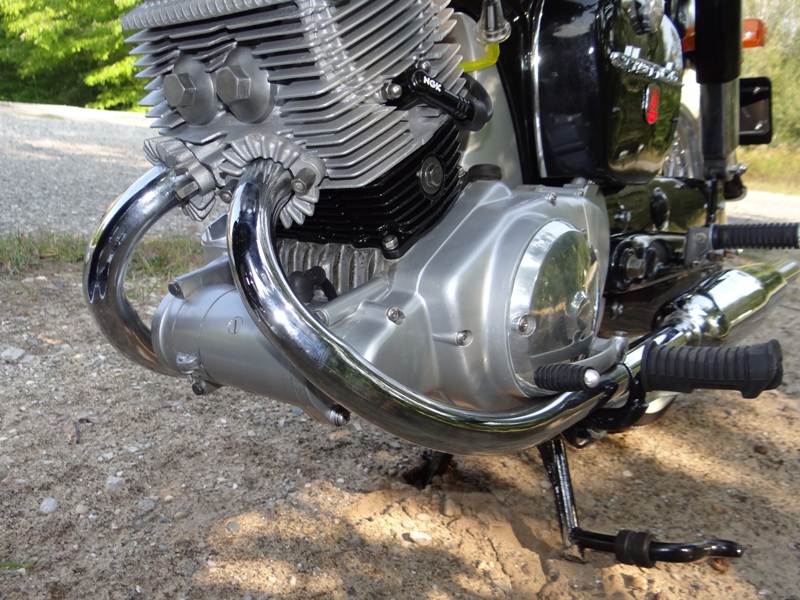

Today I rode 23 miles on the Benly, taking the bike to visit my parents. You're never too old to show mom your latest project, right? The bike ran quite well, and shifted through the gears without issue. I do need to have the front wheel balanced - the rear was balanced previously. The exhaust is a bit loud up front, so I'll need to examine the gaskets. Otherwise, it's a pleasure to ride, and more comfortable than I expected.
I've absolutely got to swap out that ugly yellow fuel line with something more fitting, either a black rubber line or a nice braided metal-covered line. Anything but that yellow.

What an absolutely stunning bike. How's she ride? :D
Sam Green
Post by Sam Green »
BTW BTL, stunning. :cool: :cool: :cool: :cool: :cool: :cool: :cool:
Sam. :)

  • The exhaust is a tad noisy up front, so I'll need to pull those cheap gaskets that didn't fit and replace them with something better.

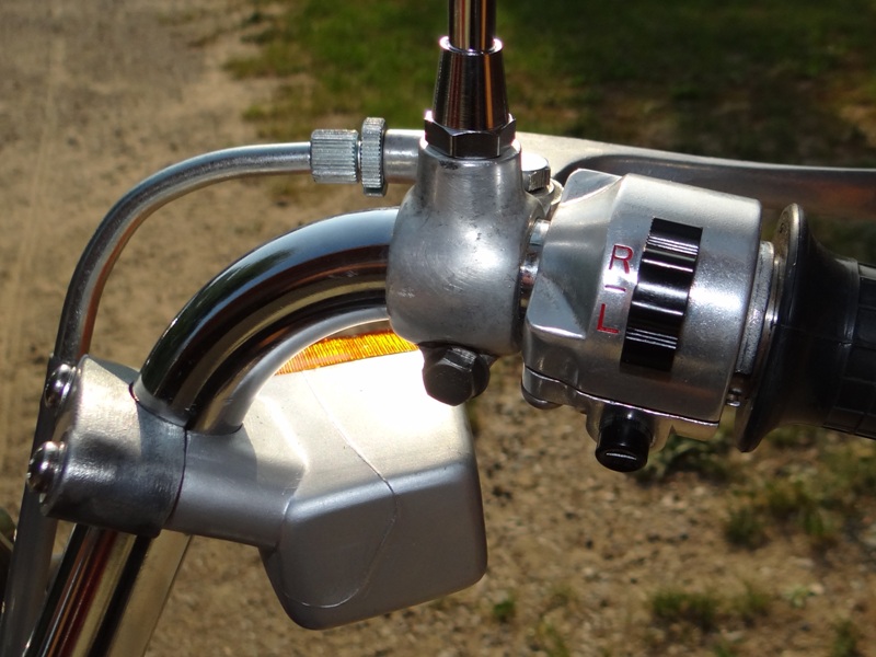

  • Turn signals work great, but it'll take some time to adjust to the "up for right, down for left" orientation and the use of the right-hand switch instead of the left hand for turn signals.

Awesome BTL. The bike looks great. I like most of your "custom" touches especially the trim on the fenders. Looks real good with the black.
I have to applaud this group. There are more projects completed here than any other type of hobby I follow. Car projects take years, some aircraft projects a lifetime, most never get done. Here there is something new every few weeks and it never gets stale or boring.
You guys are the best and show the rest em how to "Get Her Done"!

Beautifull restoration with some very tastefull additions ! Should be a head turner where ever you take it . The picture of your bike in front of the shed is classic .
I always get told I look like a circus bear when I ride mine , maybe I should invest in a Shriners hat ! Anyway , just a gorgeous restoration , so, what's next ?

If the pic was taken from the ground level up (or close), you would look the right size on the Benly........not saying anything other..........
Your resto is impeccable............
1911tex wrote:If the pic was taken from the ground level up (or close), you would look the right size on the Benly........not saying anything other.
My mother took the pic while laughing hysterically at how I looked on the bike, so she wasn't very focused on composing the shot. :D
I'll have a word with her.

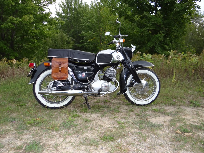

Ok, a few final pictures and I'll leave this thread alone. Today I decided to mount those '60s leather saddlebags on the Benly. I like them! I think I'll leave them on.
