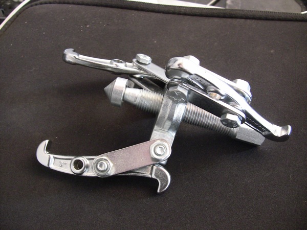

My extractor tool has three legs with hooks on either side that can be reversed. I understand how the thing works (screwing the bolt in pulls the magneto out) and all but what I dont understand is how the extractor tool "hooks" the magneto. There doesnt seem to be anywhere to attach the extractor legs to the magneto.

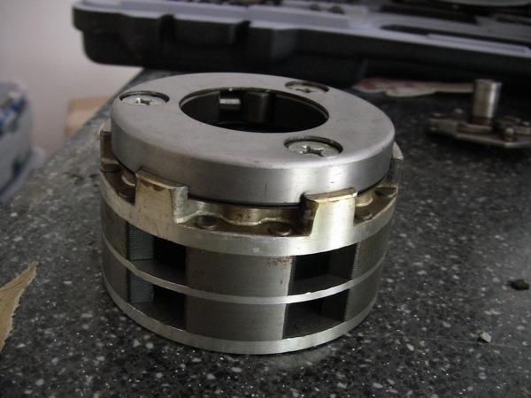

If memory serves, the magneto has 3 circular plates with the stacked magnetic plates sandwhiched in between. I think I got mine off by hooking onto a combination of these plates. That said, I bought a small gear puller which ended up not working because as it tightened, the arms hit the top of the magneto and forced the hooks out and off of the part I had grabbed. I ended up using a puller that was substantially larger than I expected to take a bite.

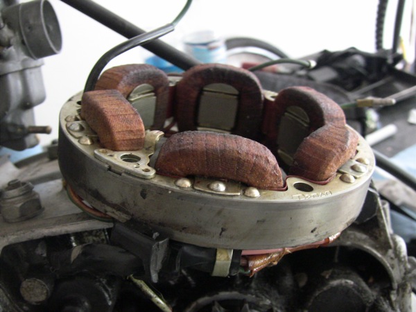

In Smithers first picture you can see the plates I am talking about. You have to take the coil off first. This might be a little awkward, but once you take the retaining bolts off, you should be able to just work it off by hand, or with a little help from a hammer. Once you get a crack between it and the case you can get a screwdriver behind it. The tricky part is that the magnet will grab the coil as you wiggle it.

The first one is of my extractor tool. It has some very "broad" hooks and they seem impossible to hook anything.

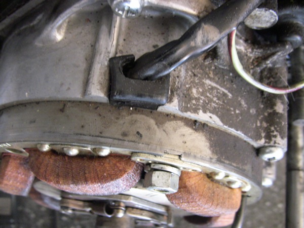

The next Picture is of my magnetos edge. I think I can see those layers rob was talking about in this picture. I suppose I will just unbolt everything holding the magneto in place and then try and work a flat head screw driver in there to make room for my hooks. I cant imagine how a hammer would do anything to help me in the beginning seeing how there is nothing to hammer that would push the magneto out. http://www.fourwheelforum.com/attachmen ... 1250094885

You will need to take the coil off before the extractor will help you much. Take the bolts off that hold the coil on. There should be a few. One is a nut on a stud which I can see in your picture. Then tap the ring just a few times with a hamer, preferably a rubber mallet if you have one, around it until it works a little loose. Then you should be able to get a screwdriver down in there, probably close to where the wire goes in, maybe even by squishing the rubber grommet a bit and working it around. That coil comes off first though.
Once the coil is off, you will see the 3 plates and you can get the extractor on there.
The part with the screws in it won't come off. There are basically 3 parts. The coil (the reddish packs of wires) and the ring being held in by the bolts, the magnet itself (the small circular part in the middle that turns if you crank the engine) and the cover that is held in by the phillips screws.

Oh yeah totally, take that coil off and move it to the side like this:

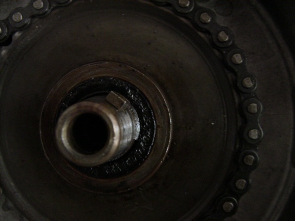

Here is what the magneto looks like removed... and the starter clutch is right behind it. Don't lose any of the little parts that are enclosed in the starter clutch. Hopefully they are in good shape and you don't lose any!! They are hard to get. There is a spring behind each roller so they WILL try and come out. And there is a key that the magneto slides onto. It is crescent shape. MAKE SURE you locate this as soon as the magneto comes off. Life will be miserable for you if you lose any of this! Buy a box of Zip Lock bags. Those things are the best to keep things in order.
Here is what you will see behind the magneto. Make sure and grab that key so you don't lose it! And notice the shape of the crank end is in a cone shape. This means that the force of the main bolt will make the magneto clamp down on the cone shape crank... and hold it super tight. So they are hard to pop loose. And that crescent shape key makes it very difficult to put back on. But once you have done it your next one will go 3x faster! That's the only good news I can give you, sorry.

Hey guys. I had to be brave cranking down the puller. When I tightened it enouph to scare the heck out of my self I gave the puller a soft tap and it all came out. One roller popped out but I got it back in. It was the most exciting thing thats happened all day. One problem I had was getting the puller to pull with all three legs equally, no matter what I did it always pulled crooked.
