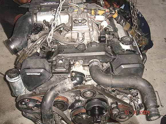

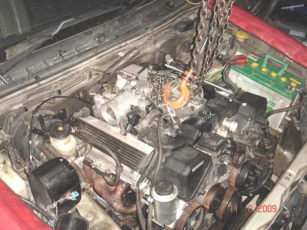

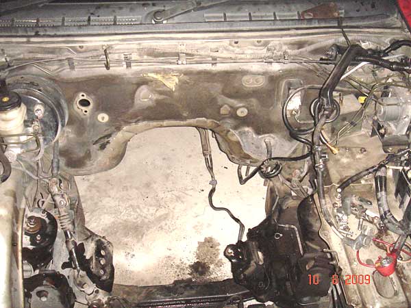

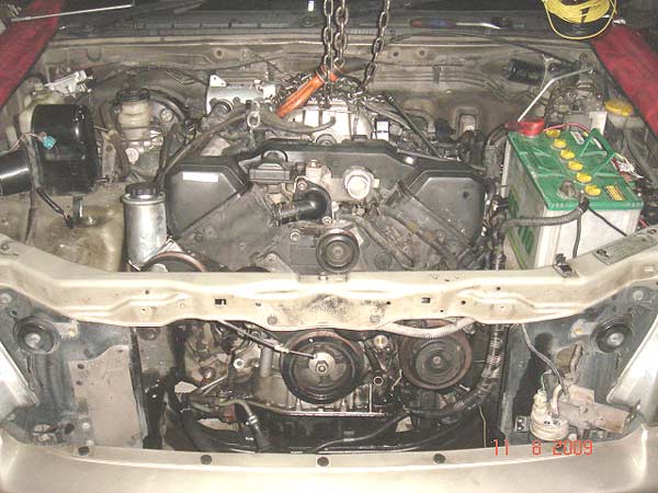

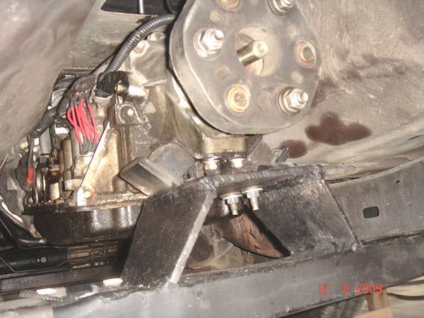

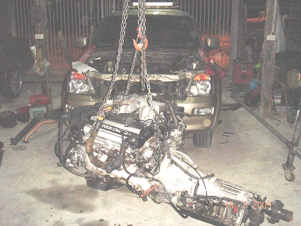

:cool: I use the car ISUZU D-MAX + 1UZ + GAS LPG + 2WD.
:rolleyes: I would like advice / explanation about the 1UZ-FE.
1. The size of the intake appropriate to the size a few inches intake.
2. Typically, the heat of the engine about a few degrees.
3. Exhaust pipes should be separated or combined pipes.
:D Thank you very / disturbing advice.
>>> My car / place the 1UZ by Thai from Thailand.

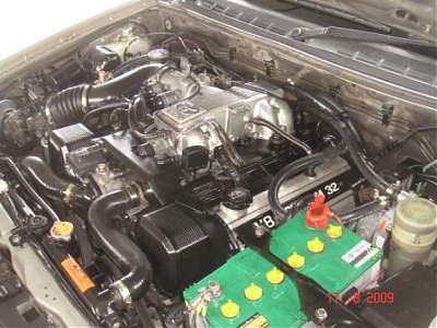

boy_uz 04-20-2010 07:40 PM
5 Attachment(s)
:p Picture for more...

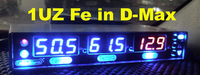

-- Final image. "The measurement of heat" Temple of heat directly from the radiator.
And measure the heat from direct.
-- Measure and charge back the power of Matrix Partners.
** I use the English language. "If I use the language incorrectly sorry.

Heat really isn't an issue. Just hook it up and run it. As long as you hook up some decent size radiator you won't have a problem. I don't even run the fan on mine. I will use a switch when I go off-road and in the sand.

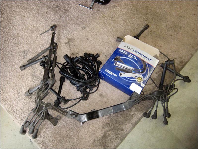

Just use your Toyota radiator and you will not have a problem.
And use the spark plugs and spark plug wires that came with the engine.
I returned the new spark plug wires to the store. I didn't use them. They were too short. The stock Lexus wires are just fine.

>> Spark plug cable and set to use the Lexus for ??
- Set price and about how much
- I want to replace all 10 lines / interference advice.
-- Spark plug cable, the picture attached, or not available / price / set much.
Thank you very much.
