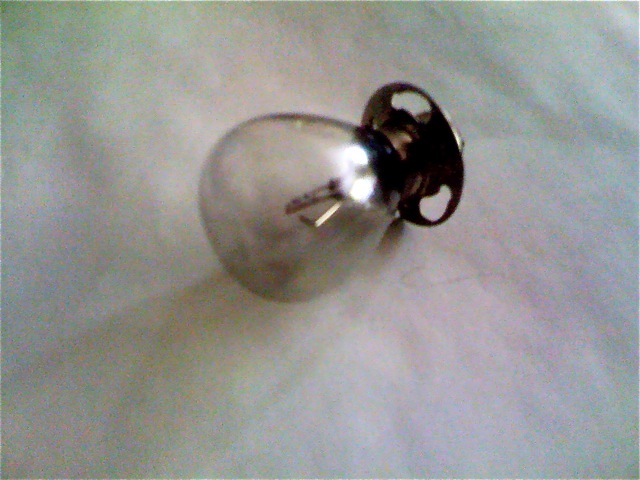

Hotdoggin' 08-01-2009 09:10 AM
CA95 Headlight Bulb
1 Attachment(s)
Any idea where to find this bulb 6V 35/35 Bulb?
Can't seem to find

All I have is 6 volt high low beam bulbs to fit the socket of replaceable type headlights for the CA95. Getting the bulb out of the sealed beam housing is challenge. I have done this by sacrificing one old headlight for its body and the other for its lens. The bulb can be unsoldered and released. You can set another 6 volt headlight bulb in the housing with epoxy and wire it up. I have a new lens for the sealed beam type somewhere in my shop as well.....

I have used the Tiawan headlamp on my previous CA160 Project. Other than needing a bright light indicator wire and the headlight trim fitting a bit tight, they work OK. If I need to replace the original lights I have, I will order the Asian replacements.
Any 6 volt headlight bulb will work in the headlamp. The VW one should work just fine. Below is a pic of the Stanley bulb replacement for the non sealed CA95 headlamp.
http://www.fourwheelforum.com/forum/...&pictureid=493
