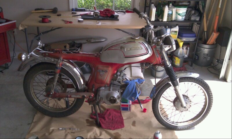

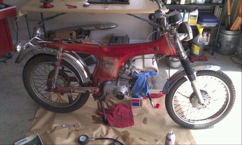

2 Attachment(s)
here are a couple pictures. I am still finding so many things that need fixing, I guess I should expect that with a bike that has been sitting for 20 or more years. I broke the exaust valve tappet or cover and was wondering if that being missing would affect the compression test.
Smithers 09-21-2011 08:10 PM
Uh oh that doesn't sound good. If you take off the caps so you can see where you can check the valve clearance - then you can see if the valves are moving I suppose. The bikes engine would have had to be severely beat on in order to hurt it. They are so tough you would have to purposely take the oil out of it and run it to damage it.
I think the thing you said you broke is just the round cover that screws on and off to get to the valve train right? That won't have any effect on compression. It just keeps the oil in the engine and the dirt out. I wonder if maybe someone ran it without the air filter on and got some dirt or something into the engine causing damage. If the engine sat fro years and years there might be some rust inside but if it's turning over freely it probably is ok and not so bad. I wish I could give it a look up close for ya!

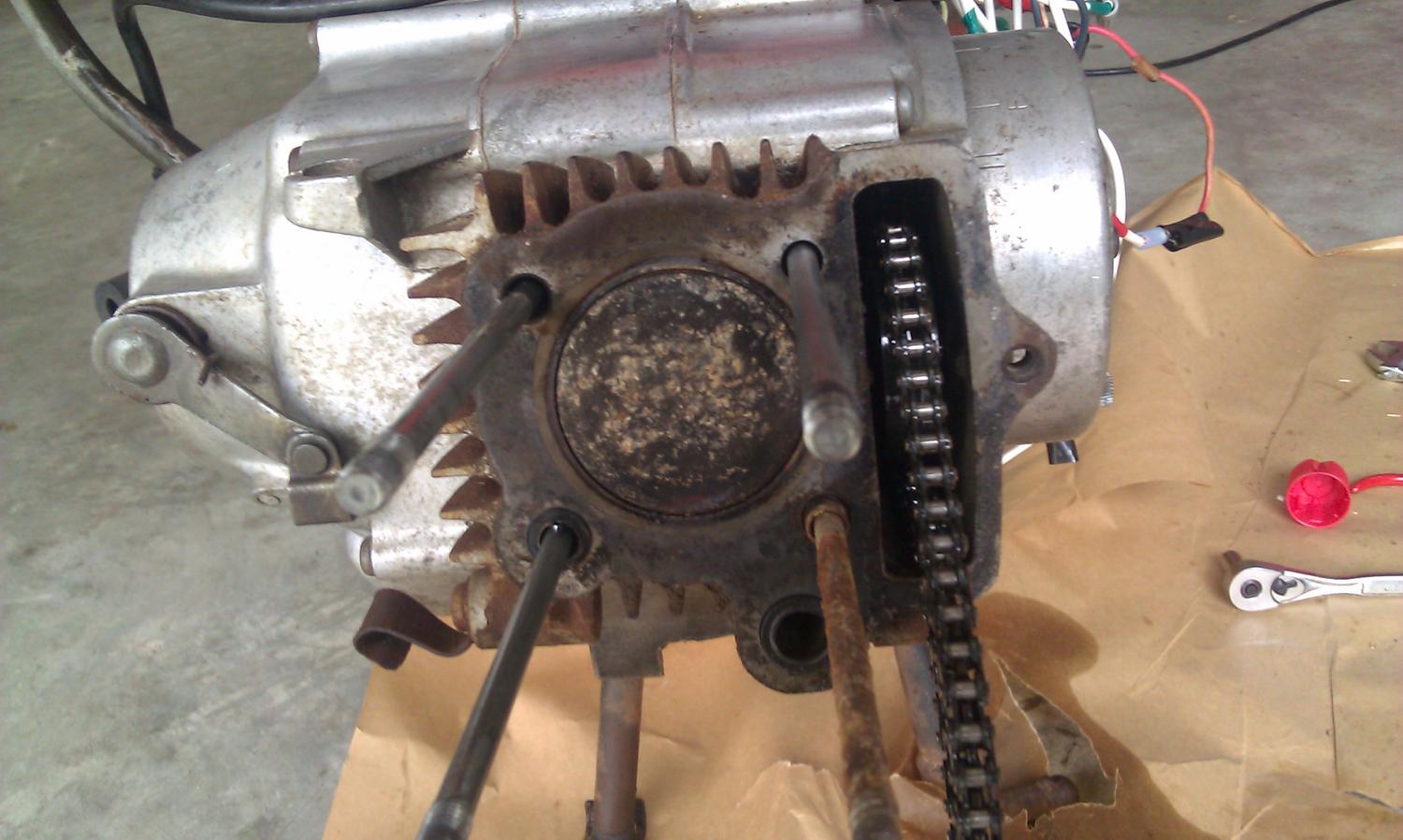

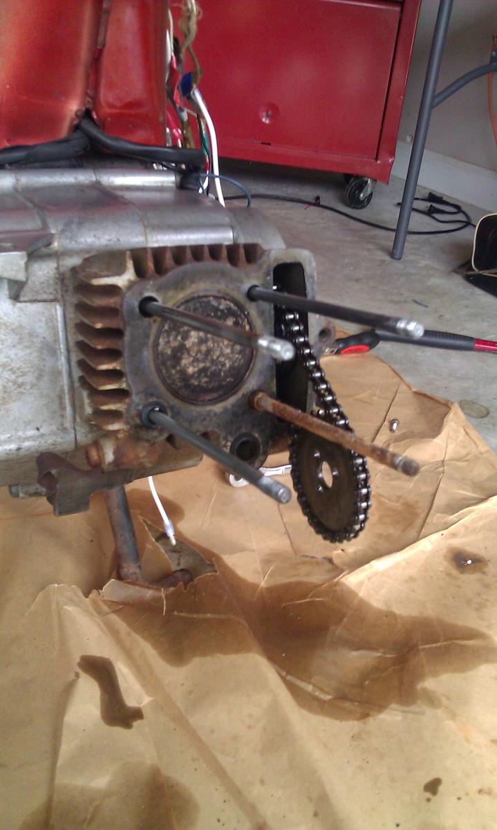

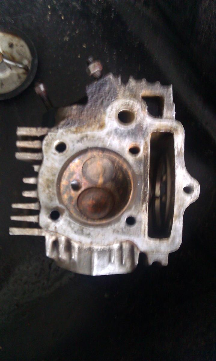

3 Attachment(s)
Well I removed the head and it looks like it had been sitting in poor conditions for all those years. Here are a couple pics of the head and top of the piston. My question is, do I just buy a new head assembly ready to bolt on or rebuild this one? and what about the piston and rings, can I get away with getting a standard size piston? probably need to measure it first. Probably looking like a total re-build.
Smithers 09-22-2011 06:31 PM
Not TOOO bad. Just need to have the machinist clean up the cylinder and head. They can hone it out to get the cylinder walls clean then measure it and give you their opinion. I can't tell the condition of the cylinder walls so I can't take a guess at if you need a 1 or 2 size over piston and ring set. This is easy stuff for any machinist that does engines. I would probably just "lap" the valves in with a hand spinner thing and some compound and put it all back together.
Just keep all the original parts as much as possible. I've fixed worse than what I see in your pictures. Shoot you could probably just hone out the cylinder yourself with a drill and ball hone - and then just re-use the piston with some new rings and be on your way. Just lap those valves in while you have it apart and make sure the guides and valve stems are operating smoothly. Put some synthetic grease on them while assembling and get that show on the road. :-)
