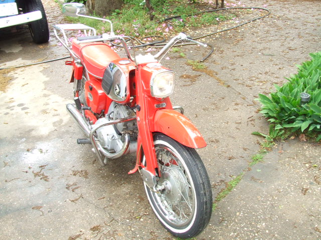

My Benly Running
1 Attachment(s)
My mostly origional Benly. Replaced headlight switch, have a new front tire , left grip and mirror. Also drive sprocket.
Smithers 06-03-2011 07:03 PM
Where did you get that front tire might I ask? So now you are waiting on a new drive sprocket? I can't believe that one broke. Maybe you can take a link out of the chain and continue to use it?

ben1942 06-04-2011 06:37 PM
The front tire is origional and is very dry rotted, took the sprocket from another Benly that I have. I have a blue Benly that I'm going to do next as soon as I sell this one.
Smithers 06-05-2011 10:20 AM
I was going to be shocked if you found a replacement tire that looked exactly like the original. :) I have my original tires on my CA160 and I won't change them. Nothing looks better than the original style tires!
