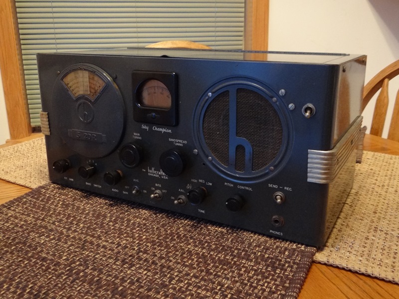

Some of my fondest childhood memories are of the holiday gatherings at my Uncle Walt’s and Aunt Eleanor’s house on Nottingham Street in Detroit. The strong scents of roasting turkey and ham got stronger as I ran down the curved basement stairs to get my holiday hugs. My attention would quickly shift, however, to Uncle Walt’s Hallicrafters S-20R short-wave radio, standing just above my eye level. It certainly didn’t look like any transistor radio I was familiar with. This unit had tubes, and took a minute to warm up before gradually revealing people speaking strange languages. To me, this radio was magical.
Hallicrafters made radios in Chicago starting in 1932. Based on the serial number of Uncle Walt’s unit, this specific radio was likely built around August of 1940. It’s interesting to compare 73 year old electronics with the modern semiconductors in today’s devices. Fortunately, I have the necessary schematic diagrams and tuning manuals to guide me. It’s interesting to see the tubes inside the radio, and I’ll likely have to replace a few of those, but the real work will occur under the chassis, where most of the original electronics will need to be replaced.

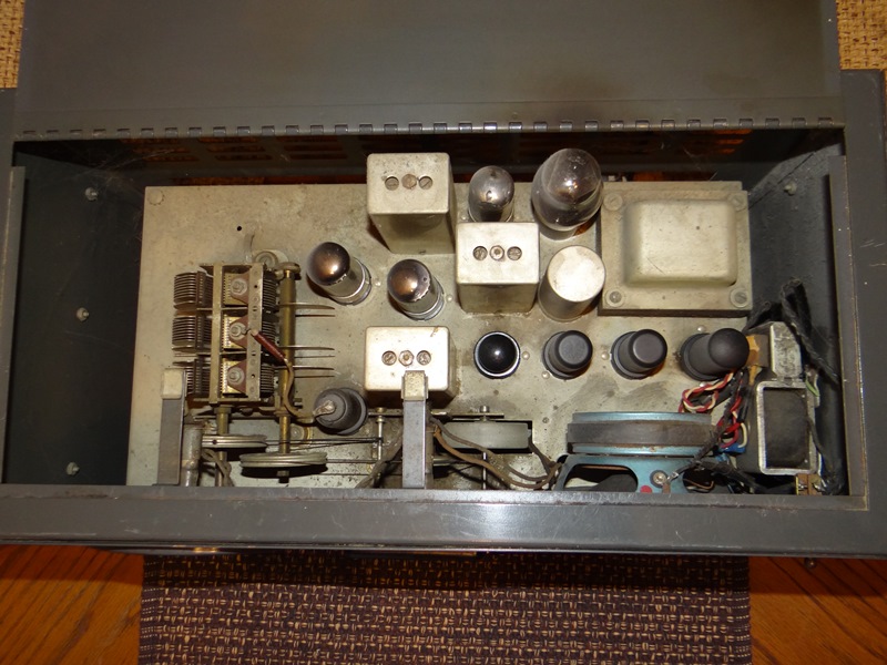

A view of the interior from the top:

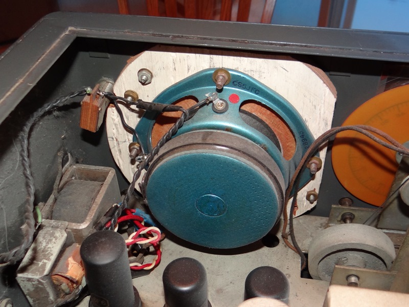

This speaker mounted to a hunk of plywood appears to be non-original and will be replaced:

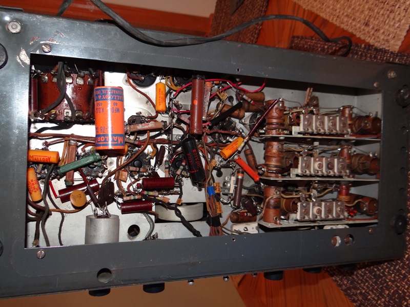

Below the chassis, most capacitors will be replaced

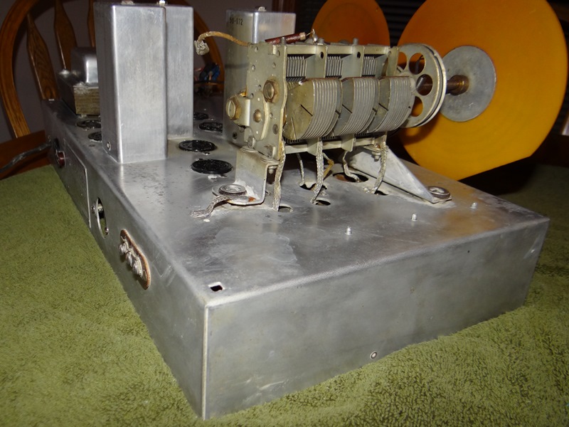

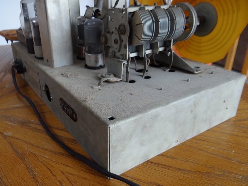

The 1940 Hallicrafters radio restoration project has already been quite interesting. Like an old motorcycle, old radios were often modified by their owners, and this radio was no different. The toggle switch at the upper right of the radio was added at some point. Other wiring modifications were made to the rear of the chassis. The radio case can no longer be considered “original”, but that now frees me to repaint the unit. I’ve ordered a set of reproduction lettering for this exact unit, and will sand, prime and repaint the unit in the original color. The hole that was drilled in the case for the non-original toggle switch will be filled with an epoxy to return the case to its original appearance.

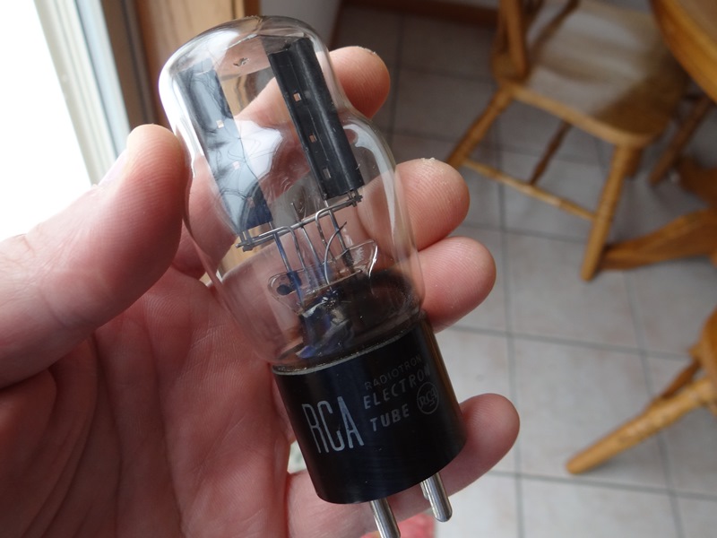

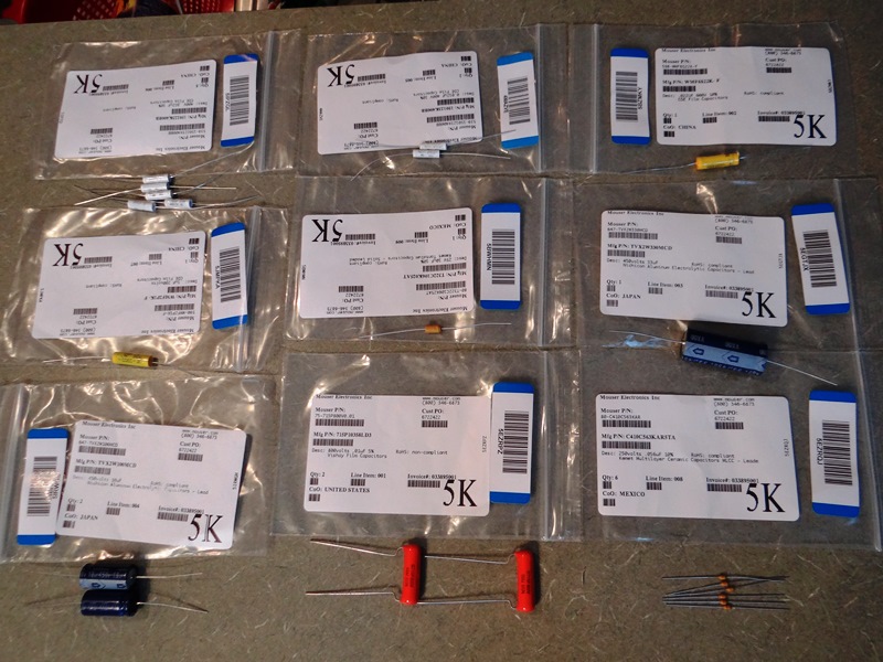

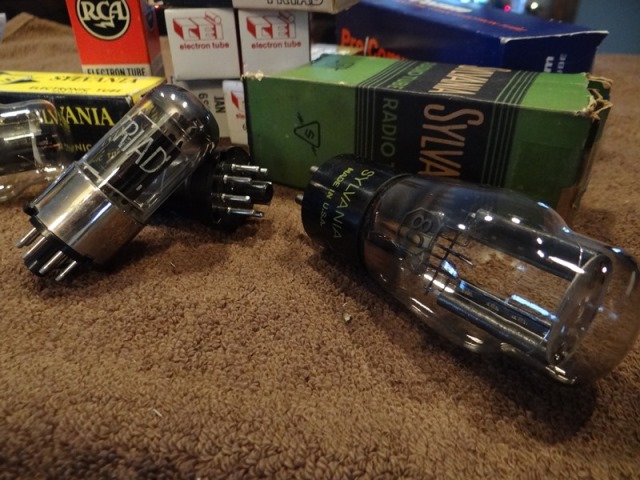

I’ve already ordered 77 new parts so far, including modern replacements for the ancient electrolytic and paper capacitors. I’ve ordered replacements for all 9 tubes, although many of the originals are still likely to be good. The tubes were inexpensive. The tube in the picture below is a full-wave rectifier. Even the 4 rubber feet are being replaced since the originals are as hard as a rock.

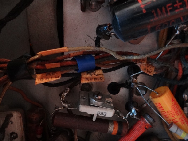

The wiring will be corrected to match the schematic using period-correct cloth-insulated solid wire. I’ve noticed tiny hand-written paper tags on many of the wires from the original owner. That adds a bit of charm, so I will retain those tags.

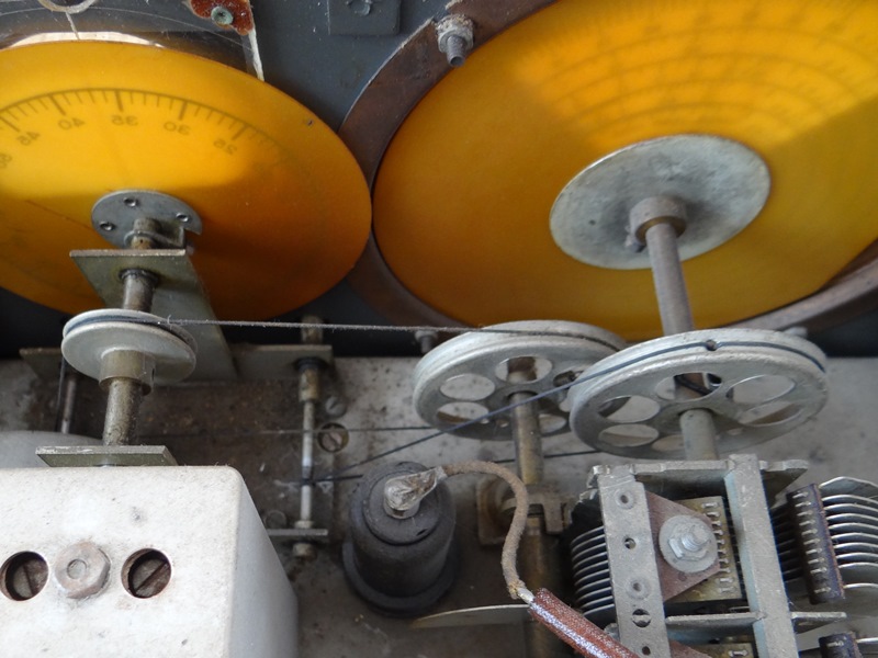

The chassis was quite dusty, so I removed as much dust as I could with compressed air. I’ll clean the chassis with a small brush, which will be tedious work. I’d like to avoid touching the dial cords and pulleys as much as possible. The dial faces are made of phenolic resin, which oxidizes and reacts to UV light, turning an orange-brown over time. I have cleaned the dial faces and will retain the originals.

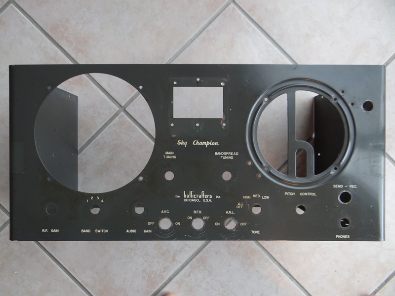

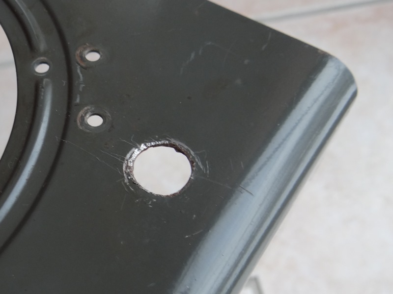

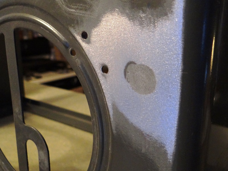

Ryan, I had to take it apart - most of the capacitors, and some of the resistors and tubes, were shot. Funny, just like old motorcycles, I'm learning that amateur radio guys often modified their radios, so I've encountered some customization. Since this radio was modified, it's no longer in original condition, so that frees me to fill the holes, re-paint the case, and apply reproduction lettering to restore the case to a near-original appearance.
I have hours of soldering work ahead of me, but I’m in no rush. I’m still waiting for the replacement tubes to arrive. To maintain the proper vintage appearance inside, I've ordered new cloth-insulated wiring to replace some broken or cut wires.

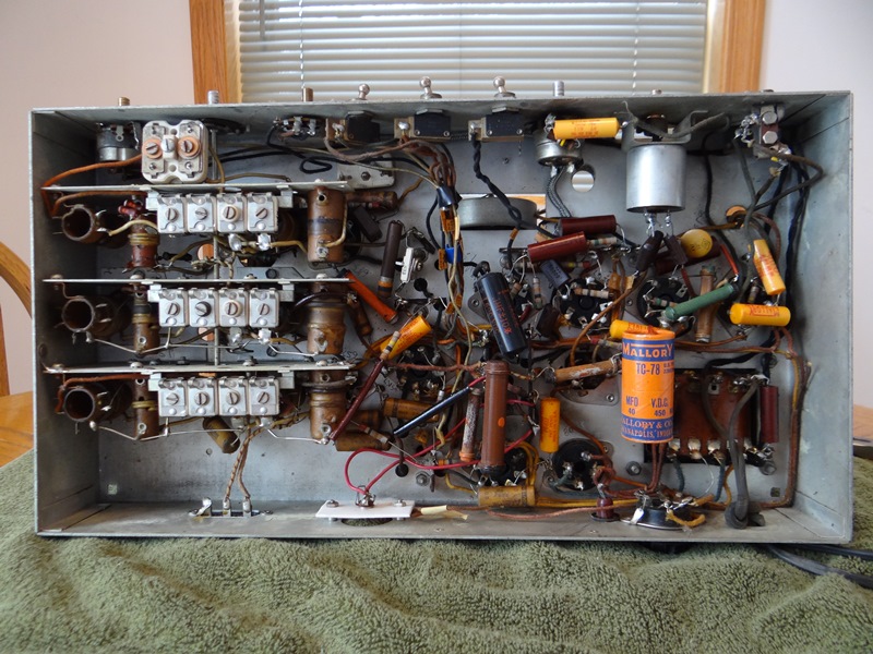

The chassis after an initial cleaning:
Filled a hole with JB Weld:

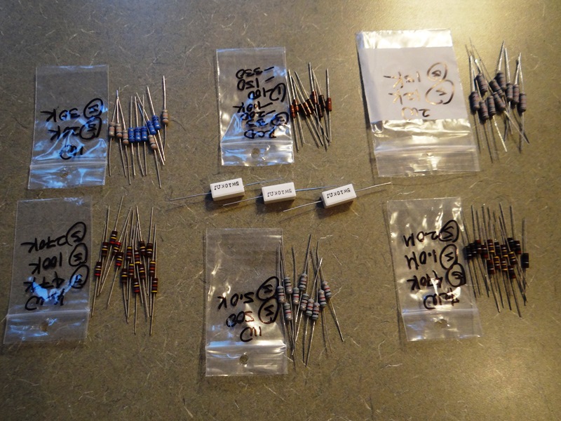

Replacement resistors:
Replacement capacitors:

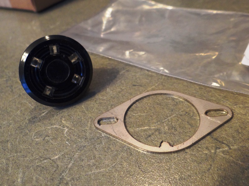

Replacement socket and retainer to restore rear of chassis to original condition:

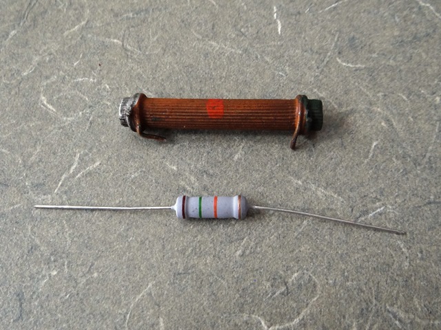

With Christmas behind me, I’m making some progress with the radio restoration project. I’ve replaced about 3/4 of the 73 year old components, but still have about 6 hours of wiring work left to do. Out of curiosity, I’ve tested each original component that I’ve removed to see how close to spec it is. Roughly half of the capacitors were no longer in spec, and most resistors were well out of the 20% tolerance margin. A few resistors had infinite resistance, so this radio would not have worked had I simply replaced the tubes.
I’ve also encountered parts that do not appear on the manufacturer’s schematic diagram. Judging from the solder joints, it’s clear that the radio was modified earlier. Considering the age of the extra parts, it was probably modified in the late 1940s or 1950s. Most of the non-original electronics are electrolytic capacitors, and based on where they were placed in the circuitry, I’m assuming that they were added to eliminate the “hum” that aging capacitors can cause with old radios, but that’s just a guess.

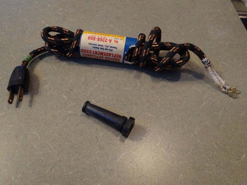

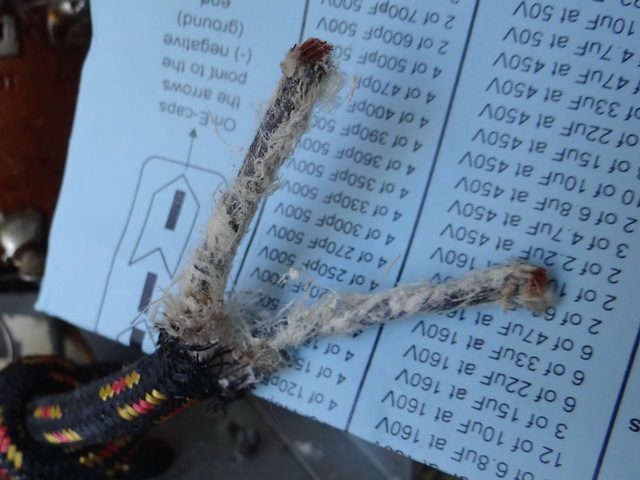

I wasn’t expecting a surprise from the vintage power cord, but as I removed some cloth insulation, it was clear that this cord was covered with felted asbestos. This was common in the old days for power cords that were used for devices that made a lot of heat or used a lot of power, such as irons. I disposed of any loose asbestos and cleaned the wiring.

These tubes have been tested and are ready for use.

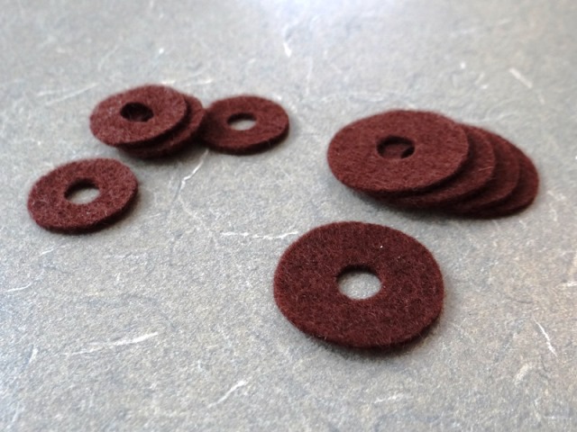

New felt washers will sit under each knob
Vintage power cord is wrapped with asbestos – wonderful

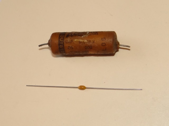

Original .05 mfd paper capacitor at top, with the replacement .056 mfd capacitor below

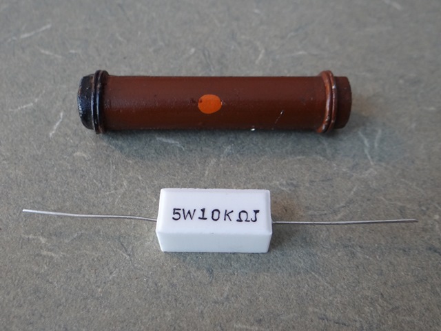

Original 10k ohm 3 watt resistor (top) with a replacement 10k ohm 5 watt resistor below

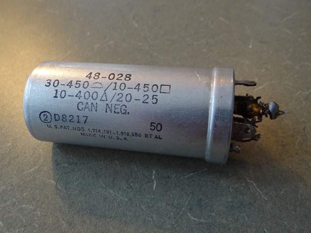

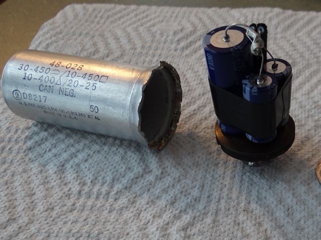

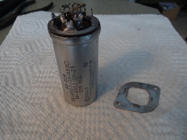

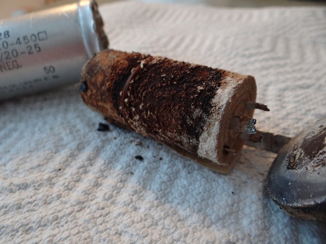

Today I repacked the large electrolytic filter capacitors. These are the 3 largest caps in the radio, and are packed into a single aluminum canister. The original specs are 30, 10 and 10 MFD, but currently test at 19, 10 and 0 MFD.
There are typically 2 options to replace these caps. First, I could simply disconnect this cap below the chassis and leave it in place, wiring in new separate capacitors below the chassis. A popular alternative is to disassemble the canister, discard the original guts, and repack it with separate electrolytic caps.

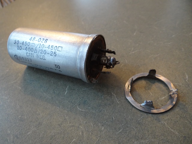

I decided to repack the capacitor for a number of reasons, but mainly because I wanted to avoid crowding parts together below the chassis, leaving me more room to work. I cut away the crimp at the bottom of the canister with a table grinder. The guts were as expected - thin layers of aluminum wrapped in paper that was at one time soaked in an electrolyte. The cap appeared to have signs of burning, perhaps explaining why one of the 3 showed infinite resistance.
Once the original wrapping was discarded, I cleaned the canister and bottom, drilling holes to allow the new leads to be soldered to the legs. Since I had axial capacitors, I routed a heavy wire from the negative terminal to the top to allow the 3 capacitors negative wires to be soldered together. The original caps shared a common ground too. The new caps fit snugly in the can, and it was sealed back together with silicone. The new cap tests good on all 3 leads now. When the silicone hardens, I'll remount the cap to the chassis and connect it back to the circuitry.
Electrolytic capacitor (3-way) before disassembly:
The canister crimp is ground away:
Original wrapped aluminum and paper interior:
New electrolytic capacitors are mounted on the base:
Capacitor is closed and sealed with silicone:
