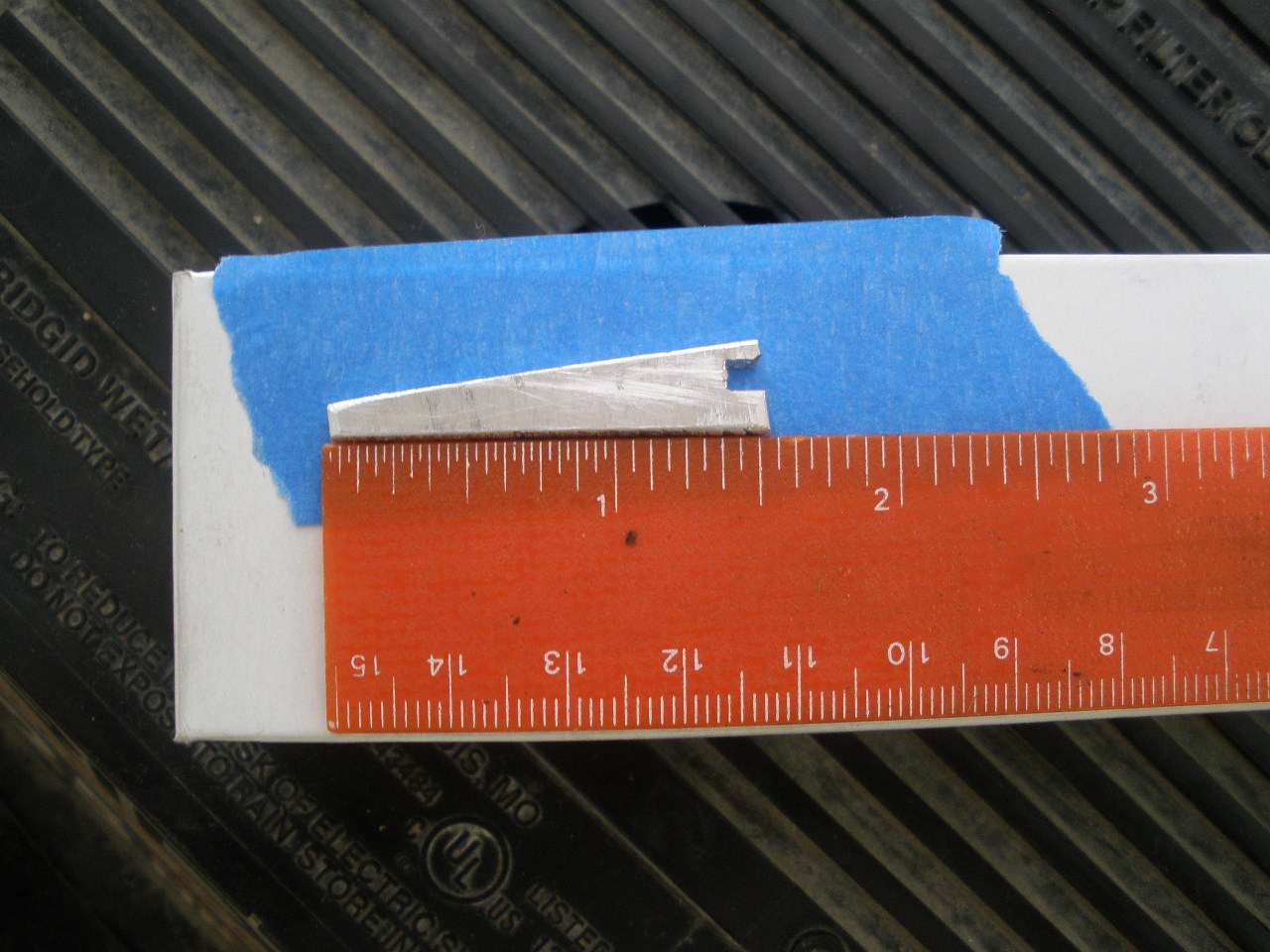

Here's a pic of a tool I made to adjust the valves with . As you can see in the photo it's just a piece of scrap aluminum with a slot (3-32nds) . Works fine just fine although I may cut a second slot on the side to have 2 ways to access the adjuster screw .
