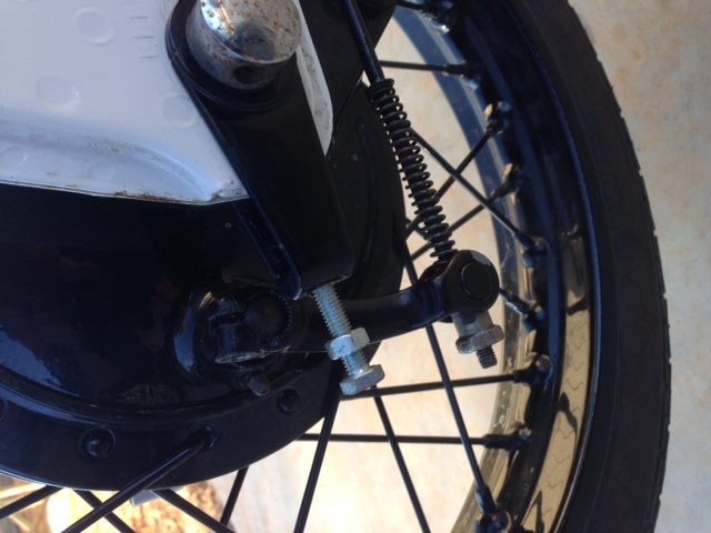

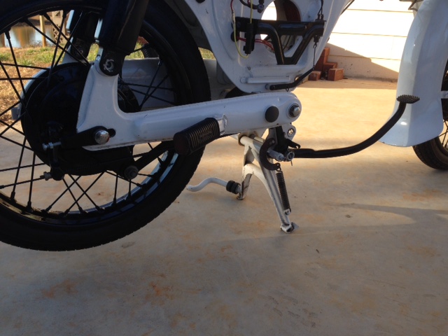

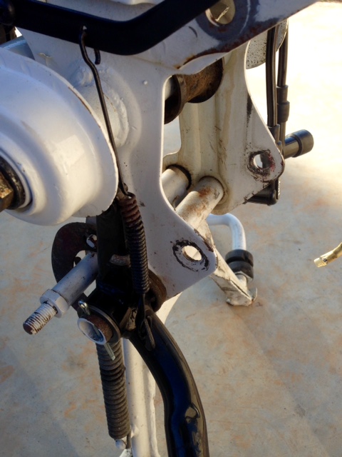

Mine is 490mm from the adjust end to the pin. I get full travel of the arm, just no braking until I pull the arm to where it would bend the rod. If I move it up on the splines it will brake correctly but arm pressure in the hub pulls back on the pedal so that it is extremely high up. This is in the configuration where there is no brake through full movement of the pedal. You can see wit just a little movement the pedal bends the switch spring. I'm wondering now if I have the correct pedal. The pedal connector has a pin going through it with a cotter key. Looks correct per the diagrams. I'll post some pictures in another post from my desktop.

The passenger foot peg should flex up and down, not left and right :-)
Unread 11-28-2014, 06:10 PM
You have the wrong brake pedal. The stop light spring does not bend around the swing arm post. It is likely the brake rod is wrong as well. I would double check the brake shoes and mechanism in the rear hub as well.

Well it looks like my pedal and Rod are the same as those listed on eBay. I don't see any difference in what I have. The spring isn't binding on the swing arm pivot. It binds against the brake pedal itself where the Rod connects. I was depressing the pedal slightly in the photo to demonstrate where it was binding (probably should have said that). I'll take the hub apart and see what's going on in there.

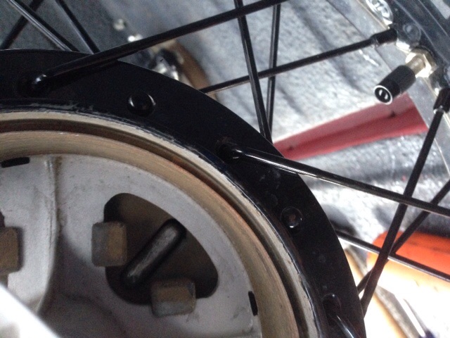

Turns out my pads were almost gone causing too much travel for the pedal. I'm going to order some new Bangkok ones and try those. Also my drum looks thin but I don't have a way to measure a diameter that large to check the book spec. How does this one compare to yours?
