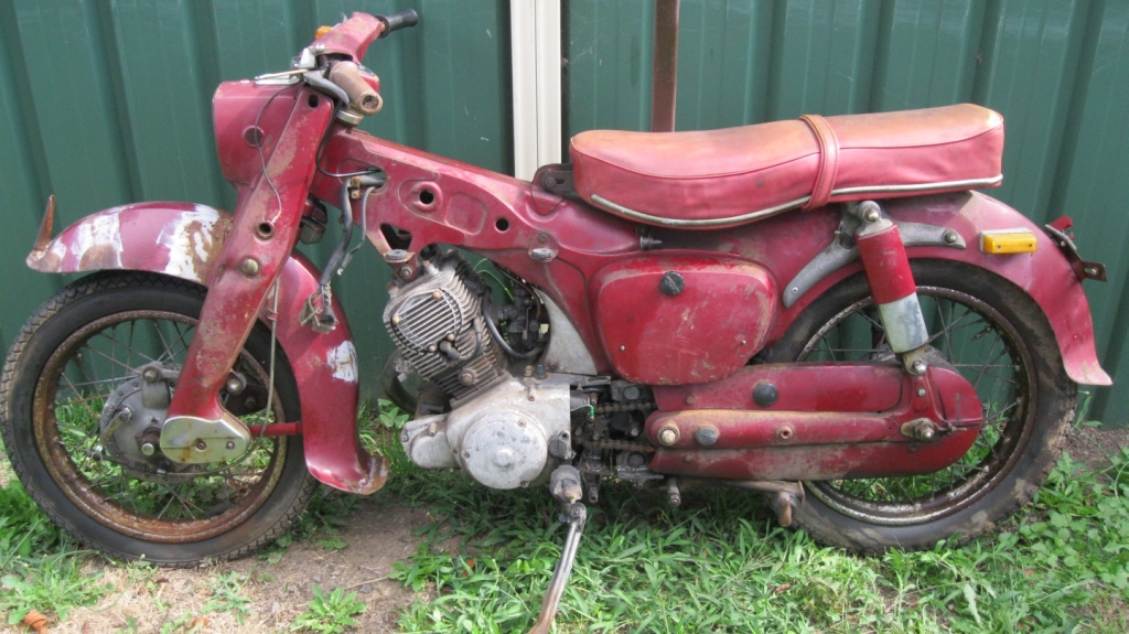

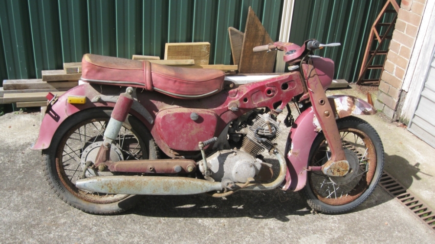

hi and thanks for replying once again....
the bike is as is and as it stands.
i havent done a thing to it so far, except remove the air pump that sits under the seat on the left hand side, which i still have.
as one can see its in need of restoring and i am debating within myself whether i should take this up or not....i have been told these early models a worth a bit, but thats all i know about it.....

Thanks for sharing the pictures. That certainly is an old one. If that's the original seat, I'm amazed at the condition. Looks like the speedometer is still there ... how many miles?
Anything can be made to run again, given sufficient resources. I can't comment on the value of a '59 C92 in Australia. The obvious parts needed are a fuel tank with the chrome panels, badges and a petcock, headlight, ignition switch, drive chain cover, new wheel rims and spokes, new tires, new foot peg rubber, and likely 4 new cables.
The little parts will add up quickly. Engine and hub seals, possibly bearings, gasket kit, new chain & sprocket(s), brake shoes, mirrors, carburetor rebuild kit, fuel lines, clutch friction plates, and anything the engine may need, such as pistons & rings, valves, etc.
If you're serious about a restoration, you'll also likely have the engine rebuilt and the red parts painted, given that the front fender will need painting anyway. Given my experiences, I'd guess $2000-$2500 USD in parts ($1860 - $2330 AUD). These projects are typically done for the passion of the bike, not the resale value afterward.

Hi Met, welcome,
On the bright side you have a couple of the hardest parts to get. The handlebars assembly and the chain guard! Very lucky to have those. That sucker IS an early model . That is one that needs to be restored correctly by someone who really wants to preserve that model. You don't see those ever. I'm sure it would be worth twice what the later models are worth because it has a lot of the oolllld Honda attributes. The only problem is that the regular later models aren't worth all that much to begin with. But at least yours is worth more!
If I had it... I would do it for sure but not to sell. The front fender is also looking nice. That would be an easier restoration but yes, every single little thing will take your quality time to refinish and every single part you will need will cost money and add up quickly.
I like it.

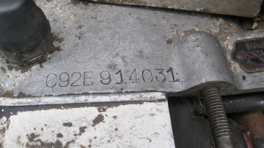

After struggling for a bit trying to research your bike, I did find this information from Bill Silver that appears to confirm that you have a 1959 model. I can't find the actual number range, though. Even the parts fiche seems to omit the C92E-9xxxxx range.

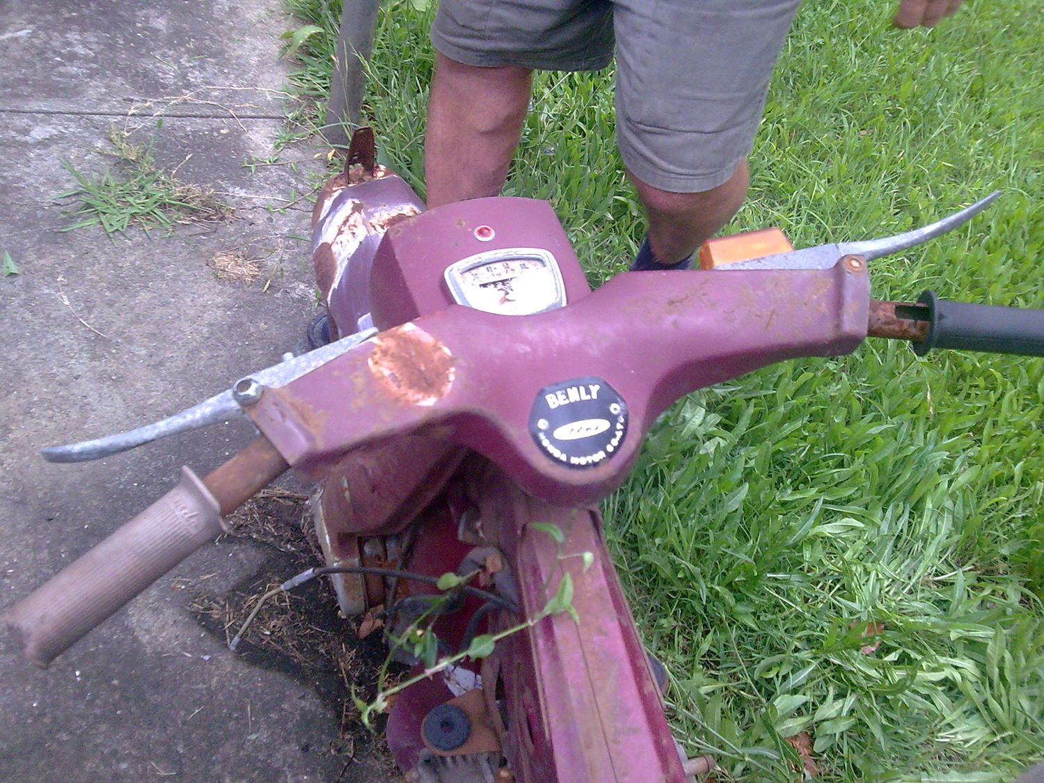

yeah thanks smithers.
the bike is actually a honda benley.
it has a black half round tag as shown on new photo posted,
which denotes it as so......
from my research i have been told its a 1959, c92.
they tell me the early models such as this one, had a bare chrome finished tank as picture provided by club member. thank you "by the lake".
the later ones apparently had the rubber side grips to the tank.
this one also came with an air pump that sits on a two piece lock stand under the seat to the left hand side.
this wasnt present in ther later models.....im told.

Handlebar reminds me of my Super Cub's handlebar. Love that Benly badge in the center.
Is the switch gear missing on each side? I'm assuming that the switches would have been in the gaps next to the hand grips.
Should be an interesting project for sure.

yeah both switchgear's are missing....and just another two items on the impossible to find list.
they are also another two reasons against the undertaking of this project....
and yes they do fill in the gaps next to the handles....
