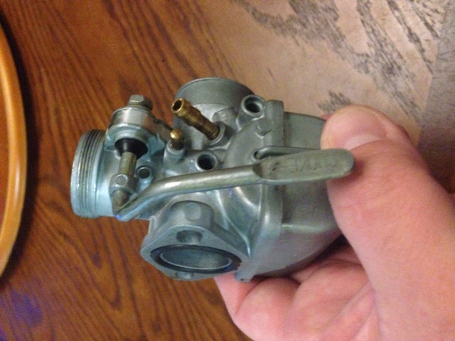

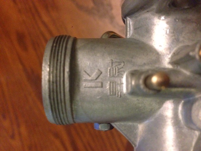

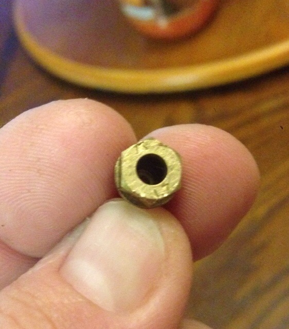

I'm talking about the float valve and seat. The valves are all the same but the seats have different size openings (in mm) typically 1.5, 2, 2.5, 3. From what I gather, you aim for the smallest size that doesn't starve the bowl at extended WOT with your jetting. If it's too small, it will cut out near top speed as the bowl goes dry. On my ski carbs you adjust needle seats and springs for pop off pressures. Of course these are a lot more simple than that. So I think the seat size is just determined by WOT fuel requirements. If it falls on its face after a bit at WOT, go up a seat size.
The "k" on the newer looking carb doesnt look like the keihin starred "k" and it doesn't say keihin like the other pw20. Maybe you can identify the manufacturer/model. None of the jets are marked in this one either. Here are pictures. I may have to post each separate as my iPhone does weird stuff on the multiple picture uploader.

Needle seat

K carb 2

I did some research and posted this to facebooks vintage Japanese bike group. It's a Sheng Wey chinese carb. So, I will definitely be using the genuine keihin.
