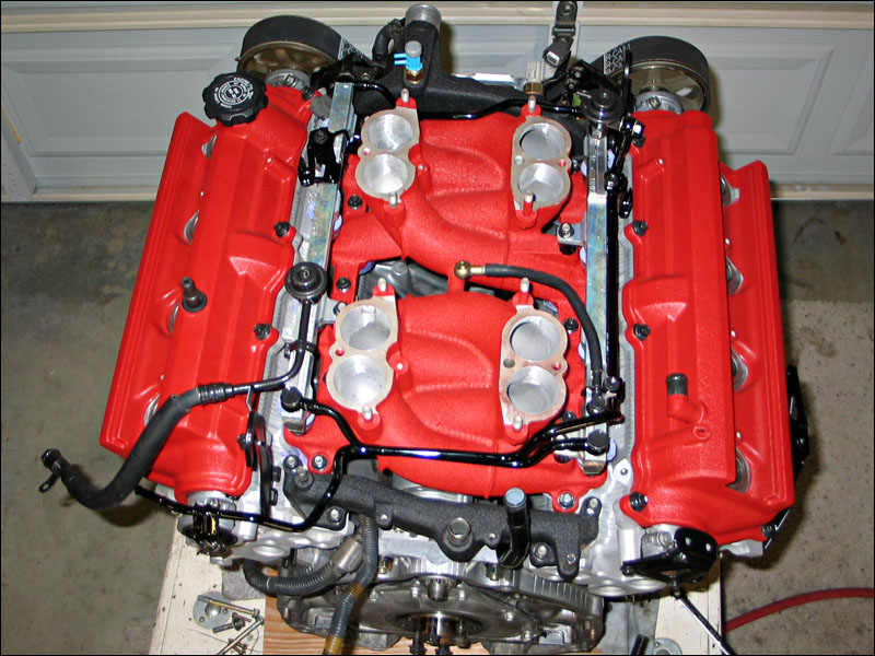

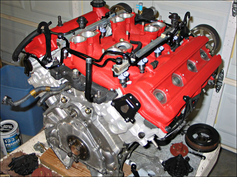

SO YES July is a good month so far for the Toyota Tacoma 1UZ-FE
  • Custom heads are torqued down
  • Cams are in
  • New starter is in position
  • Balanced injectors are secure under the fuel rail
  • All rubber seals, o-rings and gaskets are new
  • Water pump is brand new
  • Pulleys are all new
  • All the hardware is P-coated or painted
  • Wiring is cleaned and conditioned
  • New timing belt is in place with new tensioner
  • Adaptronic ECU and new wiring harness is on standby for installation
  • Innovate wideband O2 controller is ready for tuning
  • Basically everything is new except the oil pump which Mr. Lextreme is warning me about but I do not want to take the whole engine apart AGAIN to put in a new one plus I have a whole extra engine so I'm covered =]
Things are looking good!

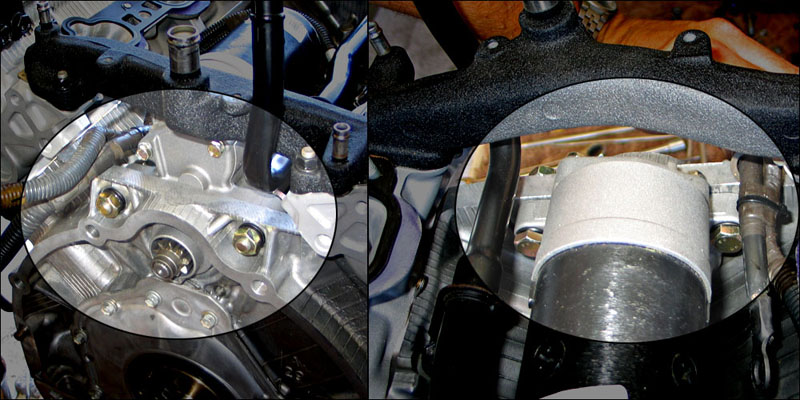

I am waiting for paint to dry on a few nuts and bolts. Tomorrow the rest of the covers and belt components will be assembled. David over at Lextreme.com recommended this starter bolt modification which I thought was a great idea. Read about this over here:--> Lexus LS400 Starter Change Modification <--
