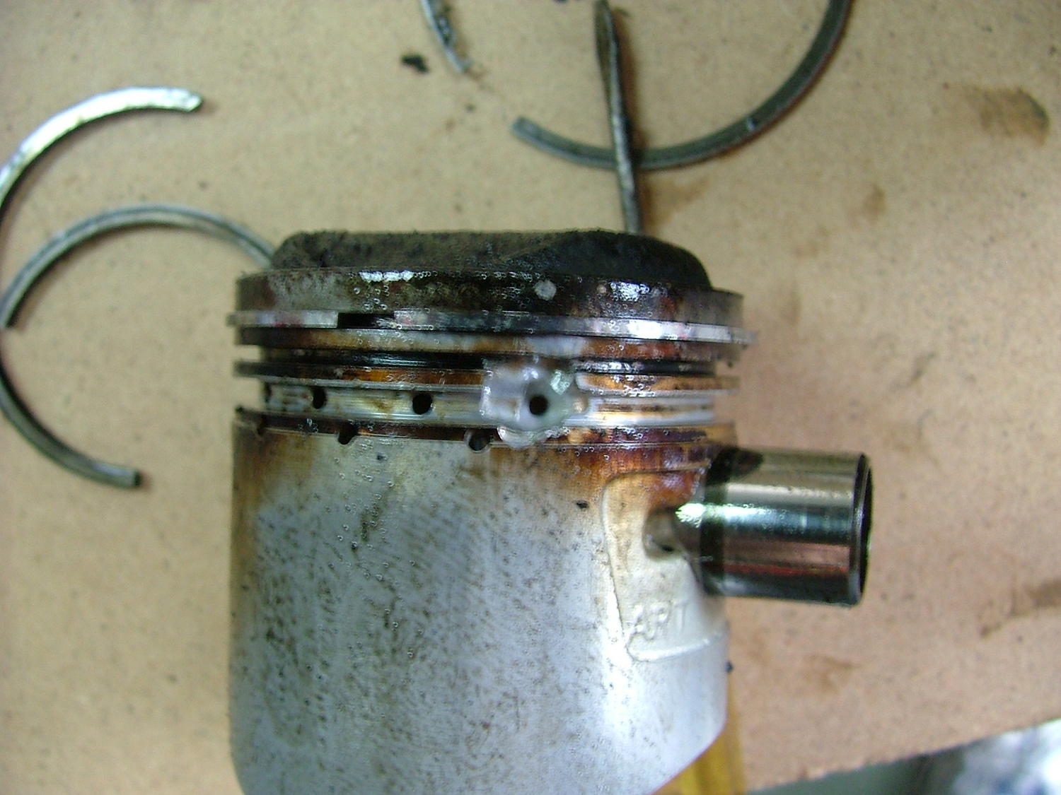

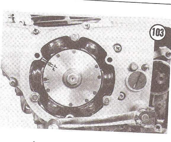

Anyway, the timing marks, in this case the T = TDC and the F= Fire or breaker points opening, on the flywheel should line up with the pointer when the pistons are at the top of the stroke. Normally the points are set to open just briefly prior to TDC. If the cylinder head cover is off, and you are at or near TDC (T on the flywheel) for the left cylinder, the timing mark on the cam gear should be at the 12 O'clock position. It's often lightly stamped and may be difficult to spot but is a large "0". If the points breaker plate and advance mechanism are removed the drive pin for the advance mechanism should be pointed at the 6 O'clock position (contrary to some manuals).
Valve adjustments should be made only when the engine is cold, with cam chain adjusted and I usually tend to set them a bit loose. I think the book calls for .002" for both intake and exhaust and I am ok at .003.-005", especially for new engines.
Speaking of... I have found that when some of these engines get revived often times they smoke and sometimes continually. I believe that as time goes along folks "turn over the engine" or force stuck and stiff engines. As fragile as rings are they are easily broken as I found on my red CA.
The best test is a leakdown compression test, then/or a regular compression test. It should tell you if you have ring or valve problem. In either case you'll be pulling the top end down if you have a problem.

I should have looked at the timing before I posted. I figured it out basically like you described only as little different. At some point after several revolutions, the "T" mark lined up with the mark on the stator cover, the drive pin for the spark advance was at 12:00, the "0" on the cam shaft at 6:00 and the master link for the cam chain was sitting at 12:00 for easy removal. Can't believe it was that easy.

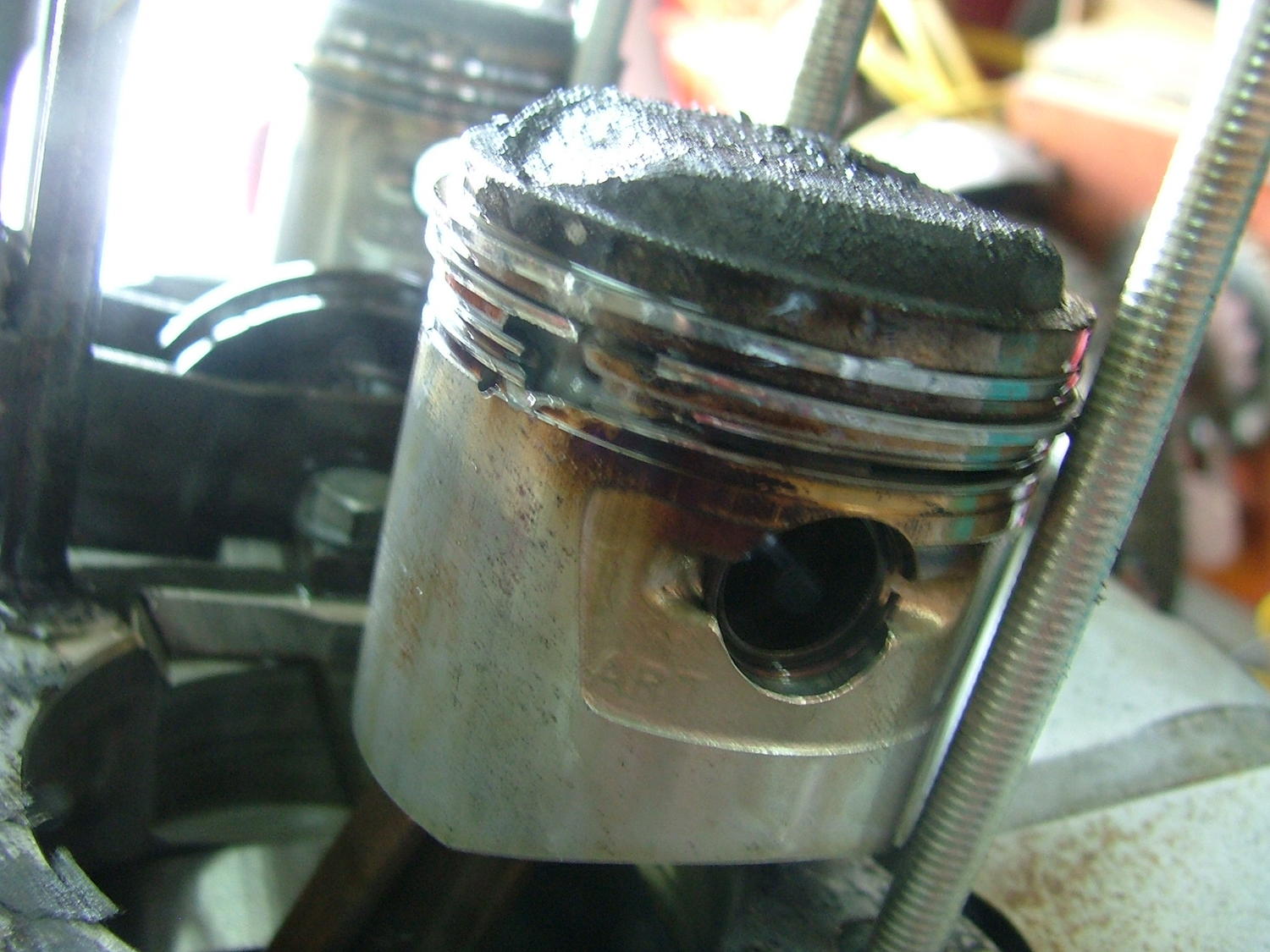

Anyway, cylinders looked pretty good, only some very light scratches, valves looked good. The rings were OK but the pistons definitely had brown blow by on the sides. Similar to the browning in the picture you sent, only worse.
I took off the top ring on each piston and set then in their corresponding cylinders about an 1" down from the top. If sitting on the bike, the end gap in the ring on the right side is .020" and the left is .021". I think they have reached end of life. I will have my machinist check the piston and cylinders, but I think I have to go to the next size pistons and rings.

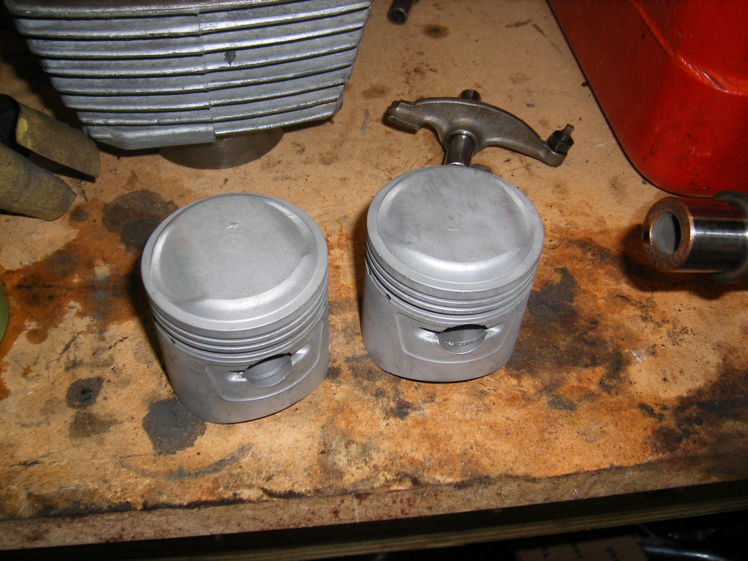

One last thing, if standing in front of the motor (exhaust side)with the pistons still in place, I noticed markings on the intake side of the pistons as"IN" or they would read "NI" if standing at the back of the engine (intake side). Is this correct?

Do make note of the piston orientation if retaining the pistons. On the stock pistons you might find an arrow, meant to face forward, like in the pic. You didn't report the bore size so you may have an overbore already.
On some of my rebuilds I don't mind building the engine a little loose, as I mostly never intend to use the engine hard. While a 20 thou end gap is a lot (book calls out .029 as the limit), I usually don't come as close to the 6 thou my book calls for. I think my last motor was at about .008"-.010". Remember even if you just hone or break the glaze the gap will increase so you may be looking at up sizing or just finding a suitable cylinder set.
I don't know if you could get away with the next size ring and adjust the gap allowing you to the keep the pistons.
Regarding the piston marking, it is my understanding that there is indeed a piston pin offset that necessitates the marking.

I only have an "old school" set of vernier calipers without the dial. My eye sight isn't what it used to be but the skirt of the pistons measure at 1.968" or 50mm. By a little research, it seems that 50mm is standard size. I can't get an accurate reading on the cylinders.
There aren't any markings on the pistons except for the (NI) or (IN), depending which way you are looking at them, that I am assuming is the intake side. No arrows... nothing like STD for standard or 0.25 for 1st over etc. Would be nice to know the measurements. If standard is 1.968, 1st over should be very close to 2.218?

Honda may have used different vendors for their piston castings. With the numbers you are initially looking at I believe you might get away with a ring job and no oversize. On the other hand if it's apart and you have the means go oversize. Std size rings are harder to find anyway.
